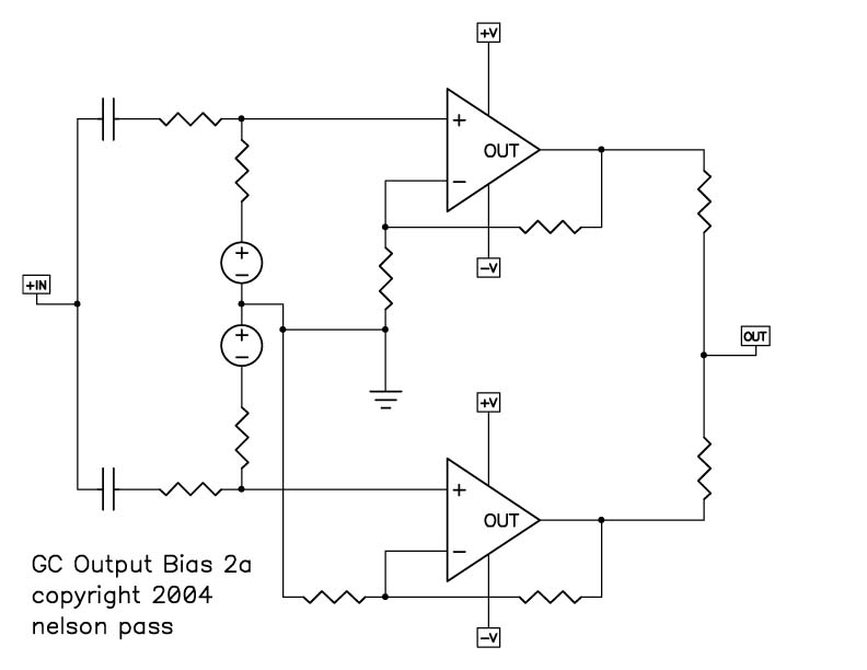

Here we see the same thing as GC-SS-3a, but without the
SuperSymmetry jazz, just a pair of chip amps. The voltage
sources will be low values, as will the output resistors,
and additional output stage is provided by the DC difference
in the output voltages across those output resistors. The
load output sees the split value, so there's no DC seen there.
You also get the advantage of delivering about twice the
current as a single chip amp.

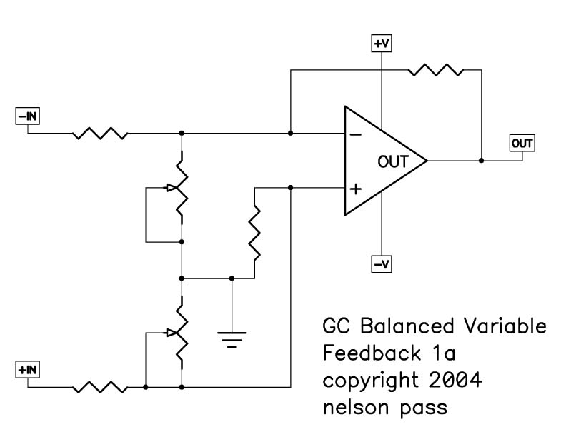

Does the same thing for a balanced input circuit. Generally
you want the pots at equal value, but for the most perfect
common mode input rejection, separate pots allow trimming.

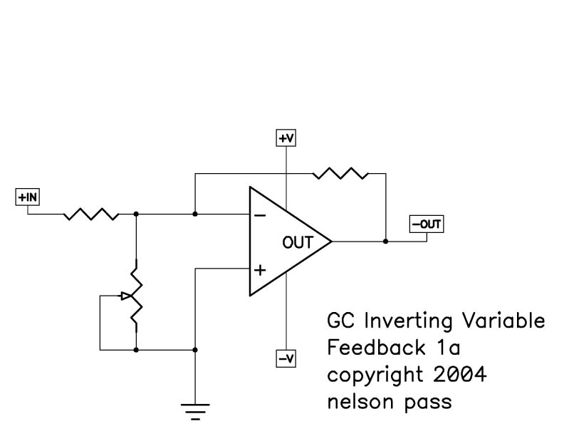

You might find this a trivial circuit, but for those who
don't know it, it can be very important. Chip amplifiers
have enormous amounts of open loop gain (120 dB = 1,000,000)
which can create stability problems when the circuit is set
for low gain, say only 10 or 20 dB. This circuit places a
resistor to ground at the negative input, which throws away
some of the open loop gain, resulting in less feedback. In
fact you can put a variable resistor here, and tune the
amount of feedback to taste.

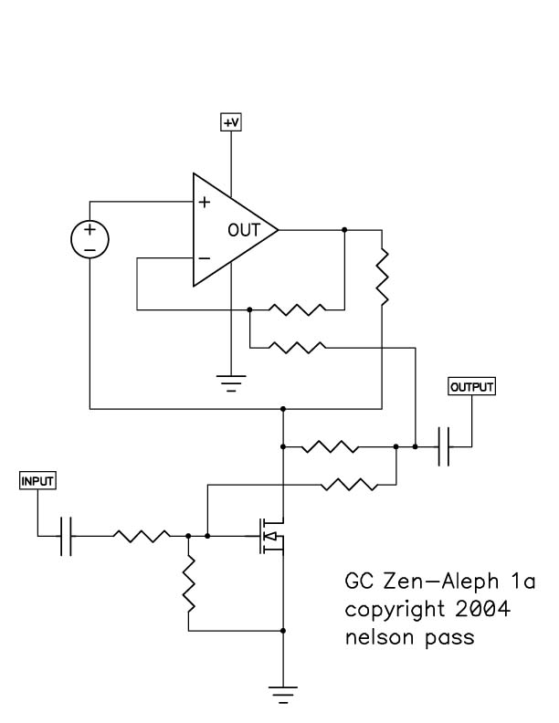

How can we resist not making a Zen amp with such a current
source? Here we see that the Aleph current source is easily
duplicated by a chip amp.

Good circuit but incorrect math
The addition of the resistor does not effect the open loop gain
but changes a parameter referred to elsewhere as the noise gain.
This is the closed loop gain between the + input and output. It seems
counter-intuitive but since the - input is a virtual earth a resistor
between - and ground passes no current and thus does not effect
the input stage in any way (other than if the value is reduced to values
close to zero).
I realize almost everybody finds this highly counter-intuitive
and, as I post this, I doubt even my own certainty. A better mind
than mine might be able to work out the effect of the resistor on
frequency response and distortion.

It does not alter the open loop gain of the amplifier, it only makes some of
that gain unavailable for negative feedback. And of course it raises the
distortion and noise figure in proportion to the amount "thrown away".
