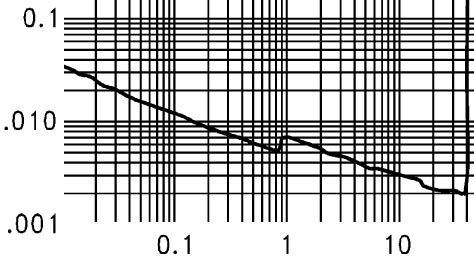

In the spirit of improving even chip amplifiers, I offer this
Eighth Easy Piece for you LM3886 users:
I have noticed that in the distortion curves, there is a little
glitch down at about 1 watt, and that this is a voltage related
glitch, not a current related one (it occurs at twice the wattage
with 4 ohms) and it is consistent.

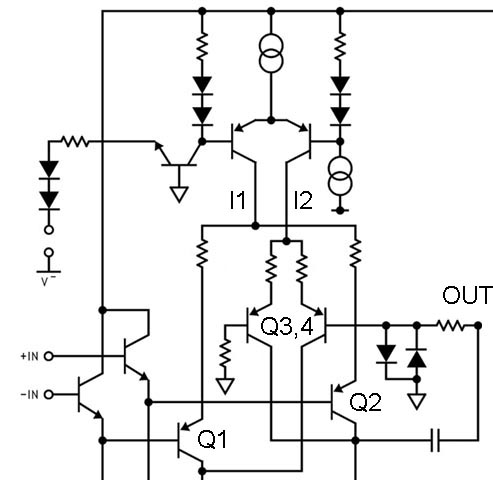

Studying the circuit (or in this case a small section) we can
see the probable cause.
Neglecting the input buffer transistors, the amplifier has two
differential pairs taking feedback. The first, Q1 and Q2 are the
actual signal bearing transistors. Q3 and Q4 form a secondary
pair which does not process input signal (their + input is
grounded) but takes unity gain signal from the output, limited
by a pair of diodes.
When the current is run through the mute pin, Q1,2 are biased
up and Q3,4 are starved for current, so Q1,2 dominate the
performance and everything is normal. When you mute the
amplifier, the current is shifted to Q3,4 and the amplifier goes
into unity gain with a shorted input.
The transition is dependent on the amount of current going
through the mute pin. The spec sheet suggests 500 uA as the
appropriate value, and apparently the distortion curve above
reflects that. But another curve shows the significant sharing
of current between these diff pairs at half this value, and I
suggest that the glitch at 1 watt is an artifact of the incomplete
shutoff of Q3,4 and the diode nonlinearities in that unity gain
loop.
I recommend that you explore higher mute currents at greater
than 1 mA to provide more shutoff to Q3,4 during operation so
as to lower the distortion in the 1 watt region.
The LM3875 does not have this circuit, but the LM3876 does,
and is interesting to note that the mfr's curves do not show this
artifact, although it may be partially obscured by the higher
general THD level in this chip at 1 watt.

Excellent work, as always Nelson. Thanks. It just shows what you can achieve by reading datasheets properly, a lesson to us all.
Thanks Nelson. I noticed the same effect by accident a while back, but I couldn't figure out why it was happening. I find tha 1mA on the mute pin isn't quite enough, and have been using about 3mA finding that it consistently provides a benefit. Now that it has been explained I feel better now that I know I wasn't just deluding myself.
Cheers, Terry
Cheers, Terry
Very interesting.....
Not beeing a shark at math, I tried to calculate the current going through the mute resistor. The mute resistor is connected to the negative rail and output, and I thus count the output as a 0 volt reference - thus, the voltage over the resistor is equal to the negative rail voltage - in my case -33.2 volts, and using a 10K mute resistor - this gives 0,00332 amps.
I notice that other layouts uses higher values like 38K - which gives current values under 1 mA.
Cheers !
Buhl
Cheers !
Buhl
Excuse me Nelson, but isn't it a change of measurement range of the test equipment?Nelson Pass said:In the spirit of improving even chip amplifiers, I offer this
That's a possibility, although you note that the glitch occurs
at a specific output voltage (1 watt into 8 ohms) and my AP
doesn't do that. A quick thumbnail calculation shows that you
expect the "mute" differential pair to switch in approximately
this region if its bias has not been shut off.
Of course you can always test the proposition by measuring
an actual unit and varying the mute current...
