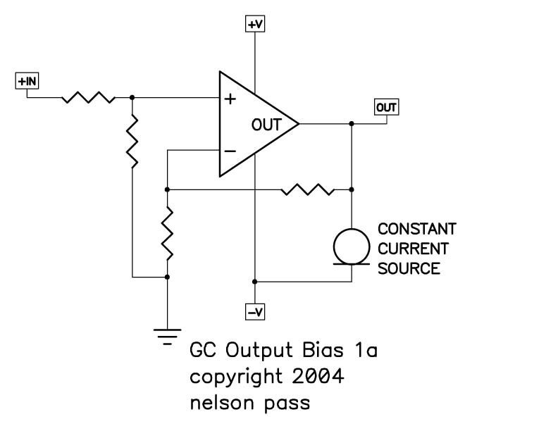

www.passlabs.com/np/GC-OUTPUT-BIAS-1a.pdf
You say your chip amp needs more output bias? Here's an old
trick.

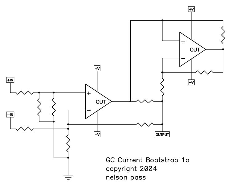

www.passlabs.com/np/GC-BOOTSTRAP-1a.pdf
What? You want your chip amp to behave as if it's seeing a
higher impedance and also deliver more current? You can
parallel chip amps equally, or you can set one up as a
current bootstrap, relieving the load on the first amp,
but also leaving it in control of the signal. Sort of
like power steering. Watch how you set the current gain
of the bootstrap. For this circuit, 50% is a good number.

It looks like the links are broken. Here is a series of 7 images:
