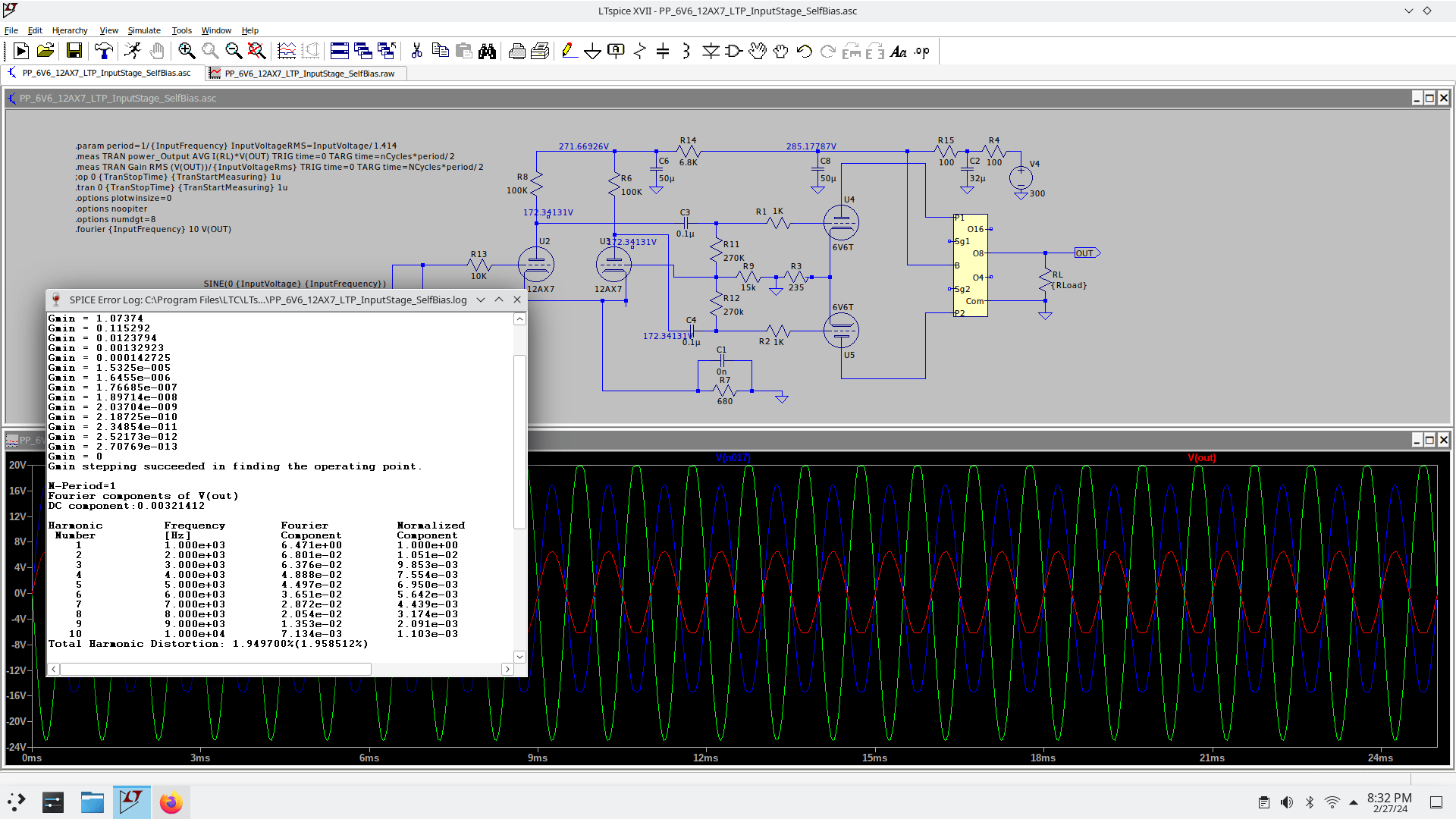

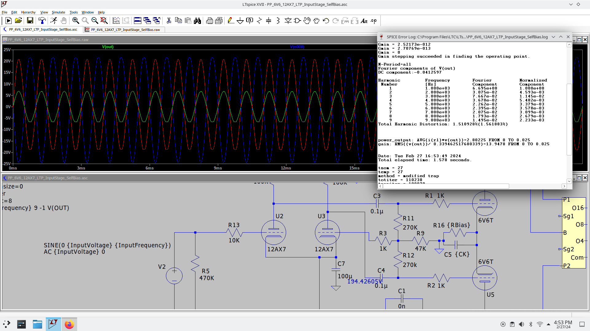

Maybe it's a little advanced for me, what kind of resistor should I put in the cathode of the 6v6?It would be then interesting, considering the 2nd harmonic behaviour of this PP amp, to implement what Keibert proposed in 1954 to reduce 3rd harmonic ( https://www.one-electron.com/Archiv...System Design Factors for Audio Ampifiers.pdf ) by adding a 1/gm resistor from cathode of the output tubes to ground.
In the image you can see the output and the 2 signals before reaching the 6v6 grid, this is eliminating the 100ohm common cathode resistance of the 12ax7, as you can see, the thd is 1.5%, nothing serious i guess
more details
original Schematic showing FFT
Without cathode-common resistor
and with the 300k (replacing270k)
I'm still testing in LTSPICE before taking it to the real thing, maybe it will give me an idea of how it will behave, although it's obviously not exact.
Thanks to you! I still remember the first time you helped me years ago and all the effort you put in explaining where I was wrong. Very useful information!zintolo,

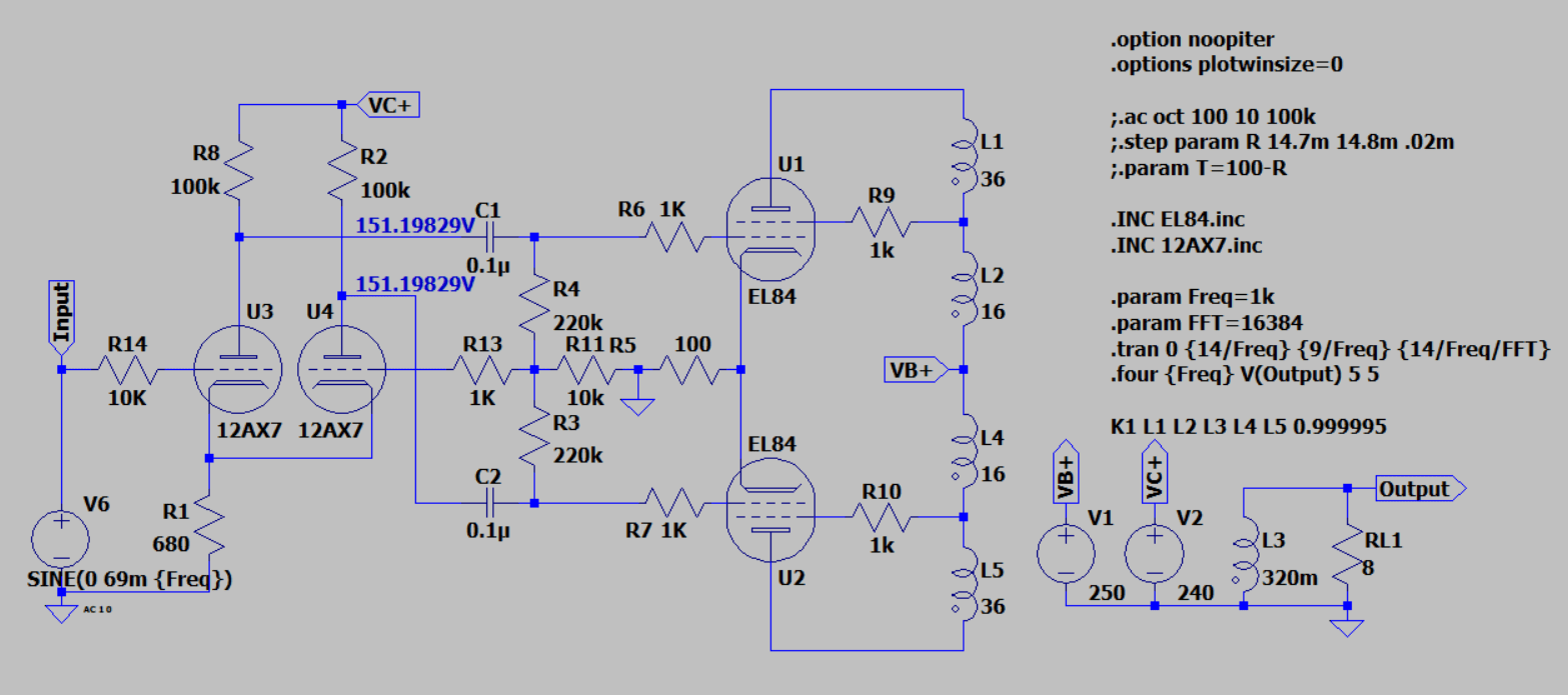

there's no need for the cathode bias cap?? (CK in my squematic)
i dont have the same results as you
No, but there's an issue with 6V6: they are designed to work in A2/AB2:
staying in A1 like this design wants, you cannot go above 4 Wrms, because anodes can't go lower than 180V.
EL84 would make it a totally different amplifier, with enough power for anything you may need, specially with something like 20-40% UL, while keeping the same harmonic signature. Having octal connections 7591 can be another option too at 40% UL instead of triode.
Something like this (playing with R5 (your R9) will give 7 Wrms at 2% THD still in class A and less than 0,2% THD at 1 Wrms:

I am not sure what is going on.
The results are not what I expected with the modification of the original schematic, but with the 100 Ohm resistor removed, and the cathodes connected together.
The 680 Ohm without any bypass capacitor is a poor man's differential that is combined with a paraphase splitter.
Probably not a good combination.
Time for me to think some more, and see if I can understand all the recent posts.
hahaha me neitherI am not sure what is going on.

I just noticed that with this design we can't go over 4 Wrms due to how the curves of the 6V6.I am not sure what is going on.
I switched to EL84 (or 7951, being octal) in UL to have linearity, low rp and double the power.
It is indeed, but this design has the purpose to have 2nd harmonic.The 680 Ohm without any bypass capacitor is a poor man's differential that is combined with a paraphase splitter.
By design is 1 kOhm, that I lowered to 680 Ohm.
yes, and switched to EL84 or 7951 because they can give much more power in A1/AB1 and, from previous experience, they have very good rp at 40% UL compared to 6V6 in triode.@zintolo has gone back to UL from triode strapped, hence there is more output power on tap.

I opted for your solution, 6A3sUMMER.
The voltages became even, I couldn't get a 300k resistor, so I put the closest thing on my market, 330k.
Unfortunately I cannot get higher quality OPT in my country to see that improvement that you talk so much about, maybe on some trip I will get something.
I've been listening to music and I still haven't noticed much difference, maybe a little more bass. I attach a final image, maybe it will help someone, the harmonics that are seen are ok, I see that the 2nd harmonic passed to the 3rd harmonic, Without the modifications, the 3rd harmonic was superior to the second
