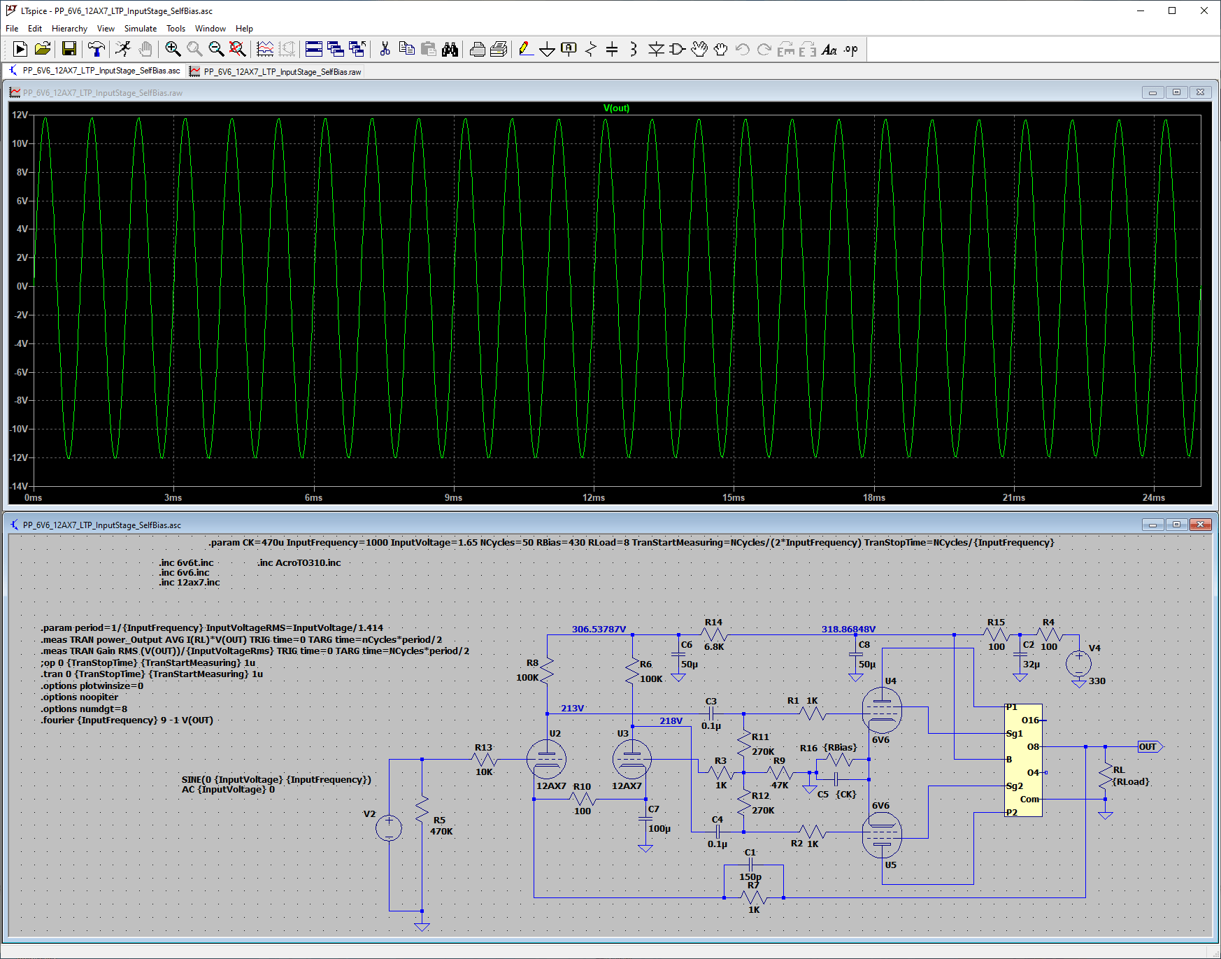

what if I want to compare it with 6v6 in ul mode? What subctk and model can I use?(i use ayumi also) I tried some but they gave me ridiculous output power or THD values.

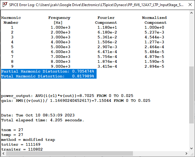

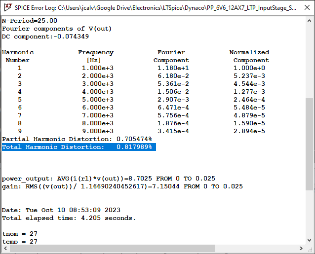

For UL I just used the Ayumi 6V6 tetrode model, that's it. THD is not brilliant, but reasonable. Again, this is just a simulation.jcalvarez,

1. Your schematic has an error.
The output of the parallel RC network C3 R7, from the output transformer secondary is shorted to ground by the 100uF cap, C7.
So, there is no negative feedback.
Either C7 belongs on the other 12AX7 cathode to ground,
Or
C3 R7 needs to connect to the other 12AX7 to ground. **
One of the above will result in Positive feedback, I think that is **, but that depends on how the output tube screens and plates are connected to the output transformer windings; and how the secondary connections are properly or improperly phased.
Check the schematic in Post # 24. The global negative feedback connection seems to be correct.
Once you fix that, you may see a difference in the results of the simulation (this time with, and without global negative feedback, when you connect C3 R7, and when you disconnect C3 and R7).

I corrected the error but it still doesn't work, I'm making something else wrong.

Good catch. I looked at the screenshot, but missed that.Thanks, but I found the error, I was placing the bottom 6v6 valve backwards, reversing the grids.
Thanks anyway, now I can play a little, even though I don't have an oscilloscope.
