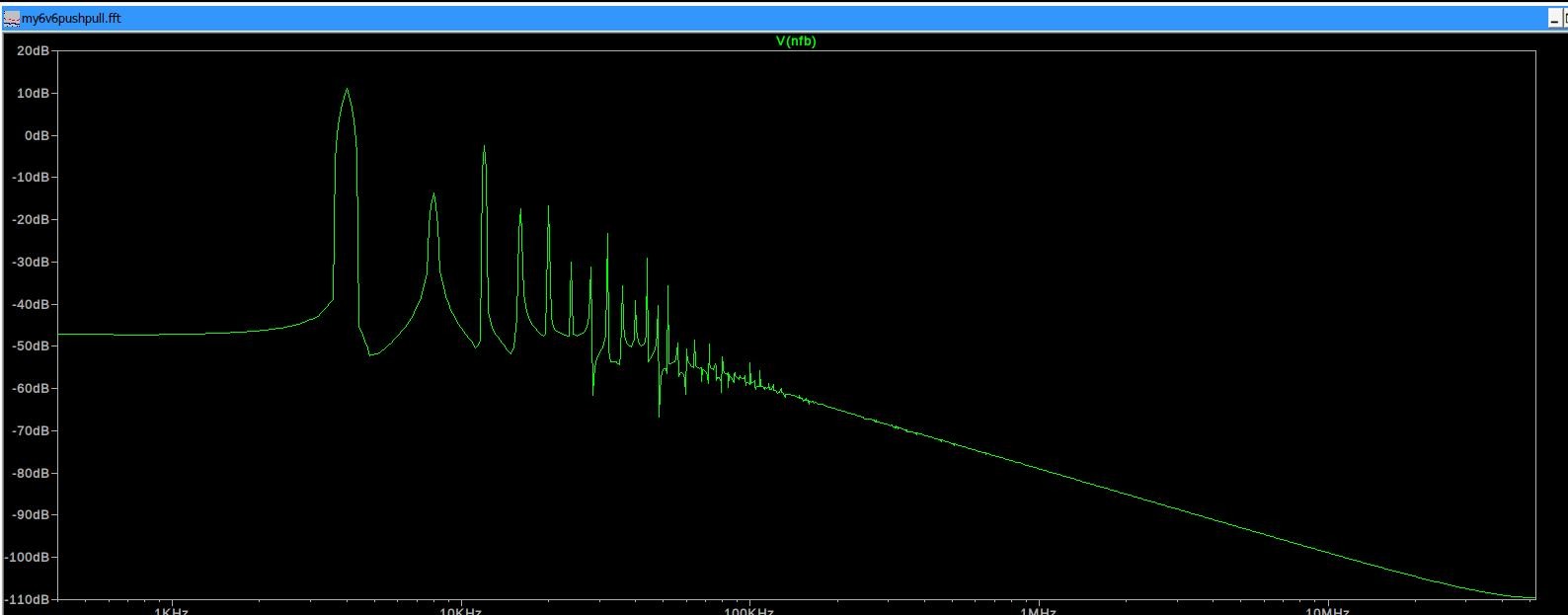

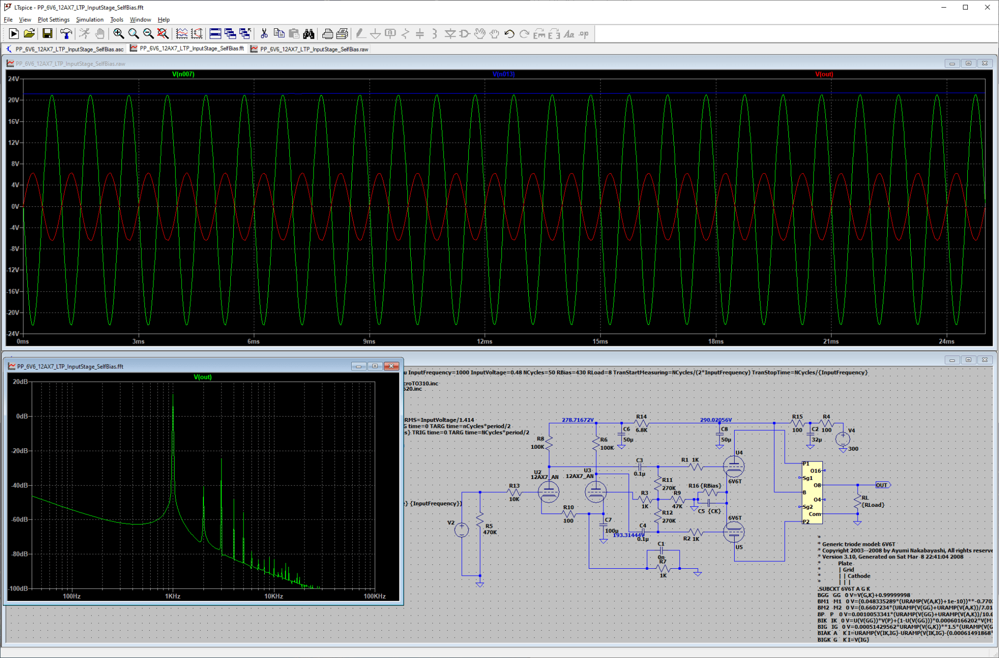

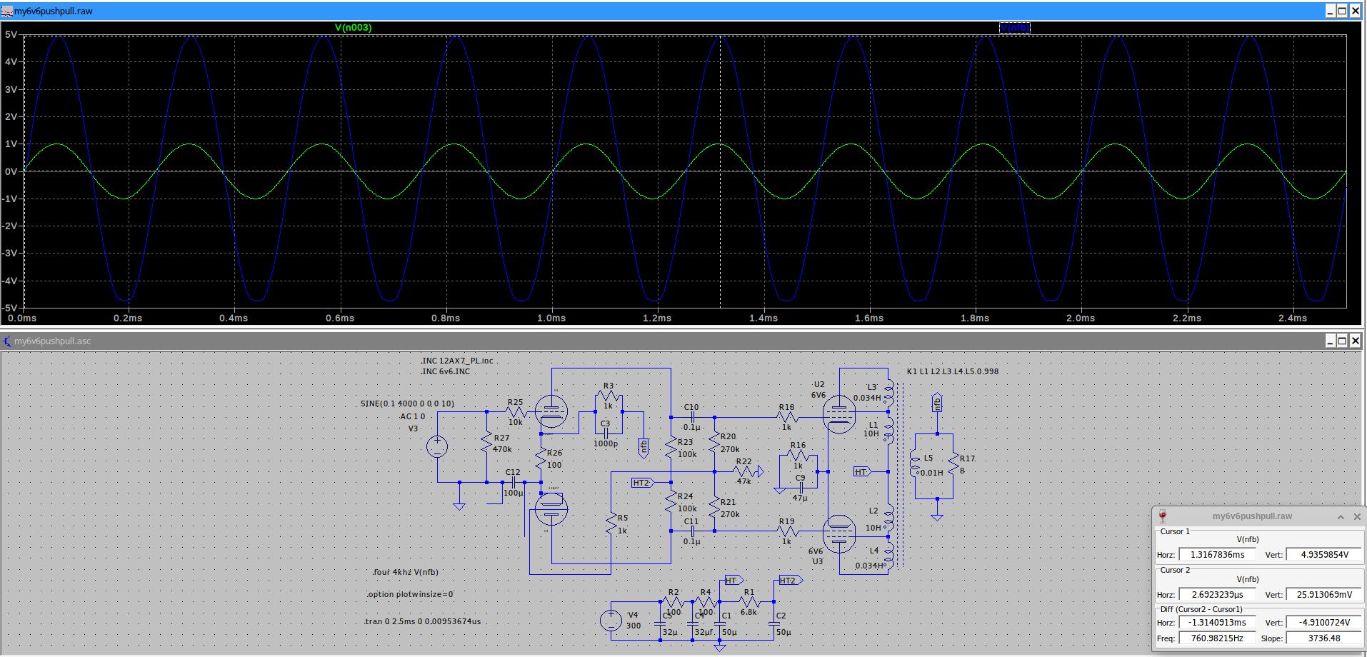

I was doing some simulations in LTspice, with and without FB (the one in the schematic).
https://diyaudioprojects.com/Schematics/DIY-Push-Pull-PP-6V6-Tube-Amplifier/
How accurate is this representation in LTspice in terms of reality?
Do my valves and transformers behave the same?
and if so, I leave you 2 tests that I did, one with FB and the other without FB.
What happens with the signal, is it what happens in reality?
I notice that without the FB, I turn up the volume of the amp and it seems like it is screaming in my face, it makes sense.

Your amplifier was 'shouting' without [global] negative feedback; Right?
Are you willing to try a simple modification?
Willing to have a little less power output?
Willing to listen at lower power?
1. Disconnect the global negative feedback.
2. Disconnect the 6V6 screen from the Ultra Linear tap; connect the screen to a 100 Ohm resistor, and the other end of the 100 Ohm resistor to the Plate.
3. Repeat for the other 6V6.
Note: it is all easily changed back, if you do not like it.
I hope your 6V6 tubes are very well matched. The self bias is common to both tubes, if they are not well matched, the output transformer may be prematurely going into saturation.

I'm going to try with those changes, without FB and with those resistors between screen and anode.
The problem is that I have some inefficient speakers, 87db 6ohm JBL A130.
The simulations I did in LTspice, if I'm doing them right, show something similar to the ones I did without FB but in FFT the even harmonics are shown better.

because?As the previous poster said, the 6V6's share a common cathode RC, it would be better to use two 470r's perhaps instead.
amplifies the input signal better?
I tried with 1k and it gives a better graph

Can you give me the sine wave data and the simulation commands you used?One thing I noticed is that the output stage is running very cold with 1K at the cathodes. I'd run the 6V6s a bit hotter, using 430 ohms instead. In my simulations THD with no GNF is reduced to a half, 3% at 2.6W vs 1.3% at 2.4W, both just before clipping.
Maybe it changes due to the definition of the transformers and valves, I am not very expert in LTspice

Please find attached the simulation file, including the tube (Ayumi's) and push pull transformer (Robert McLean's) models I used. I'm no LTSpice expert either, but there is plenty of good information here.Can you give me the sine wave data and the simulation commands you used?
