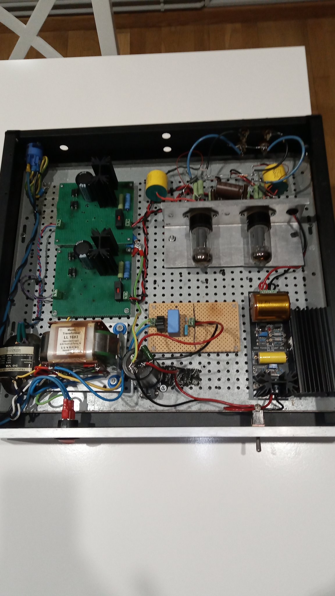

Star ground I see, coax signal wire, local signal grounds, fine. Surely better than before. Better wiring led to no hum result as we projected. Congrats.
What are those black plastic things with a red center on the heater boards? Fuse holders? What is your final power Tx arrangement and what is the raw DC and B+ it finally allowed?
Are fuse holders, the red color is the paper where is marked the fuse power: in my case 0.5A.
The custom power tx 275V 0,3A spends minimum 1 week to make it.
PSU 310-313V so Vin for SSHV2
B+ 290V

*New higher voltage Tx will be locally made? Toroidal or EI?

I don't like toroidal for B+, other mania: I don't like to share the same powwr tx for B+ & heaters, I like R-Core for heaters but never tested for B+.Thanks for the info. You are welcome.
Here is difficult to get people making custom transformers & only for mains power, and the only few that I know always EI, the last maker of custom transformers is retired and recommended a new one, let's see how he does, I asked electrostatic screen to connect at chassis ground.
The prices as all things are skyrockets.
I wish he turns out good this new specialist. Significant to find a local winder you can trust.
Next mod I will change the Auricaps 4.7uF for the Stealth 10uF, to see what happens with the sound.

Don't forget single stage common cathode is inverting. But you can reverse at the speaker connections. Unless your no26 line stage also inverts so the net result is absolute phase correct to be typical.

Ask for belly band (Gauss band, flux band) magnetic shielding also.I asked electrostatic screen to connect at chassis ground.
