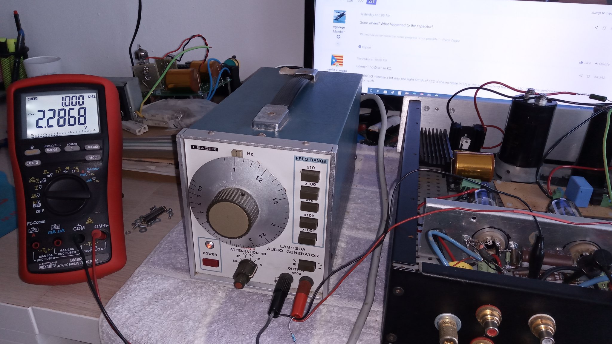

That's only 0.66dB less than 2V. Very near to your goal considering you used what resistor values you had handy.

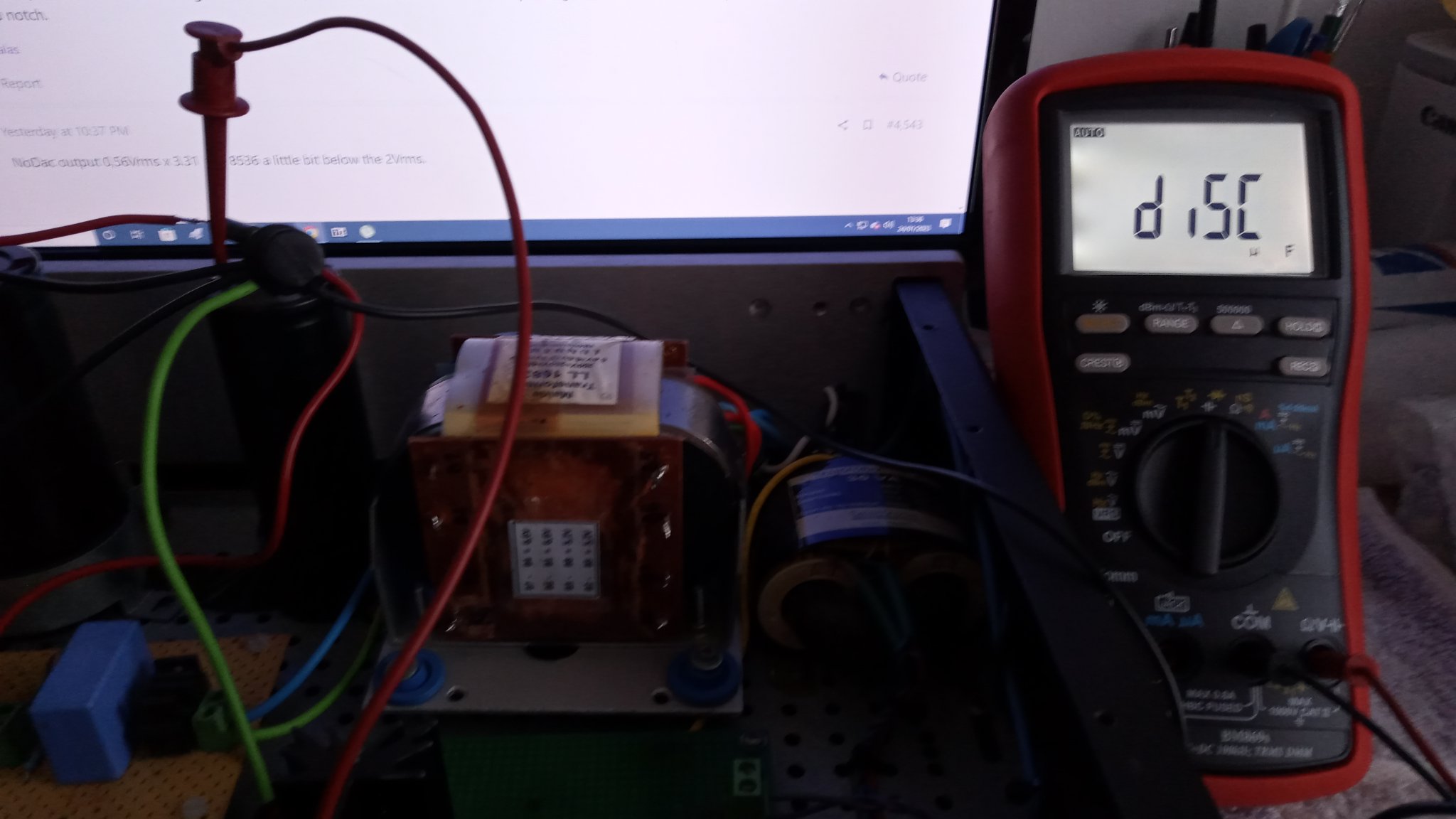

Attached pic.Gone where? What happened to the capacitor?

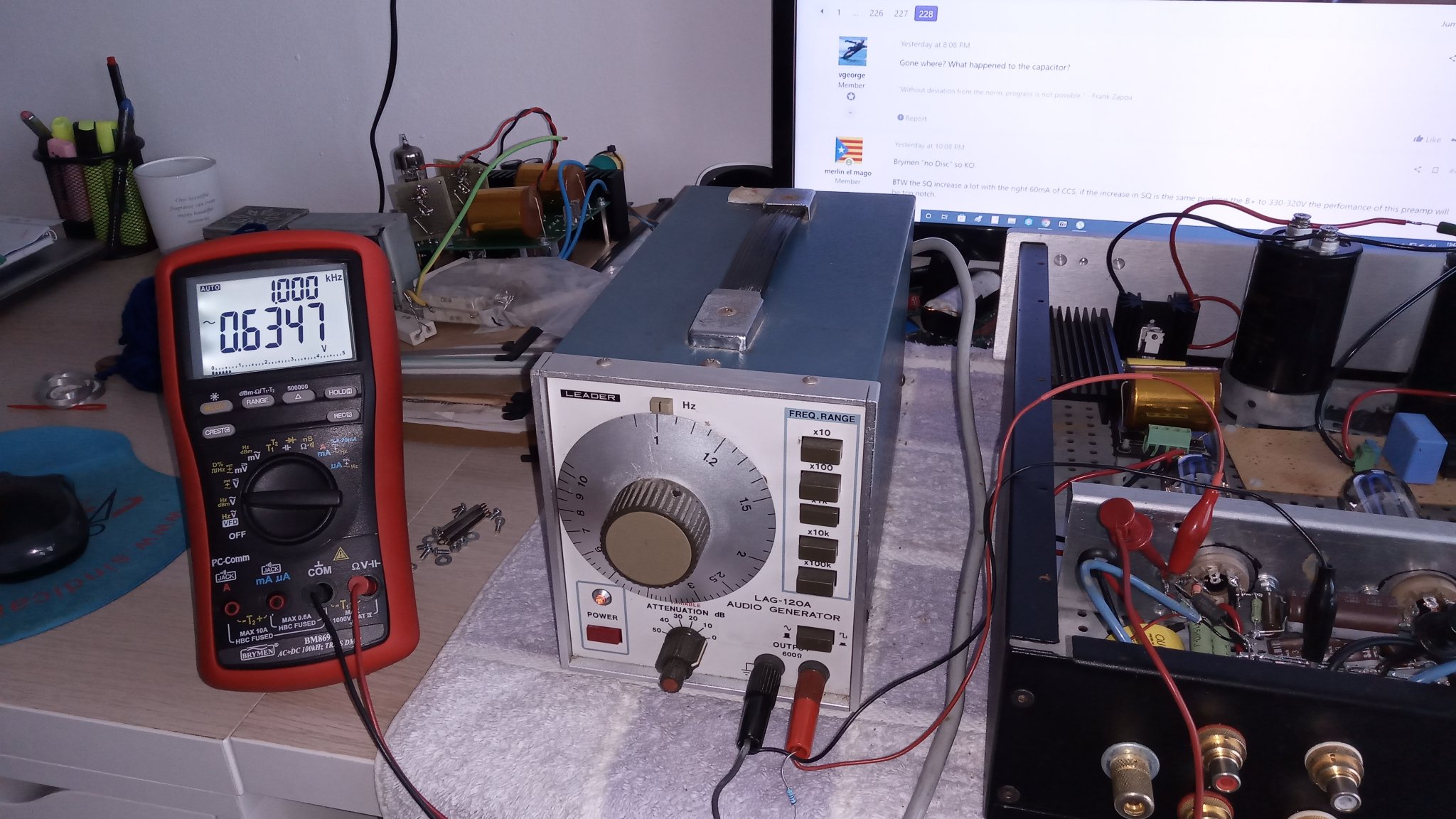

Nice. Surely enough for the NoDAC. No volume pot in your case adds no series resistance to Ri so final gain is bit higher than my estimation that includes 50k volume pot output resistance.
Channel matching regarding gain reads excellent too. Depending mainly on Rf Ri value tolerances.
The capacitor's leg internal connection maybe broken.Brymen "no Disc" so KO.
As per your advice I added 1Meg across input.Nice. Surely enough for the NoDAC. No volume pot in your case adds no series resistance to Ri so final gain is bit higher than my estimation that includes 50k volume pot output resistance.
Yes it's very close, also voltage for both heaters are very close.Channel matching regarding gain reads excellent too. Depending mainly on Rf Ri value tolerances.

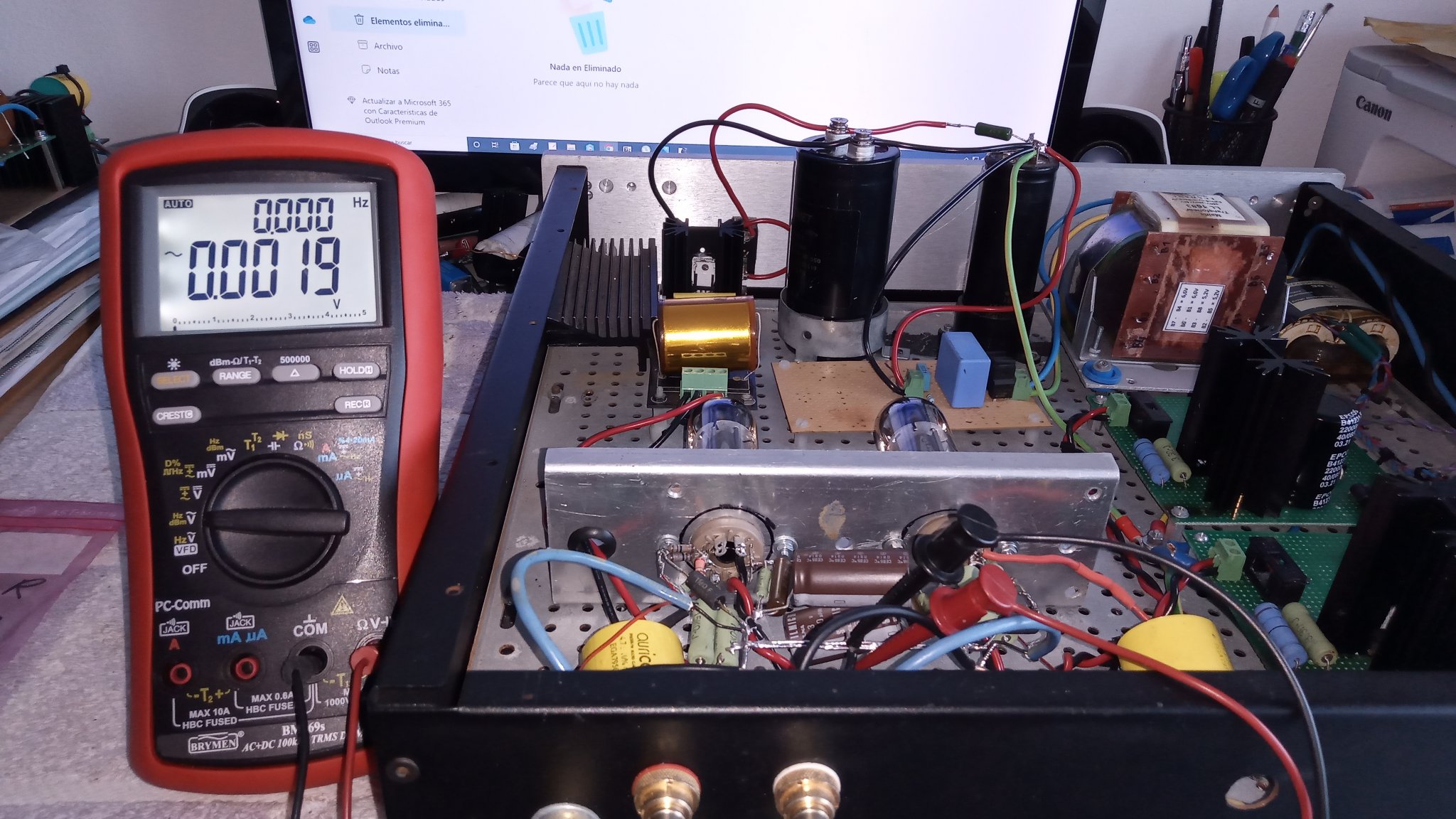

The BG are very old, when I left connected the BG to the Brymen a moment reads 220uF but prefer don't use it and left the big 820uF because when connected SSHV2 in problems to reach the 60mA...The capacitor's leg internal connection maybe broken.
You do well to avoid using it. Intermittent leg connection will bring sudden peak that will break something down the line.

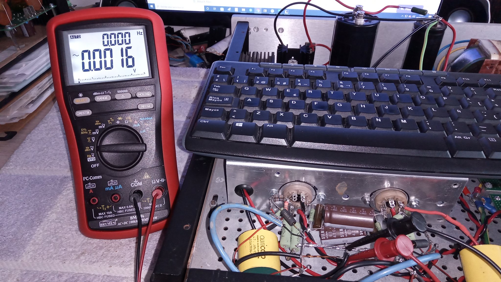

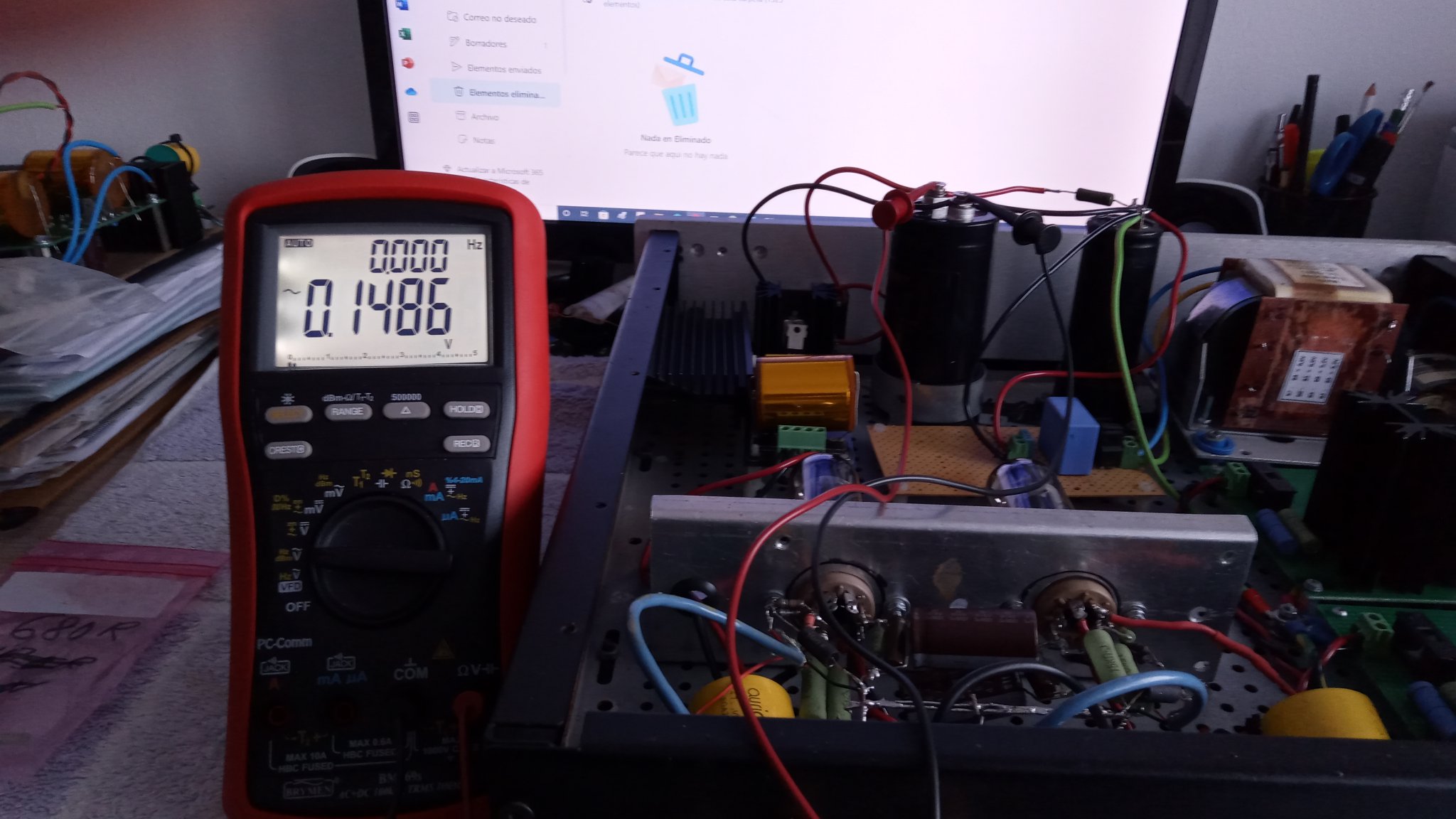

Does good work. What the Brymen shows if you keep it connected to B+ but you power down the PSU? To see if its mainly general noise the test leads pick.SSHV2 working hard to tame the high ripple coming from PSU, can't increase the resistor value between the CRC of PSU because I need each volt available, will do with the new transformer.
Better safe than sorry with HV Felipe.The BG are very old, when I left connected the BG to the Brymen a moment reads 220uF but prefer don't use it and left the big 820uF because when connected SSHV2 in problems to reach the 60mA...
