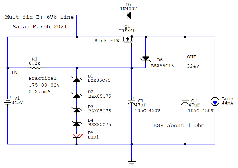

If you will feel your 50Ω parallel Ro Tx needs something lighter, without 60mA reg CCS, maybe try this simple Mosfet capacitance multiplier of mine. But use D4 Zener in the chain BZX85C62 for lower Vout because your rectified voltage isn't high enough. All other Zener type codes put as shown.

That's for me Salas?If you will feel your 50Ω parallel Ro Tx needs something lighter, without 60mA reg CCS, maybe try this simple Mosfet capacitance multiplier of mine. But use D4 Zener in the chain BZX85C62 for lower Vout because your rectified voltage isn't high enough. All other Zener type codes put as shown.
Yes, keep it as an alternative to maybe unload your Tx enough since its tested and working. Constant current can be tough when asking not far from Tx + rectifier spec capability. This one is not even a series reg, let alone shunt reg, its a series voltage referenced filter but its not power demanding on the other hand. Not as dynamic but at least not against good tone. Works on smaller sink too.
