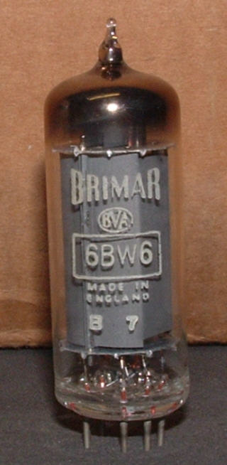

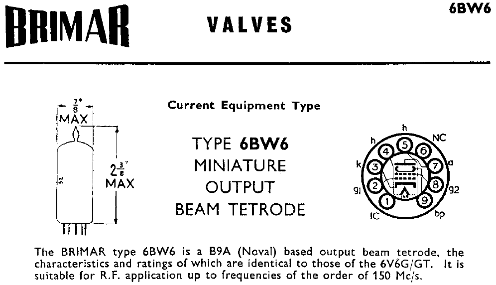

I use it most of the time. The question was if opting for 6BW6 for vibration resistance, would it be as safe as for dissipation and long life too?

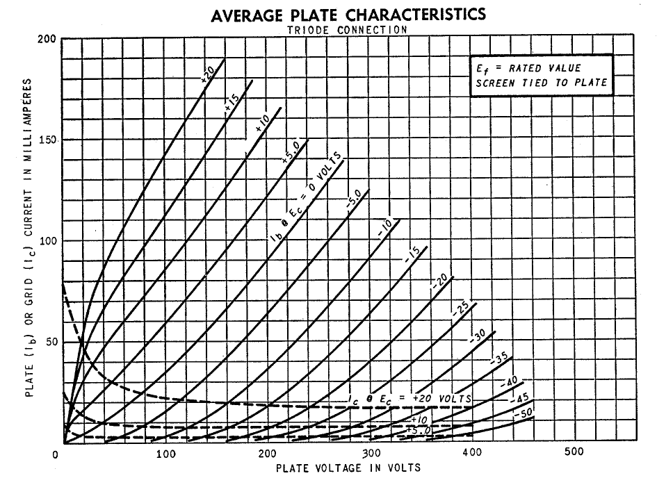

It could, but the dissipation should be much higher than 6V6 class which is already nicely linear in triode. Fat older ST bottle (Coca Cola style) 6V6 tend to sound mellower and be more ringy in this application. In power amps the output transformer ratio extinguishes the voltage gain into current transformation so microphonic behavior its not noticeable.
Has been discussed in the thread's start. 6V6 was only the beam tetrode Yankee reply to the Eindhoven extra grid patent, they are same class different taste. At 5W dissipation in my preamp I would still argue pro American tubes bigger envelope in this class. 0.0048% THD+N in Gregory's CF and -120dB to -143dB 20Hz-20kHz noise floor in post #231 is not a particularly disappointing result anyway.
