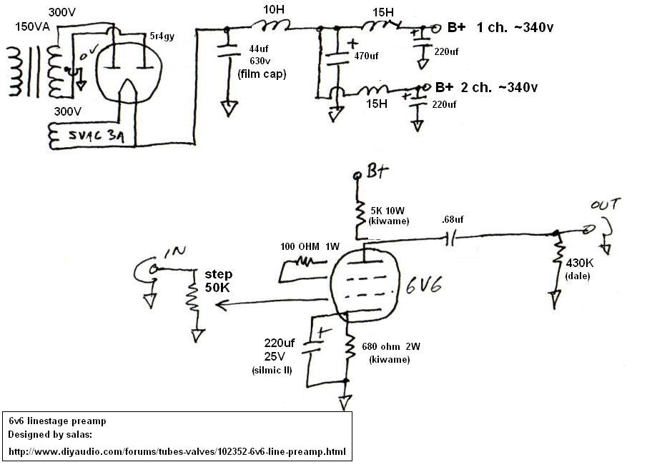

Thanks Gregory, I will appreciate your input because I need to know how to do for my #26 tube preamp.
Look at post #81 the schematic there has more details and additions. That one you posted was the first core idea. Still not wrong.
So for the sake of simplicity, i can just follow the mentioned schematics and the amp would still sound great right. Thanks.
Yes, but he must use a regulator for ''great''. With just CLC there will be some hum.
Perhaps an appropriately designed CLCLC (PSUD can help here) will suffice, but that last filter cap should be probably be a very high quality film cap.

Kevin,
Care to expand your comment reguarding recent experience. Was your recent experience pro or con regulator?
My experience with regulators has been nothing but positive till I do something stupid with them.
Ditto. Finishing up a 12B4 preamp now, and getting ripple/noise below -125dB with cascode CCS into gas regulator tubes. If there is a reason to change this method, I am all ears.
I've been using gas regulators tubes on my 26 preamp for convenience and beauty, but the SS shunt regulator is quieter. The tube regulator still gives me a "whoosh" type of noise. It's not bothering me, but it's not like the SS shunt regulator which gives you that "black" background.
Hey, that's actively regulating too. Not counting with the CLCLC guys. 3 to 2. 😀
