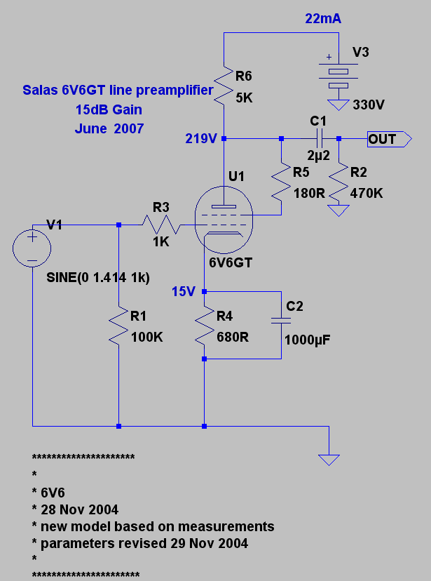

6V6 line preamp
If you don't need the gain since you make do with a dcb1, choose #144 which is a follower that Scott Gregory makes. The gain circuit you posted is right too, but we use an active regulator for B+ since then for both common cathode or cathode follower. Either Maida, or SSHV shunt reg (smoother).
I was gooing to try as a pre after wonderful DCB1 as volume control. Planned on using you regultors of course. May need current source on top for gain since it will be driving power buffer. Do you have proper incarnation of regulator forthis amp. I know you offered two. Happy new year.
Gives 15dB gain with the resistor, if its enough to your speakers. Just a little more with CCS load for the additional work and devices. No real boost. Would need careful suspension and placement to avoid microphonics when in gain mode. Use straight profile 6V6 bottle. Look for SSHV2. I would make double mono regs set at 45mA each.
Like this one from #190

You will not go wrong building this with AC as the heater supply. Later you can modify it to go DC if you find necessary. I doubt you will have any issue.
Shunt regulators need quite a bit of heat sinking for filament applications. If you feel DC is critical then use a CCS for to regulate the filament current.
For this pre amp spend your effort on the circuit and making sure that the tube is mechanically suspended to minimize vibration. You will reap many rewards doing that first.
