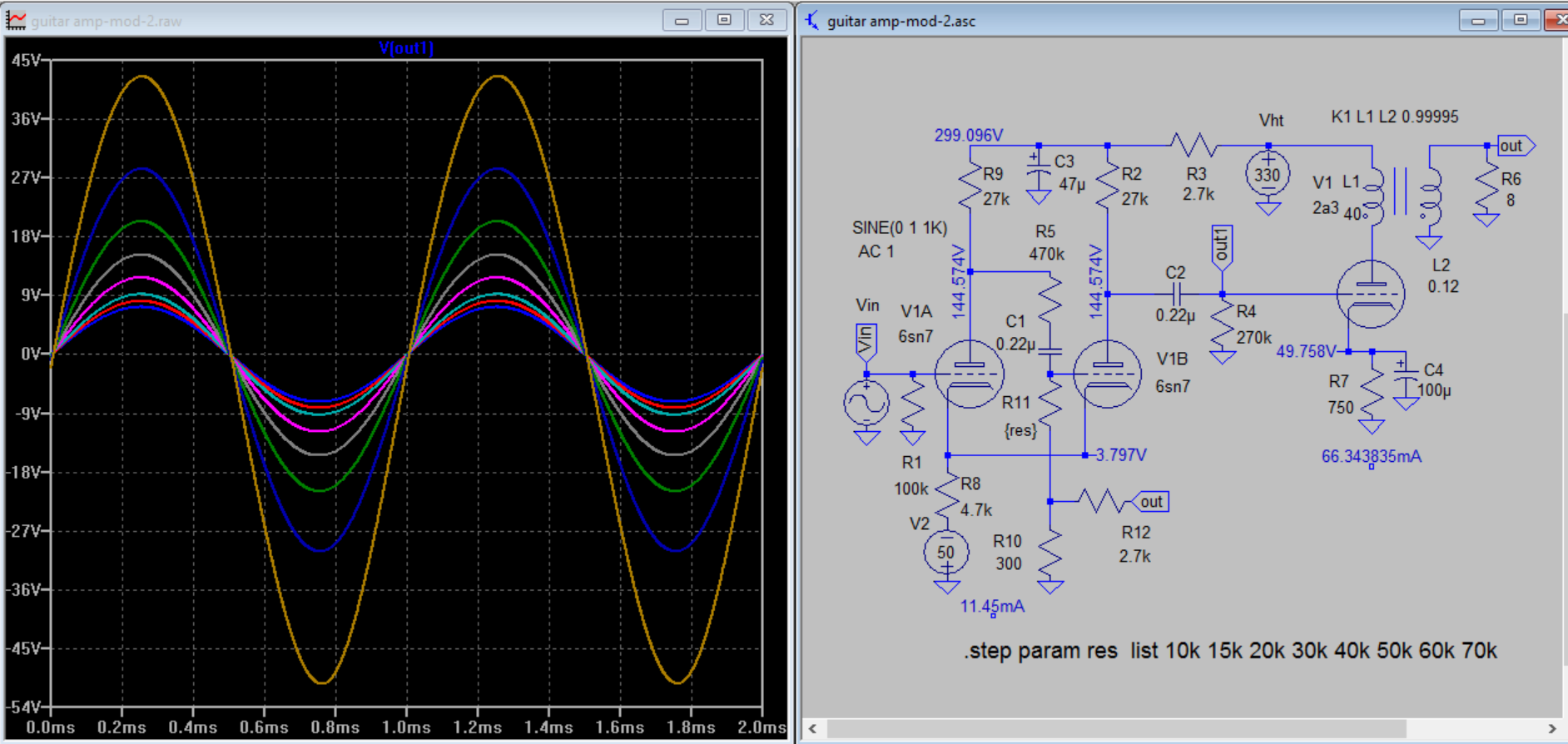

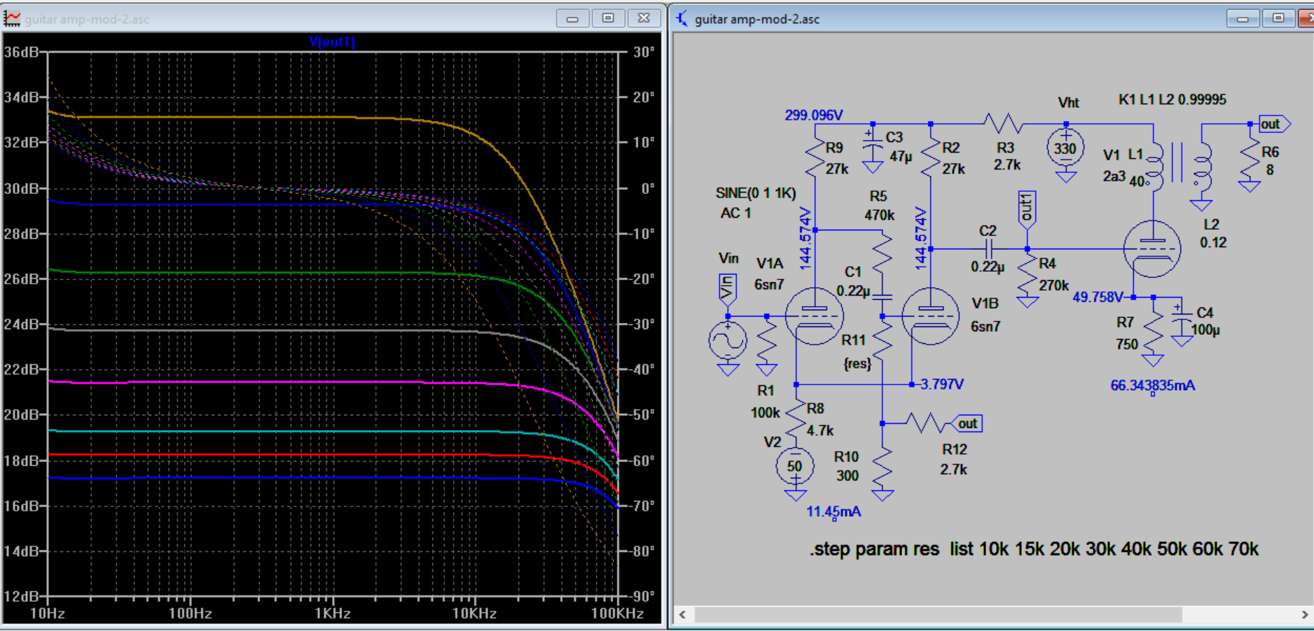

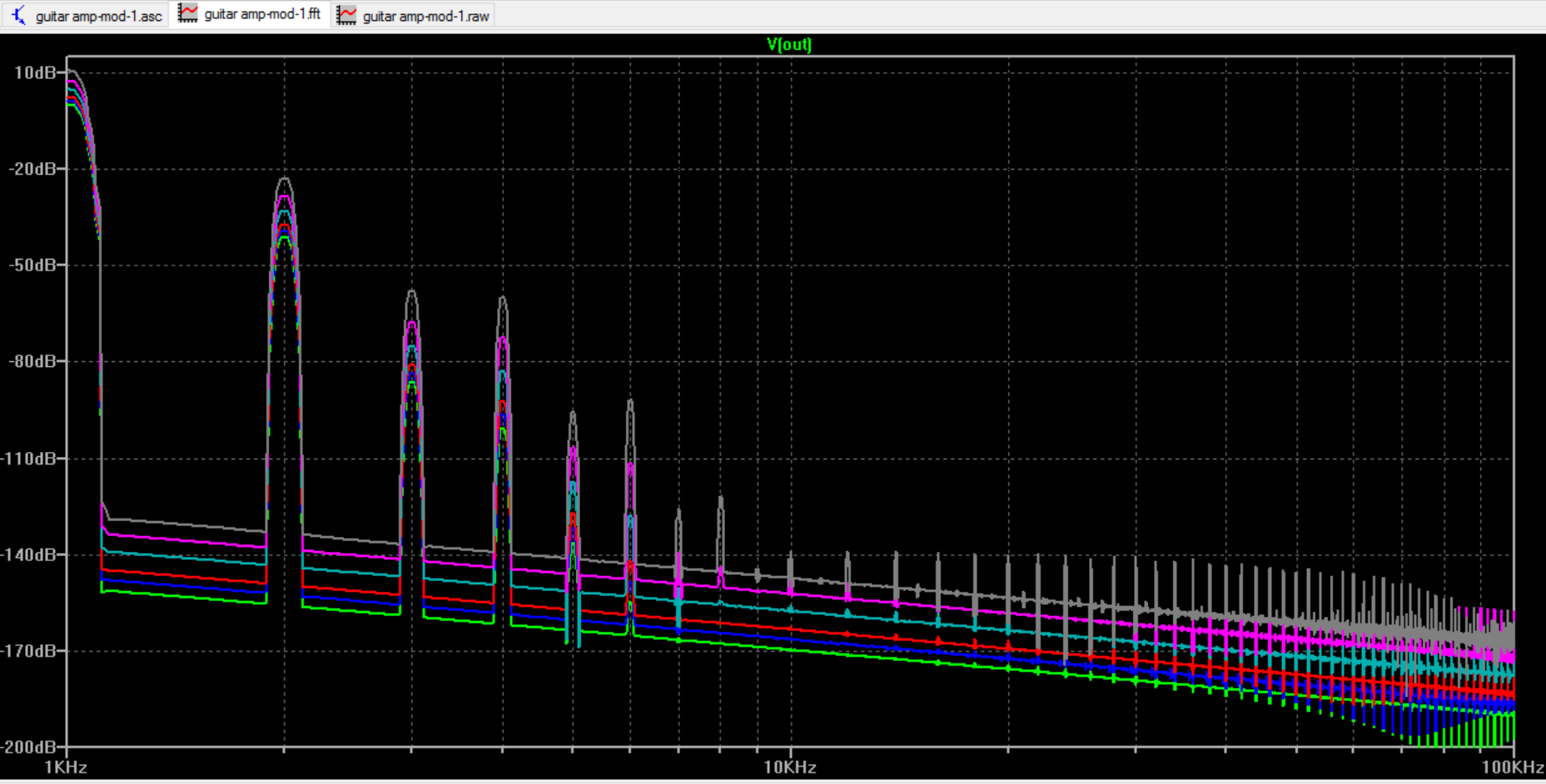

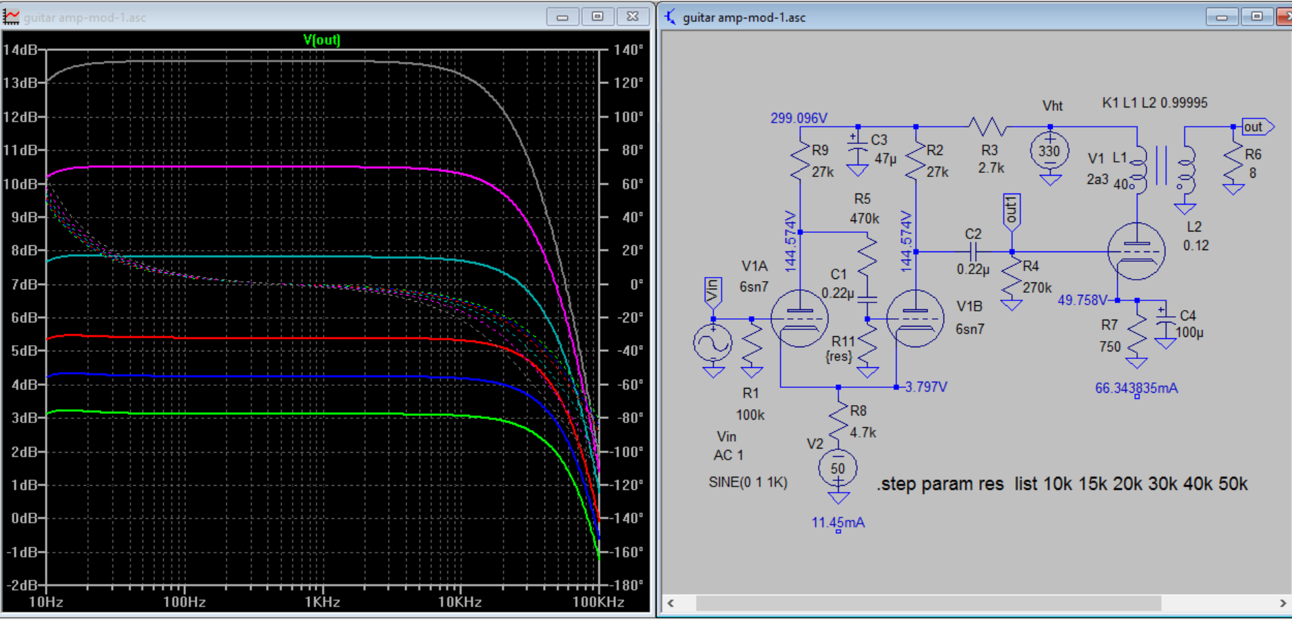

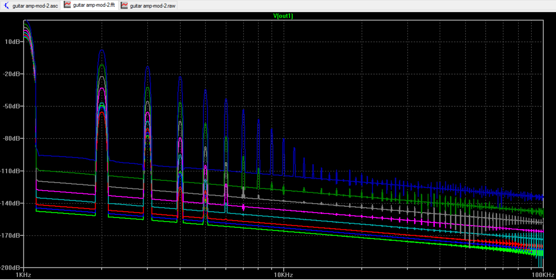

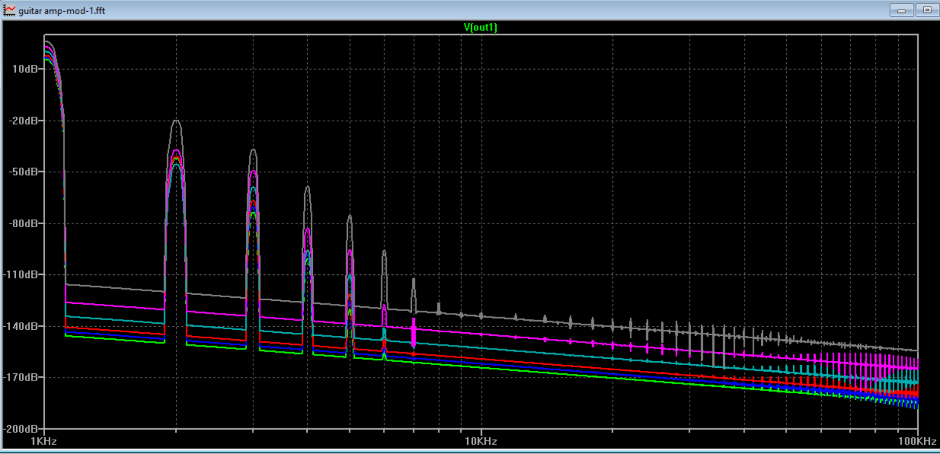

Sorry to hear what happened, but with your effort and the help of this forum hopes the trouble would soon be over. So here is another idea. Despite this is LPT, but the even harmonics are not canceled.

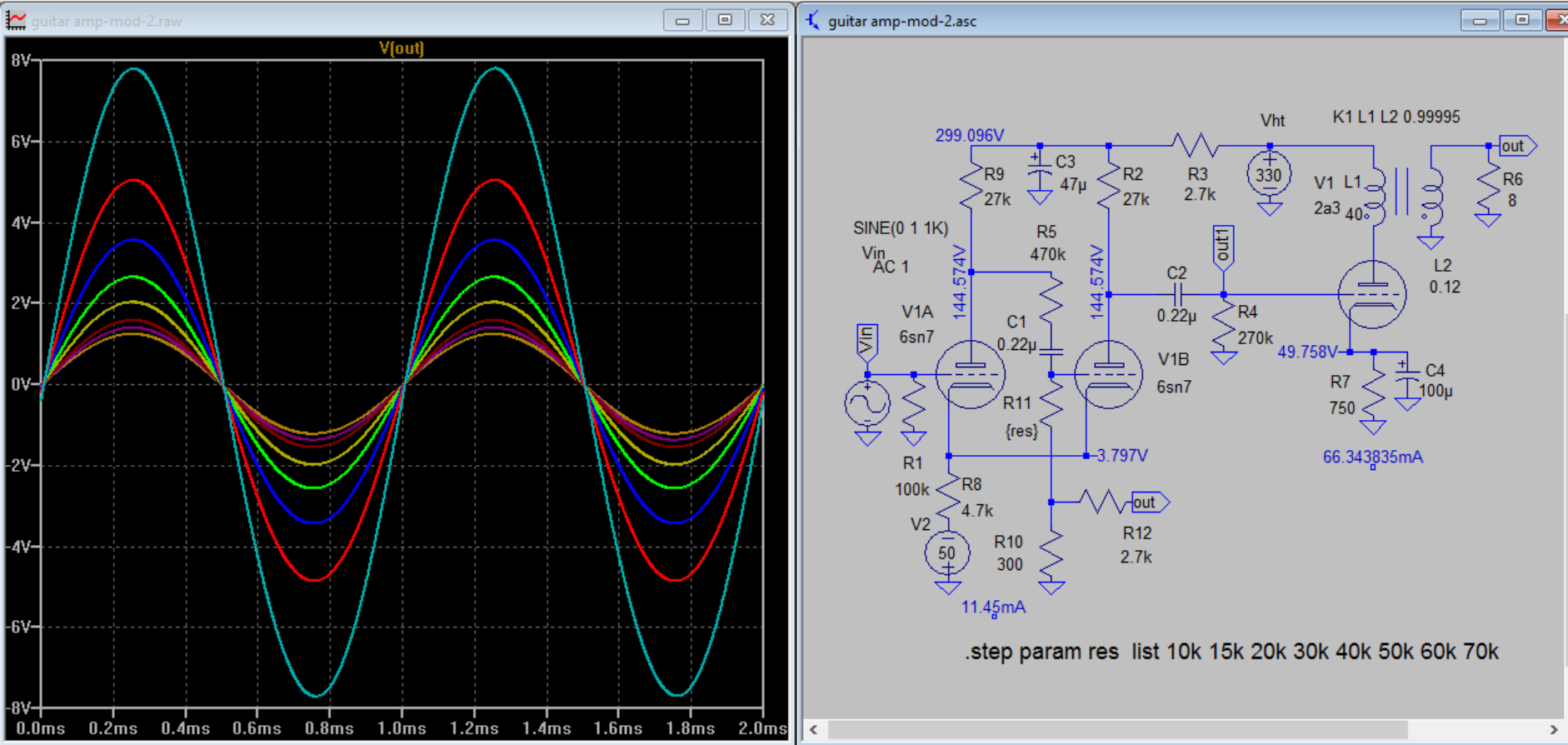

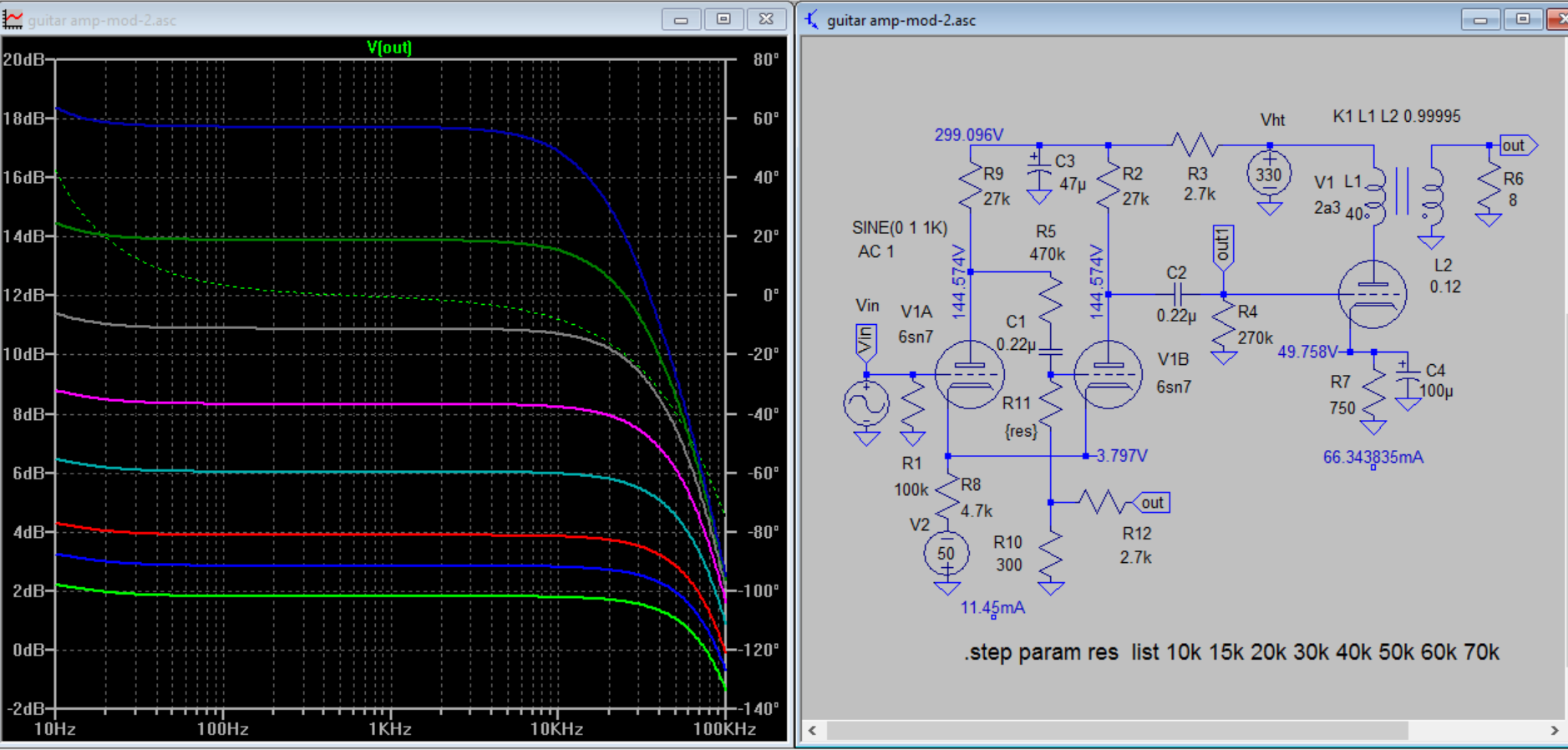

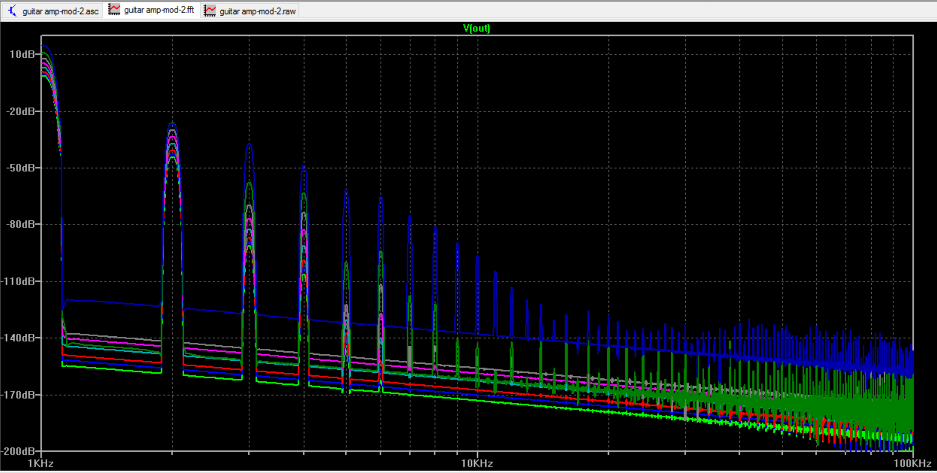

This is NFB version, with no loss of gain and harmonics.

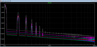

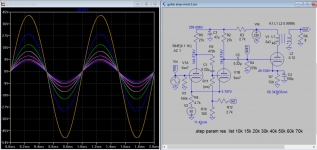

Thanks for simulating the circuit again. I read that the NFB can give unstable highs and lows. What is LPT? I think I need another explanation what you did here. You named the files guitar amp mod - it is a not a guitar amplifier. The source is a minidsp 4x10HD digital crossover unit.
LTP Long Tail Pairs, must be spelling, never mind about the file name, you said before it can use for guitar amp that is why I name it, now for hf-fi only, whatever use is no harm. Maybe good for acoustic guitar, with the amp will have even harmonics dominating, if build as such.
Unstable high and low? Not really. the only thing unstable is the output transformer, here the feedback is only quite low. It's not just NFB, positive feedback also use, that is why there is no loss of gain. I use PFB and NFB together for a long time in hi-fi amp, the harmonics are well controlled as you see from the plot. There is one version I mentioned which uses only PF, and the gain is controlled by the amount of PF. I don't think you and not many other have tried PF before, it has been used in several commercial amp such Dynaco ST70 and phone pre-amp. PF can undo the bad effect of NFB such as creation of odd harmonics.
One thing you may have noticed in the sim in the NFB version is the shift of distortion to driver from output stage. The driver stage has about 5% distortion or pre-distorted correction for output stage to get it down to 0.8% at full power. The sim has revealed the weakness in the output stage, maybe that is why it's suspected, as it has not able to optimize the performance using the existing circuit because it has no mean of correction and no obvious pre-distortion correction, this is that my main concern for your amp. Some drivers I sim found them to have some fixed pre-distorted drive, with NFB it's dynamic. If you have other problems let me know. My sim maybe not be correct unless your verified it and I'll not send any more version. The weakness could be in hardware as well, but adding dynamic corrections are big plus.
Okay, I can try to make it at least and see how it sounds. I only need the passive components since I have the tubes and transformers already.
Interesting that you found a weakness in my current preamp, or at least a very similar version of it. Could be part of why I don't like it as it is.
I will build it and see how your versions sound. Will take a few weeks.
