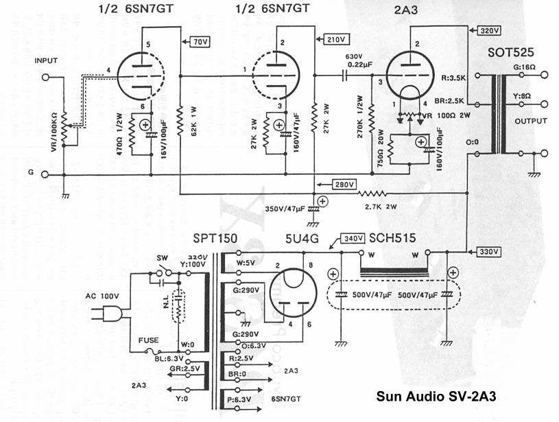

ok.. like only 2 x 200uF makes not much sense for a clone of the sun audio circuit.... Perhaps try drawing out the circuit or taking a picture of the board?
I have a funny feeling we will see SSRP.. for some crazy reason, Chinese "designers" love SSRP... they like to put it all over the place - including many places where it makes no sense. such a tragedy.

If there are only 2x 200uF then they could be bypassing the cathodes of the lower triode on an SRPP circuit. What are their voltage ratings? 25V more or less?
In any case, you could easily consider building your own circuit here. no real need to stick to 6SN7 if this is the case either. 😉

I for one would still want to figure out this circuit before going forward. I agree with you that the original poster should not give up on determining this circuit. I kinda hope its SRPP... 🙂
There are a few different mods that could be considered here for lower gain and higher fidelity, likely without even changing the board.
For example, if it is indeed SRPP, the original poster could see about tapping the signal off the plate of the lower triode. This will immediately lower gain and reduce distortion.

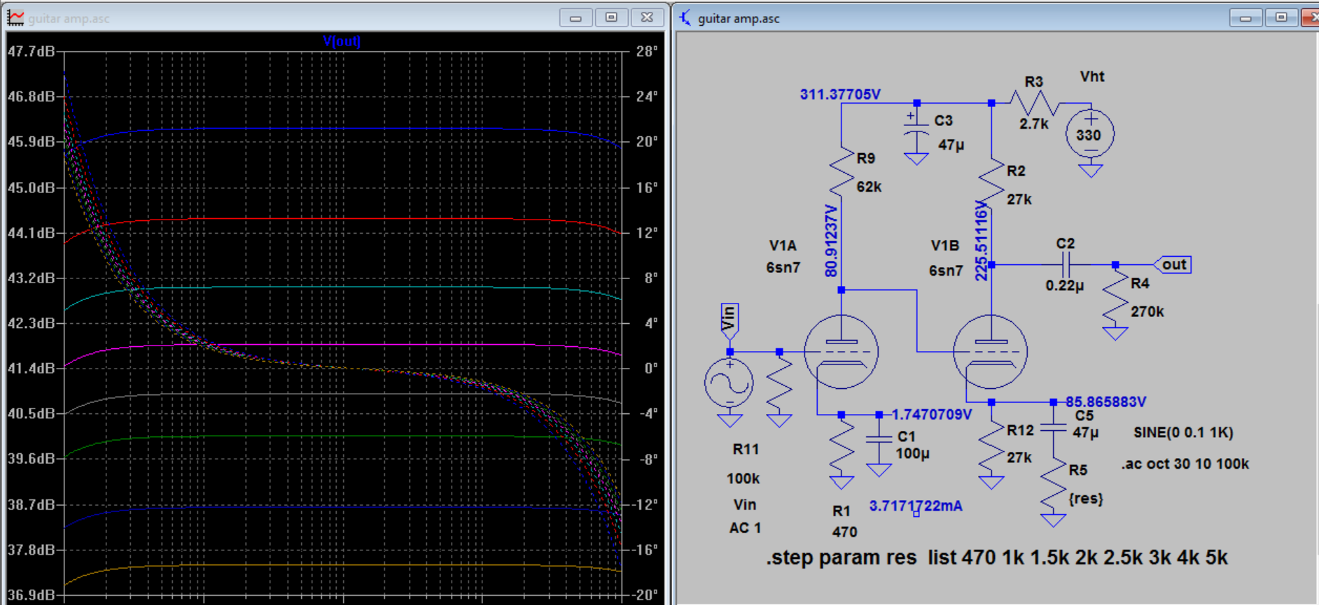

As for the preamp circuit, I want to scrap it and use only half of a 6SN7. Or both with sides the resistor mod after a 20uf cap that was suggested before in pictures on page 2.
I will make a new board and I am open to more low gain preamp designs that would work well with a 2A3.
So lets forget about the Chinese version of the preamp. Everything after the 0.22uf cap is the same as the original Sun Audio 2A3 amp, including all the components close to the 2A3 tube amp and the power supply.
Attached is the original design from Japan and the mod with the change to a 20uF cap and a resistor of choice up to 10K.
I will also try to use only one half of the 6SN7, or use a tube like the 6P5 which has slightly lower gain. I could use two 6P5 tubes in an adapter without changing anything, but I think I would not lower the gain enough. One 6P5 per channel would be interesting to try.
