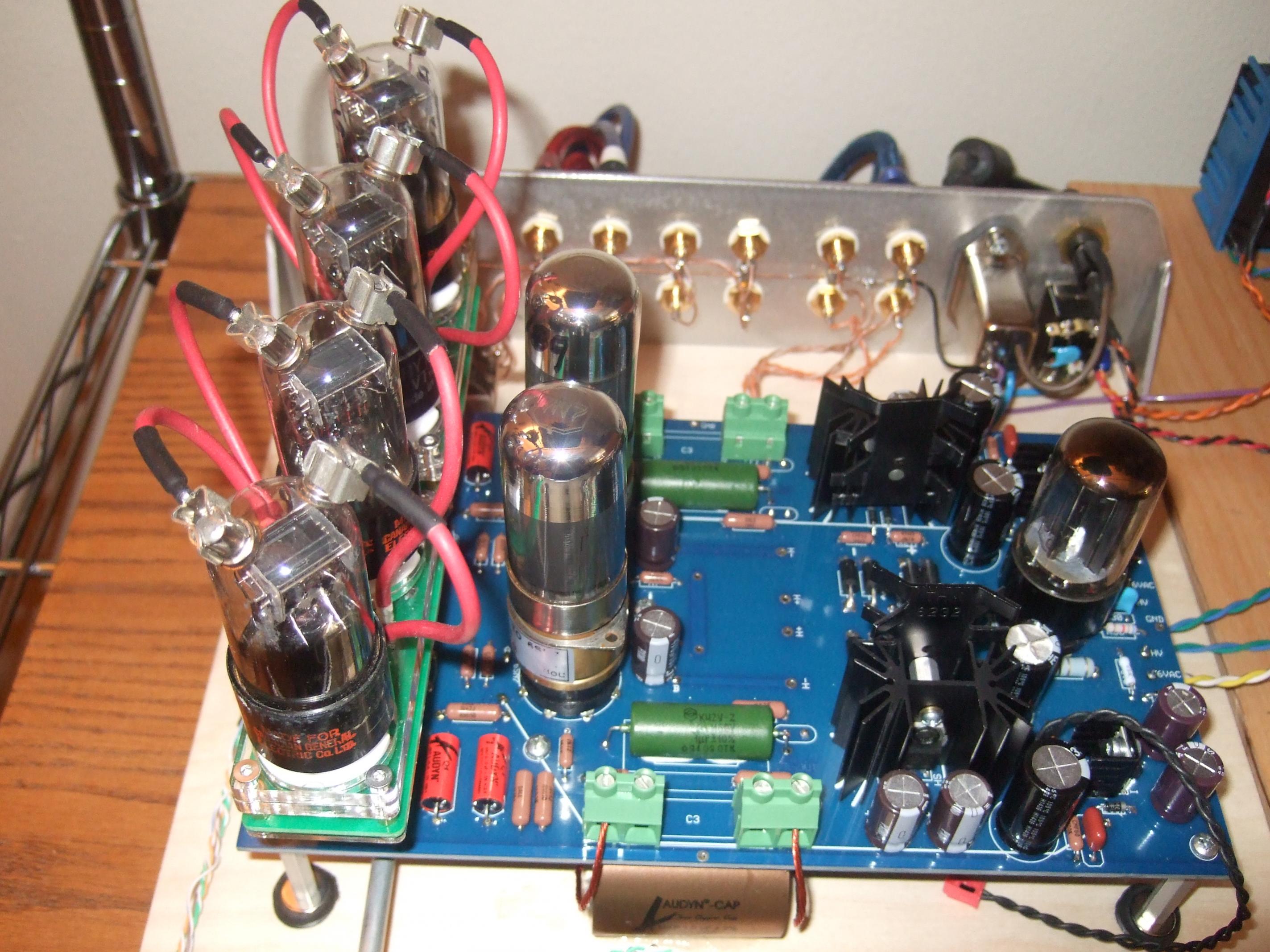

Believe me, there is plenty of power left if I reduce the gain. For normal listening levels I use maybe 5% of the 3.5 watts. The Sun Audio clone amp handles the two horns, that I sculpted on the balcony. Hf rolloff is okay as long as the amp can still produce sound above 440 Hz. The JBL 2225H woofers are handled by my DIY Firstwatt F5.

Thanks for more suggestions. Not sure about the last suggestion to remove diodes. You are not speaking to a tube amp guru. The Firstwatt solid state amp was easy compared to a tube amp. I have upgraded a few caps in the tube amp, that is all. I may dare to make a few small mods.
About the suggestion to build a 1 watt amp: 1st - I already have an amp, and I just need to reduce the gain on the preamp tubes. 2nd: I have not found a 1 watt 2A3 tube amp design. 3rd: Seems expensive to start over.

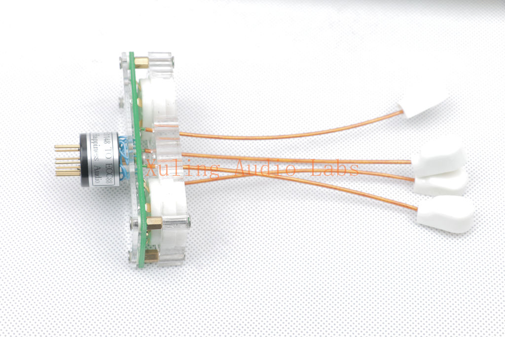

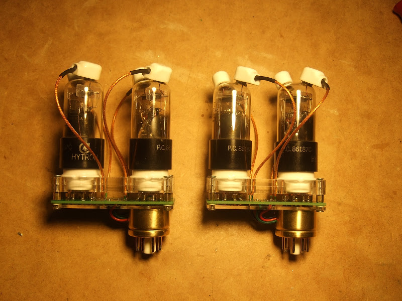

You can simply swap in a pair of E-1148 tubes with adapters per 6SN7 and voilá, lower gain.
That is what I asked for from the beginning. Looks a bit more complicated that just swapping tubes though.
Not complicated at all. Just pop in the tubes and the adapters and it's done.
Nothing to adjust or change. Instant lower gain.
I found this adapter, but it does not look like it fits the 6SN7 socket. Which adapters did you use?
I think I found your setup. Looks like a custom job.
