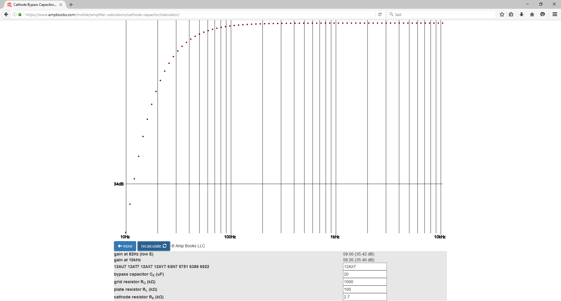

Won't removing the bypass capacitors make a very shrill sound?

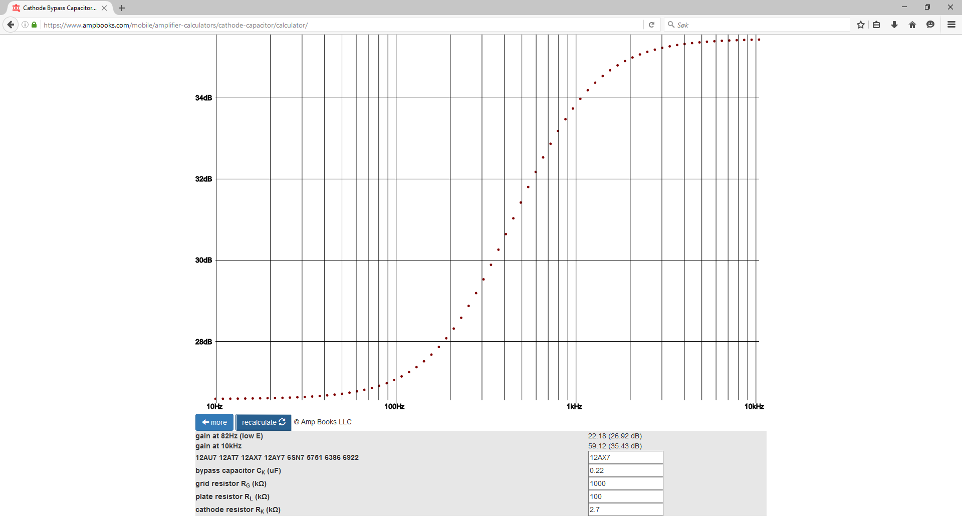

https://www.ampbooks.com/mobile/amplifier-calculators/cathode-capacitor/calculator/
This calculator will not do 6SN7, but 12AX7. When using a 0.01uF cap I get a treble boost. 0.22uF at least some midrange. At 20uF I get the whole frequency range. But, I don't know what I am doing so correct me if I am wrong.
ColinA: So I should forget about it? It must have some gain that I can reduce.
Won't removing the bypass capacitors make a very shrill sound? [/url]
The key word is "remove," not "replace with different values."
Okay. I could not calculate "0" with this calculator. It will be interesting to see how it effects the tone.

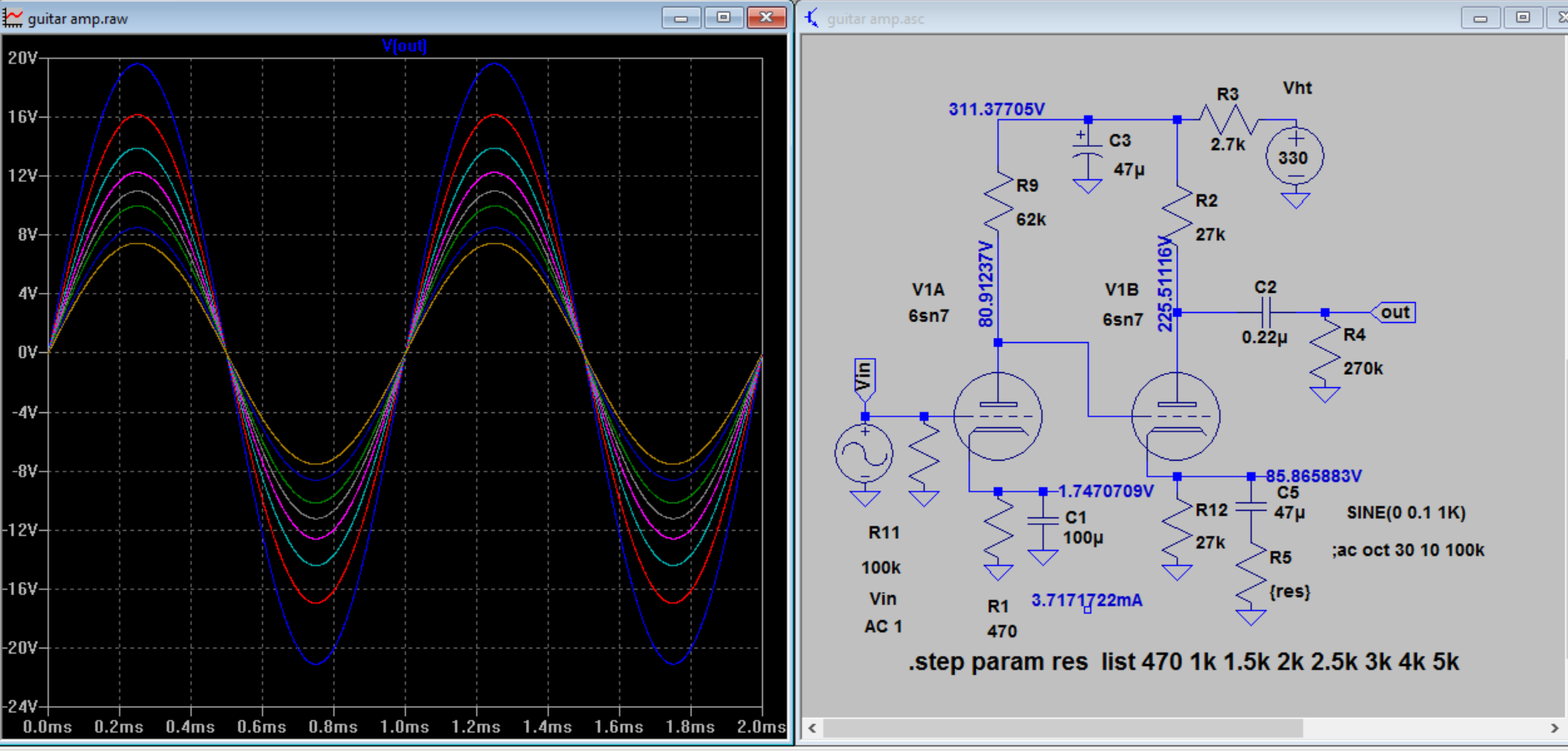

How about this?
Thank you for simulating my amp. More than I could ask for. Please explain more what you did.

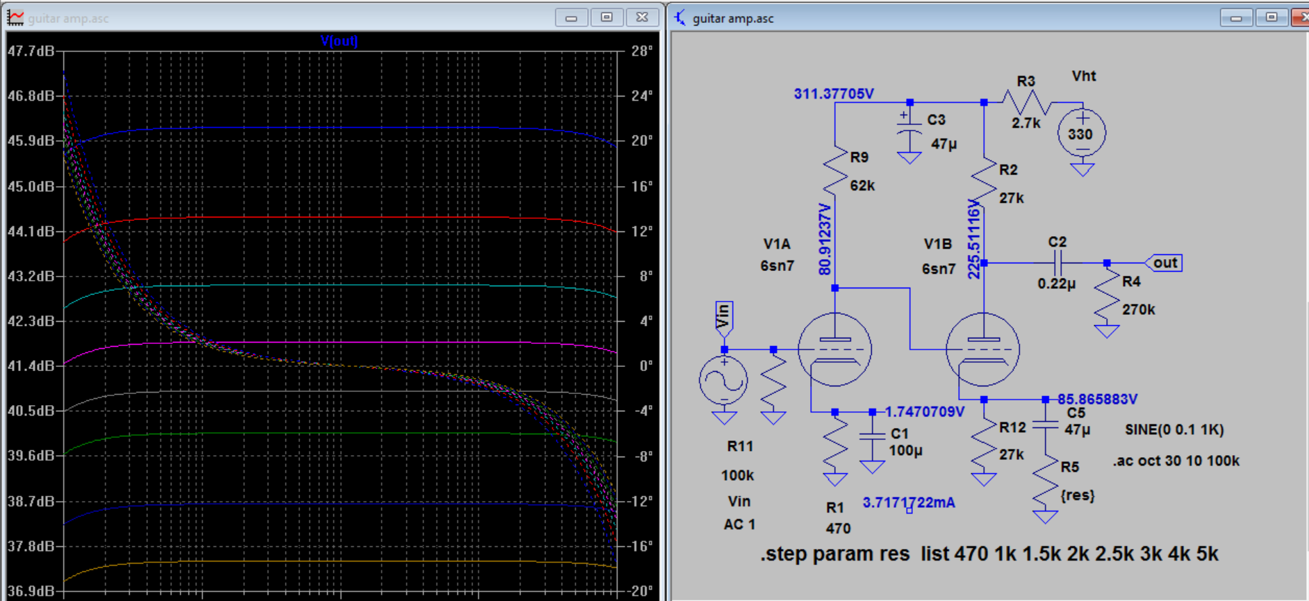

R5 is made a variable of 5-10k pot in series with C5, as the resistance is increased the gain will drop. The 1st stage has a gain of 20, the 2nd about the same, if R5 is very large or opened, the 2nd stage will have zero gain (X1). You can vary C5 to roll off below 100hz. You can then overdrive the 1st stage.
So you think to reduce gain I should not remove the cap, but instead add a resistor (F5) between the cap and the ground?
So you think to reduce gain I should not remove the cap, but instead add a resistor between the cap and the ground?
Yes, that will do. If not a bass guitar you'll need to adjust C5 for suitable roll off at low frequency.

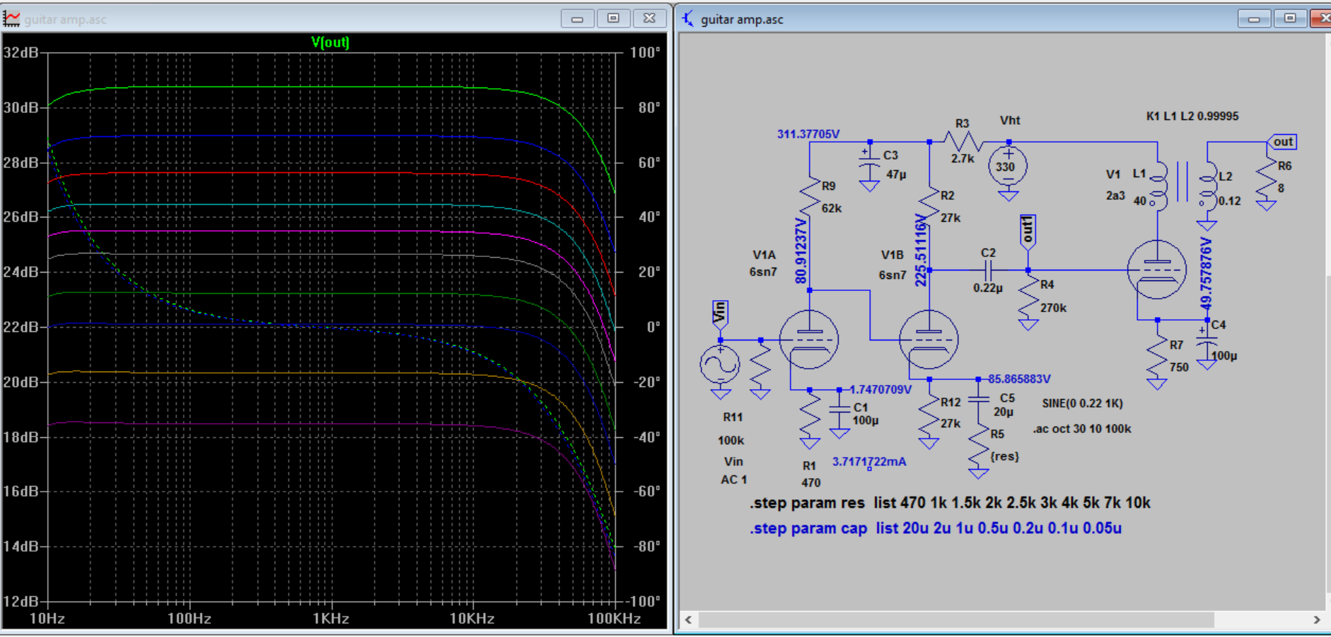

Changing the impedance the cathode in the second stage sees in order to reduce the gain could result in much higher plate resistance in the driver stage which in conjunction with the 2A3's miller capacitance will result in earlier HF roll off. It might or might not sound OK.

Yes you're correct. So don't use too high resistor. With 10K res., the output impedance of driver is about 21K, while the input impedance of power stage is 27k including grid resistor. There is no problem so far with my sim.
