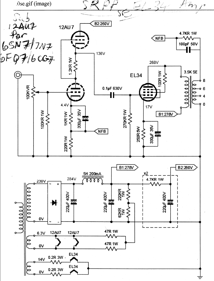

The output stage isn't a huge issue right now. I could use UL with a triode switch, or pentode with a triode switch. Since I don't object to my pentode amp, I might try pentode unless I need to use UL for stability or some other design reason. I don't know.
What needs attention now is the issues with the driver stage. Without a correct driver stage, the output stage and the transformers are irrelevant. As anyone who has read the thread knows, the driver stage was designed for 6SL7 not 6SN7, and I have 6SN7 in my hands. I could change tubes if necessary. The driver stage on the kit schematic used one 6SN7 per channel, with the two triodes in each tube wired in parallel, but they did it without using separate grid stoppers and without separate bias resistors for each half. The voltages look all wrong. So that schematic has been discarded. It's in post #1 if anyone wants it.

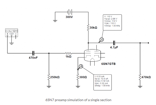

Then the question came up whether there was any real reason to parallel the two halves of each 6SN7, and there may be no need, which led to the idea that we might be able to use a single 6SN7 driver tube with one half of it for each channel. Well, that certainly would be a simple approach. If there is a valid reason to parallel the two halves of the 6SN7 drivers, then I have a schematic that shows how it might be done, but so far nobody has been able to determine if it is needed or if it is wise to do so.
I also found a schematic for a SRPP driver section using 12AU7 or 6SN7, but my understanding is that for SRPP, "You have to raise the heater voltage above ground. Otherwise you get electrical leakage between the heater and cathode (H-K leakage) and the tube gets noisy and must be discarded. Tube data sheets specify the limits." Those aren't my words, which is why they are in quotes. I wouldn't know how to implement that, and unless using 1/2 6SN7 isn't going to work well for some reason, why complicate matters with SRPP?

yes, you have to elevate the heaters if you use SRPP. Imagine both halves of a tube, one working as normal, but one acting as an active plate load instead of a plate resistor, so one triode is sitting above the plate of the other. This upper half is gonna run at a completely different operating point than the lower half.
Now, let's picture a tube where the plate might have a max voltage of 600v, but the plate-cathode (p-k) voltage limit might be 250v. In a typical resistance-coupled circuit, the preamp supply will be some large fraction of the b+ and the preamp tube's plate will be idling at 150v, with the cathode at 1.5v. In an SRPP, that upper half of the tube might be at 400 with the cathode at 250v. The p-k voltage is still 150v, even though the plate voltage is way higher. Ok. So in the datasheet there's a max voltage spec for the heater-cathode voltage, since they're so close together, separated by insulation. let's say that's 150v. since that upper half of the SRPP has a cathode voltage of 250v and the tube limit is 150v, you need to Elevate the heater voltage 100v to keep the tube happy.
now, we know that AC voltage can run on the same wire as DC voltage, that's how the signal passes thru the amp circuit. but the 6.3v that heats up the filaments can also ride on top of a DC voltage. So you'll have 147v and 153.6v (or whatever) and the difference between those 2 voltages will be what heats the filaments. Elevated.
I'd rather find a simpler approach than SRPP, but it's on a schematic that was used succesfully by another member a while back. If anyone is interested it's this one below, but with 6SN7 in place of 12AU7, which they said worked ok. My voltages however, are not the same. I'll be at about 335 not 278. They had a lower voltage power transformer than the one I have. So I couldn't implement this without changing the resistors for the heater elevation, and I wouldn't know how to calculate that. My power supply is in post #1. NOTE: I only have one heater winding for all four tubes unlike the schematic below.
Ya, not just SRPP, any of those Totem arrangements where one half of the tube is at a higher voltage. Cathode followers tend to need elevated heater voltage, too.
The upper half of the preamp tube in that schematic would probably require elevation. Just another one of those things you've got to check when you start getting fancy.
But the EL34 in your circuit has a cathode voltage of ~20v, you don't need tons of drive. If your chassis has a single hole for an octal driver tube, get a 6Sl7/6H9C. Something like 100k on the plate , 1k cathode and 220u bypass. Check the RCA receiving tube manual, resistance coupled amplifier section, page 640 or so.

30k on the plate and 322 on the cathode seems low
When we don't have a starting point, the easiset thing for someone who is still a beginner to do is to "borrow" something. Those came from the simulation here: https://blog.audioworkshop.org/6sn7-preamp-with-parallel-sections-ccs/
For the schematic shown on page one the half of the twin triode (6SN7 clone?) is a sufficient driver,
I'll use your values on another 6SN7 set of plate curves sometime late Sunday.
@jhstewart9 Looking forward to it. If one 6SN7 driver (6H8C is the Russian version of 6SN7) will do the job, that's the KISS approach. I could still use both driver tubes and leave 1/2 of each disconnected if there would be some reason to do that. I don't know if there is some problem with sharing one 6SN7 for both channels. Apparently the triodes aren't shielded from each other internally.

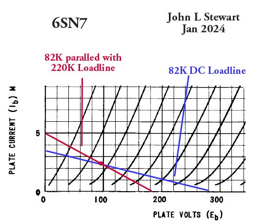

Here are the OPs loadlines on the 6SN7 on page One. Notice the available voltage swing is reduced a lot.
And the shorter distance between the grid lines to the right of the 2.7V bias is a source of
even order harmonics............ie 2H, 4H, 6H.....Etc🙂

Ok, now "dumb that down" for me to understand. And then fix it, LOL. 😀
