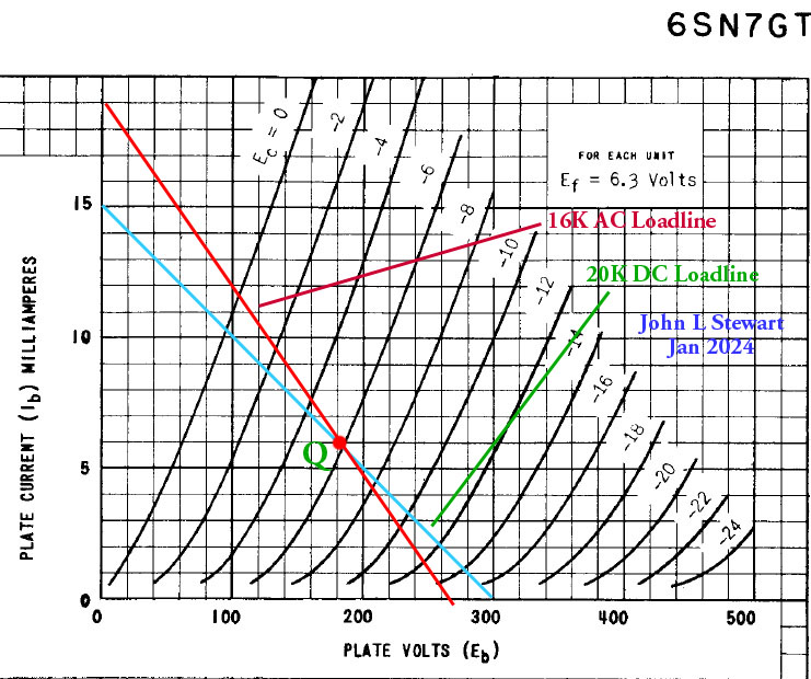

The example of RC coupling using a 6SN7 shows the difference in loadlines of AC vs DC.
People draw loadlines on tubes only to the first step, the DC conditions.
But in reality most tubes in the RC coupled circuit are driving the grid resister of the following tube thru a capacitor.
In this example a 20K plate resister drives a following grid resister of 80K. That all looks like 16K.
The result is the usable voltage swing available on the AC loadline is less than the simple DC loadline would have us believe.
I've picked an extreme case, in the next exciting episode I'll show how to fix that, 👍

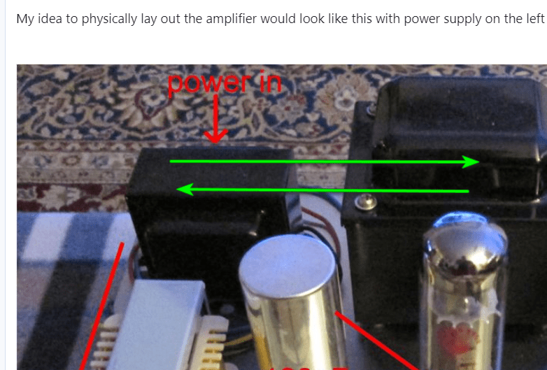

I don't know if it has been mentioned already, but if it was me, I would promptly shift the power transformer and the left output transformer's positions, according to the green arrows below :
So you would have really ALL the supply at the left...
But it's me, OK ? 😉
Aw ! Sorry : the chassis is probably already punched and drilled... Too bad ! 😕

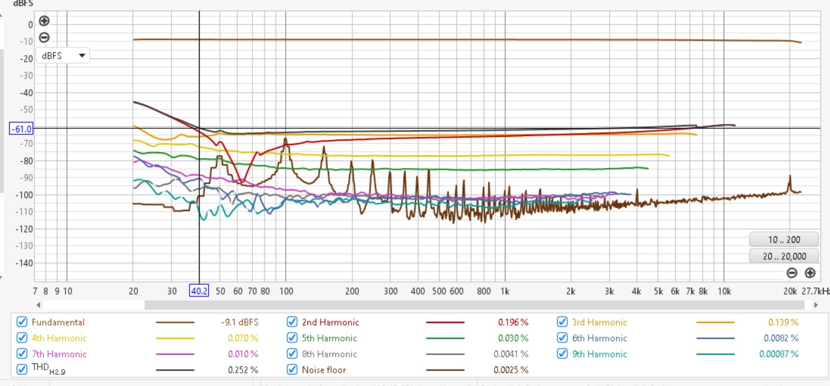

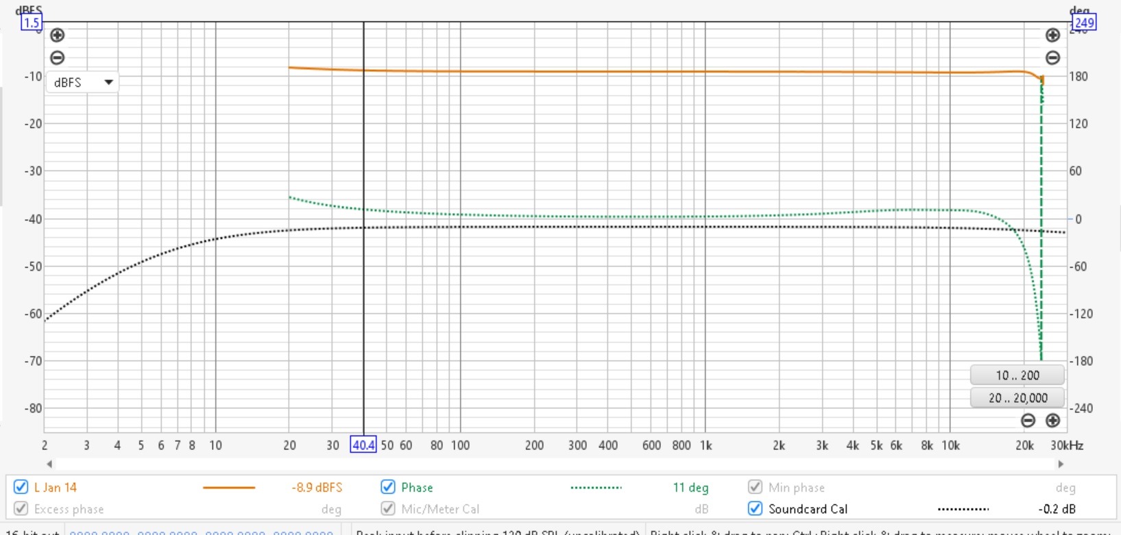

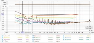

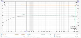

I rechecked my Oriental SE amp. (1, 6SN7GT per channel in cascode configuration, 1, El34/KT77 output, 8r resistive load)
You can see how the low frequency phase and distortion results are not brilliant below about 40Hz.
My OTPs look about the size of the OP's.
