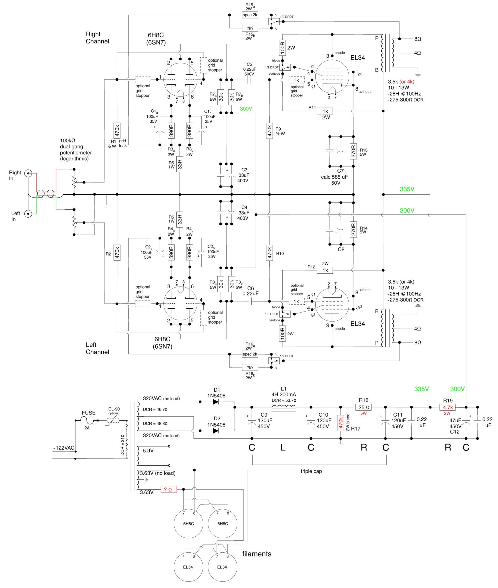

stephe is showcasing a perfectly stable and robust design on her Skunkie Designs YouTube channel, SE EL34s
That's @stephe personal design, with a special driver tube and special Schade feedback, and she chose UL, and she did all of the research and design and testing, and she is planning to sell it, and I don't want to modify it. It's her design and her property and I respect that.

Single-Ended amps are so simple, this thing will work if it's wired correctly, even if it's not the "best sound ever." Check @Suncalc's 6L6 Spotted Alder amp, it's a pair of 6L6 driven by a single octal tube, almost exactly what you're going after. 6SN7 might need a preamp to fully drive the output, 6SL7 if you don't want use a preamp.
Matt likes the U/L but all you've gotta do is add one more filter stage in the power supply, to create a node for the screen supply. Try to get those screens ~10v lower than the plates. Guess you'd want some NFB too.

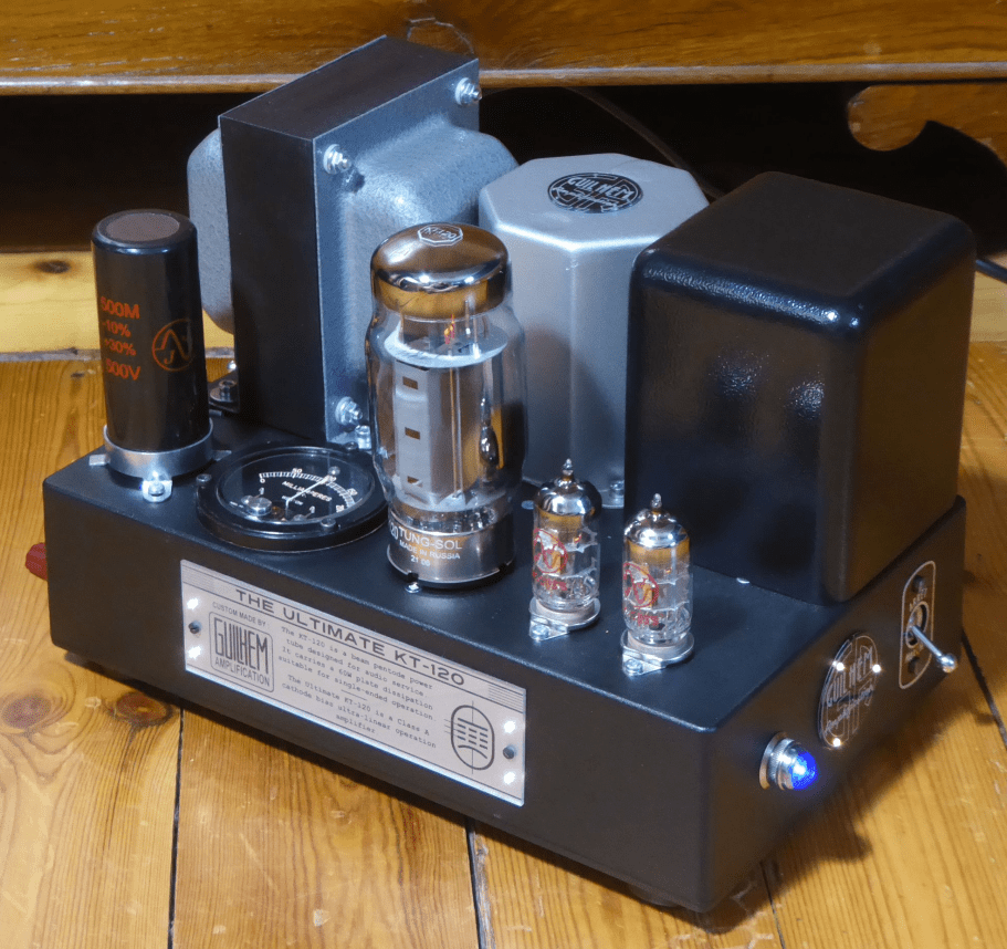

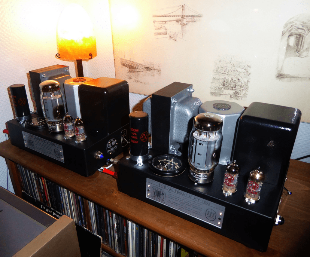

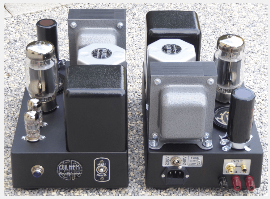

Yes indeed. Well, it's nonetheless possible to build a good sounding SE amps, even if not with Triodes...
Below my U-KT120 uses two // 12AX7 in SRPP configuration as the preamp stage, and one KT120 in cathode bias, Ultra-Linear connection for the output stage.
The specs are :
The specs are :
- nominal power output 12.5WRMS 8R @440hz sinus.
- input sensivity = 0.8VRMS @10.00V output (12.5W).
- bandwidth @12.5WRMS : 10Hz-40kHz@-3dB, 16Hz-23kHz@-1dB
- bandwidth @1.0WRMS : 4Hz-42kHz@-3dB, 7Hz-24kHz@-1dB
- 6dB feedback loop (fine-tunable for calibrating input gain at 800mV ---> 10.00V output).
Sorry, no THD% measurement for the moment, my PC gear being obsolete awaits replacement...

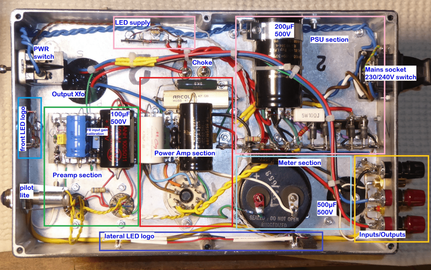

Very nice. Do you have a schematic? You have 2 preamp tubes - do you run one SRPP into the other?
Thanks folks. I'm going to do as I said and put it on the shelf for future use. I have some specific ideas that I wanted to test, and I don't yet have the knowledge, skills, and ability to do so. I'll keep learning and maybe come back to it one day. I may look into some test equipment.
That's interesting. I'll save that link and schematic. Thanks. He also gives a detailed explanation of everything and calculation examples, which is exactly what I need at this point. I learn best by being given examples and detailed explanations with them, as he has done. Others learn better by doing and making mistakes and correcting them.
Thanks @dubadub ! 🙂
No : it is a SRPP single stage preamp, with one // 12AX7 as upper tube, and one // 12AX7 as lower tube. The gain remains the same (or just a bit higher) as a single SRPP tube, but the driving impedance is divided by 2.
