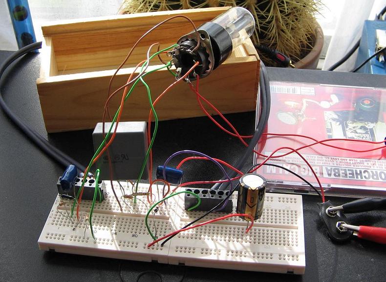

I have made a very rough and ready single channel prototype of Alastair's circuit. At first there was quite a bit of distortion but changing R1 to ~2KOhms sorted that out. I only had ten minutes to listen to it but first impressions are very good.
It works perfectly adequately from 12Volts with a 6SN7. No distortion. 24Volts did seem to give more body to the sound but I haven't had the time (without inquisitive rugrats) for critical tests. That will come later tonight!
I have a couple of questions though:
What influences the capacitor choice in the circuit? Can I just use anything over 1 or 2 uF as long as bass doesn't suffer?
"gain-stage Anode-resistor" & "cathode-resistor".
Could someone point these out on the schematic? I do feel silly for asking.

The Anode resistor in the 'gain-stage', is R3, in the scheme, is 10K To Increase the 'gain' Increase this by a few K. The Cathode-resistor in the same stage you have altered already to 2.2K, which has lowered the gain, by increasing 'local' FB.--As I believe the input to the pre-amp you have may be quite high, and instead of altering this value from 1.5K, to 2.2K you could increase the supply by a couple of volts, to give you a little more headroom.
Alternatively, you could-- instead of both cathode-resistors going directly to earth, remove their 'earthy ends', connect them together, and connect them both to the Neg terminal of a 9V battery...PP3 type is good, The Pos. terminal then goes to the earth connection the resistors originally went to...The batt will only discharge during use when the heaters of the valve are on, so it 'could' be a semi-perminent part of the device. Current drain is only around a 1mA or so with the circuit operating, so the batt should last ages...
This will give you around 21V accross the valves, while Still using a 12V +B supply...😀
I chose the caps on the data derived from the sim-work, to give a good phase-response down to around 5Hz. As an alternative to Poly-prop caps, you could use leccylytics. The caps will affect the bass response if they are too small, but anything above around .47uF should give a fair response at low frequencies..

Thanks for the very helpful reply. I've breadboarded two channels of your circuit. I must say that I agree with you that the 6SL7 sounds worse than the 6SN7. I really enjoyed the sound from the 6SN7 (in mono) but the 6SL7 (stereo) sounds spitty and harsh and the bass is anaemic even with 24V. Some of the issues may be due to the caps that I'm using but I've spent far too long trying to make the 6SL7's sound 'good'. Lowering the gain dramatically doesn't seem to help either.
I'll have to get hold of a pair of 6SN7 and then tweak to suit my system.
In the meantime I think I'll try a similar circuit for a guitar pre/overdrive. I 've really got the bug for low voltage valve stuff.
BTW: I love the 9V battery idea! Ingenious! 😉 I'll try that soon.

So, what would be the best way to convert this circuit to a Hifi preamp with volume control? Just slap a regular 'pot to ground' in front of the whole thing or before the cathode follower?
I'm also keen to try this as an instrument preamp mainly with guitar and keyboards. Could I use a pot to control the gain and should I simply vary R3 or perhaps R1. R1 seems safer and more logical to me but I'm not sure. I'd like to overdrive it a bit as well.
Anyway, Thanks again to everyone here and especially Alastair. I'll be doing some further testing tonight when it's quiet around here and I'll report back.
Martin. 😀
