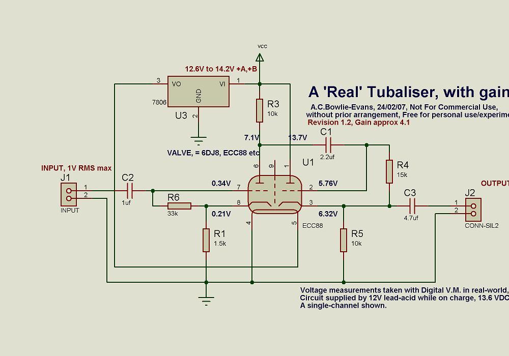

Im afraid The published schematic as you see it on the previous page is all there is--Like most things, its a work in progress and alterations are being done already, to suit my own use for it....
Adapt and modify it for your own needs, Duplicate it for a second-channel etc.etc. I cannot design it for you, as I dont even know to what use you are to put it! Use a 6V 1A linear volt-reg for the 6V heater of the valve. A single 6DJ8 consumes around 300mA so a 1A reg will supply both valve heaters. a single 7586 Nuvistor heater consumes around 130mA
The Anode-current is around half a milliamp per triode (600-700uA) so not even worth mentioning after the heater...
Use a valve such as the 6DJ8 5687 or any medium Mu triode/double-triode--You have Loads to choose from and experiment with....
Do what they used to do years ago with valves in harsh environments and car radios and use a shock absorbing frame/box/mountings, holding/containing the valves...
A tip--- Russian Nuvistors are far superior to American nuvistors with regards microphonics etc, and tend to be cheaper too.......
There isnt much on the 'web it seems about running 'Standard' type valves at low-voltage. There are some valves that were made specifically for low-volts, but could be hard to come by...

It would definately improve the headroom, but as designed, I taylored it for a supply of just 12V.....
Ive not tried it at higher +B yet, Something I could try is say, 24V Easy enough, I have a couple of SLA's....
All the valves Ive mentioned are reasonably easy to come by, so no probems there either--They are just the 'usual-suspects' in valve audio.....
I did a quick Simulator test for the 6DJ8/ECC88 at 24V and at 36V, The current through the valve increases to a little over 1 mA for each triode half and nearly 2 mA at 36V...All to the good. At 36V it needs a 3V RMS (Approx 9V P-P) signal to drive it to clipping, at a voltage output of just under 35VP-P--Doubt that as a 'line-amp' you would ever get near that level!...

I just tried the scheme as drawn on 24V. Apart from a slight increase in gain, there was no other apparent audible effect. As another contributor here said, this is due to the large amount of Local Neg feedback in each stage. (The grid-resistor returned to the Cathode rather than deck, and a fairly large cathode resistor in the gain stage...)
The available Headroom at 24V is of course doubled, great if you have 24V supplies commonly found in SS amps, and fancy adding a little valve pre-amp to....

Im glad it turned up in one-piece and does help out the issue, but there is obviously still something serious wrong.....😱
As a test, remove the two grid-resistors, and place them between pins 1-3 and 4-6. of the valve......
IF your second diagram IS correct, these resistors are effectively going to no-where DC wise....They are De-Coupled by an elect. cap back to the neg line, hence no DC route to neg line, so little or no grid-leak, apart from that through an electrolytic cap....
Placing them directly at the valve-pins will at least give the valve some grid-bias, as well as neg-feedback to help out with the distortion, and is the way that the 'cathode-follower' stage works in my 'tubaliser' diagram I posted earlier...
It may be worth lowering the value to around 33K as well, maybe lower, for best operation--Dont worry about the input-impedance, as when connected this way, they are 'bootstrapped' so will not present their real value to the input, The value 'seen' at the input will be an order of magnitude higher.....😀
Alternatively, you could 'knock-up' that version of the tubaliser that I posted, using whatever old parts and junk you have around just to confirm to yourself that a valve will work at very low volts. It might be a fun way to start out
Octal valve-sockets are often used for relays and the like, You should be able to find one fairly easily Try an electrical-factors, the sort of place that supplies the electricians in your area ....Very old electromechanical fruit machines have loads of plug-in 50V relays and loads of octal-sockets......

I was just sitting here and making plans to raise the B+ and remove the reg from the board to enable this. You have just given me another option. 😀
I'll be back soon with the results!
I am already collecting the parts. 😉 I can't wait. But, what's the difference between international, British and Mazda octal sockets?
I suspect that only Mazda sockets are unsuitable for regular valves but am not entirely sure. Can anyone put me out of my misery?
Alastair E said:Alternatively, you could 'knock-up' that version of the tubaliser that I posted, using whatever old parts and junk you have around just to confirm to yourself that a valve will work at very low volts. It might be a fun way to start out
Octal valve-sockets are often used for relays and the like, You should be able to find one fairly easily Try an electrical-factors, the sort of place that supplies the electricians in your area ....Very old electromechanical fruit machines have loads of plug-in 50V relays and loads of octal-sockets......![]()
