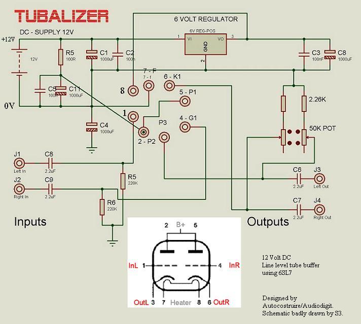

Thanks to everyone for your help so far.
I have draughted a schematic. It needs a lot of tidying up and a proper tube diagram in the middle instead of the pins but I thought that I'd throw this out there for an initial response.
The values are a little hard to read at the moment. Sorry.
I will add a final and more legible version soon...........
Any hints as to how this thing is working and also what the fault could be?
Martin.
Edit: Please ignore the polarity of the electrolytic caps if I have got them reversed by mistake!! (It's very late here.)

Hi Sonusthree ,
Anything wrong with your schematics !!!
The 6 Volts regulator’s ground , NEEDS to be
connected to the ground , if not , the regulator
will “float” and the output will not be 6 Volts .
Pin 2 and pin 5 are tied to ..... ???
Please , verify all stuff again . Thanks .
Carlos

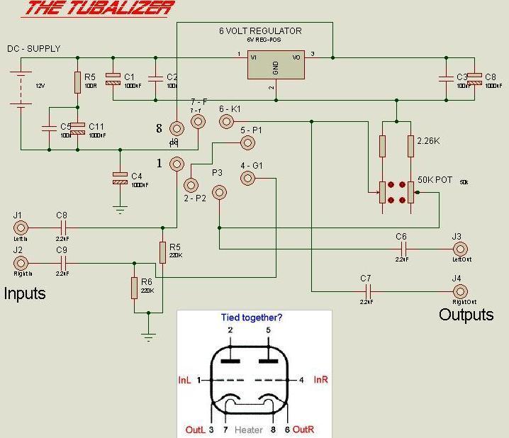

Sonusthree said:Darn it!! I need to check where the B+ is coming from but I would assume it's simply the full 12 Volts.
Sorry for the silly mistakes but it was very late when I finished it and I am still learning all the time. 😉refference said:The 6 Volts regulator’s ground , NEEDS to be
connected to the ground ...............
Pin 2 and pin 5 are tied to ..... ???.
Here is the revised schematic. There may still be some errors but I think it is correct now.
Martin.
Hmm, Looks like a pair of cathode-followers, with a variable cathode load....
Varying the cathode-load will change the op. point and also increase/decrease its distortion and out-put impedance I believe....

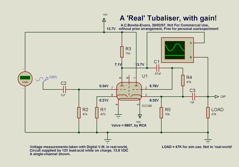

Out of interest and because of this thread, Ive delved into low volts tube stuff and come up with a scheme Ill post later..At work currently, nothing interesting here!
Ive chosen a different valve to your 6SL7g/gt, Ive used the cheap and chearful computer triode 5687, which is a very popular pre-amp driver and has developed quite a following in the DIY 'scene'...
I chose this as it has a 6 and 12V heater option and very high 'pervayence' My little experiment has a gain-stage followed by cathode-follower O/P.-- Works well providing you keep its input below 800mV P-P or it will clip, otherwise its sound is fairly neutral.--It has a gain of around 10 ish, currently...
The Tubaliser scheme will have a negative gain of around .8 ish....
If I get the time, Ill play with the 6SL7 in the same scheme and tweak values to suit...
For the purposes of your 'Simulation' work, choose the ECC83 or 12AX7 in Proteus, while not the same as the SL7 its similar enough to work out whats happening, seeing you have such a 'drastic' fault...
I used the ECC88 for my 'sim' work in Proteus before building the breadboard with the 5687. It was similar enough at low volts to work out OK...

Looked at your scheme again having delved into my own experiments....I was going to try a 6SL7 and 6SN7 in my scheme to see what would happen, but my soldering-iron has quit this life...Typical!
The 'Grid-Bias' resistors in your machine are 220K....
Ive found that at low volts, that the grid-bias resistors need to be below 100K for a good op point. I settled for 47K in my experiments.
Usual values for 'Normal' high-volts operation are around 1 to 2 Meg-Ohms...
The Proteus simulator will still 'say' it works without the grid-resistors in place, but it won't in the real-world, so treat everything in the sim with a little contempt........
If you increase the cathode-load resistance as you plan, this will reduce the amount of available current through the valve, ....At 12V, this is really a very tiny current already....
In my set-up, its just a couple of hundred Micro-amps, and that is with a valve that has comparatively Massive cathodes in comparison to the SL7, so huge area for electron-emission!....
With a 6SL7, and above 50 odd K cathode-load, I would be surprised if you got a few tens of micro-amps Your O/P impedance will also increase if you add resistance here-Not so good, H/F response could well suffer ...
Instead of adding resistance there, try putting a couple of 100K resistors accross the original 220K R6 and R5 grid-resistors rather than increasing the cathode-load. These resistors are'nt 'bootstrapped', as in my layout so will affect the input impedance a little but shouldnt be noticable unless you have a very high O/P impedance of your source-device (Very unlikely!)
If this helps, try going lower, say down to 60 odd K....At least this will increase the current through the valve without increasing its O/P impedance. The cathode voltage can be measured which will give you an idea of the current flow.......
Even if you were to place a short here, at 12V you wont damage the valve, as its normal HV operation it passes around 2-3mA...You will not get anywhere near that amount of current at 12V, so feel free to mess around there all you like!
Right, Now Im gonna try and copy out the scheme of my 12V amp and post it here... Ill add real-world voltage values at various places for interest--Im currently playing the TV sound through this bread-board and my OTL.....

More confusion!
This tubaliser thing Must work, or they wouldnt sell the thing....
The more I look, think and sim out (Even more confusing as its not really 'right' in Proteus for valves it seems...) the more i come to the conclusion that the SL7 Isnt really suitable...But they sell it With a SL7, so it must work with it....
Will get new iron tomorrow, and hopefully play tomorrow night....

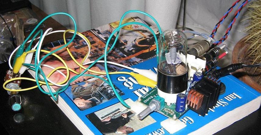

It's hooked up to my soundcard now and I'm going to mess around for a while and see what I can do.
Thanks for posting your version of the Tubalizer Alastair. It's really helping my mood right now.
Who needs gain anyway?

Hi Martin,
the 'Voltmeter' in the scheme was part of the 'simulator' and is just a graphic, as is the 'scope. It doesnt actually read a voltage untill you run the simulator, and ask it to where it then opens a dialog box with the true readings in.--Same with the 'scope, untill you run the sim, its just a graphic........
One thing that did occur to me, is that the device/amp you are playing this thing into could have an unusually low I/P impedance which could be loading the valve too much...Just a wild stab in the dark....
Even in my breadboard using the 5687, I only pass 470 odd Micro-amps through the gain stage, and 600 odd through the follower, I guess the SL7 would be less by a factor of ten...Not much current to load down!
I know some sound-cards have rediulously low I/P impedances especially on their 'mic' sockets, due to the 'phantom' suppy rail for electret type mics...
One thing that I really quite like about this Low Voltage valve experiments, is you can use any old parts culled out of equipment or 'Scratch-Box' and not worry about its voltage-rating....No Need for special high-voltage poly-props or leccys, just about any old parts will work for experimenting!😀

More info....
Got a new iron and soldered in a nice Octal socket accross the 9 pin in there....
Interesting findings with a variety of different types...
First, a 6SL7GTB, Geny elect. make, coin base from mid 80's....
Wont work at all, The cathode-follower stage shows some life, but nothing from the gain-stage...(Not sure why, it works just fine at proper voltages.....)
Second, a Russian 6H9C (6SL7 clone) from the mid 70's
This valve does work, but with audible distortion. There is only .7V accross the cathode follower resistor....
Next, a 15-79 (Another Russian SL7 clone for heavy duty use allegedly)
This valve worked better than the 'standard' Russian SL7, but still had audible distortion. There is .8V accross the cathode resistor
Last of my '6SL7' types, a Sylvania 6SL7G from 1943 JAN stock,
This valve worked the best of the SL7 types, but still had some audible distortion noticable in places.....
Next, I tried a 6H8S (A Russian 6SN7 clone) This performed very well with no noticable distortion, good deep bass and clear defined top.
There was 4V accross the cathode-follower resistor with this valve, indicating much higher current flow through the valve.
Now to the 9 pin types....
First we know, the 5687 works well...
Next, a S/H Philips 6DJ8, This worked extremely well almost indistinguisable from the 5687. Not much surprise there, as the current through it was only just a little less than the 5687.
Next, a Mazda 6/30L2 This also performed pretty well, but seemed to 'lack' something....The current through it was also slightly lower than the 6DJ8, by a volt or so accross the resistor at 5V.....
A 12AT7 was tried, but didnt sound very good at all, similar readings and distortion to the SL7 valves, ....
A 6H2P-EB (Russian 12AT7 type, ish) This performed better than the 12AT7, but showed its limited current pass on 'loud' sections..
Im currently running the Octal 6SN7 Russian valve, which is performing pretty well considering!
I did no circuit or value alterations during this testing, I just changed the valves, everything else stayed the same......
From the above experiments, I would suggest that you try a 6SN7 type, direct replacement for the current 6SL7 in your device....
I think it Could cure your issues....

If you Email your address, I can send you a Russian 6SN7, all I ask is that you tell me the results of the test--I have a fair number Ive used over the years for testing Most have only a handfull of hours on them, Just nicely 'Run-In'....
You may well need to add a larger heatsink to the volt-reg, as the SN7 has a higher heater-current than the SL7. Im using a standard 6V 1A reg on a small heatsink from a comp. PSU which is working fairly well in the B.B.
You may need to increase the GB res, back up to say 47K, Something that can only be done in your set-up...Worth trying anyway...
It doesnt really surprise me that the values ended up at 4.7K, It seems you need a very low GB value for any current flow at all at these low +B values...!
