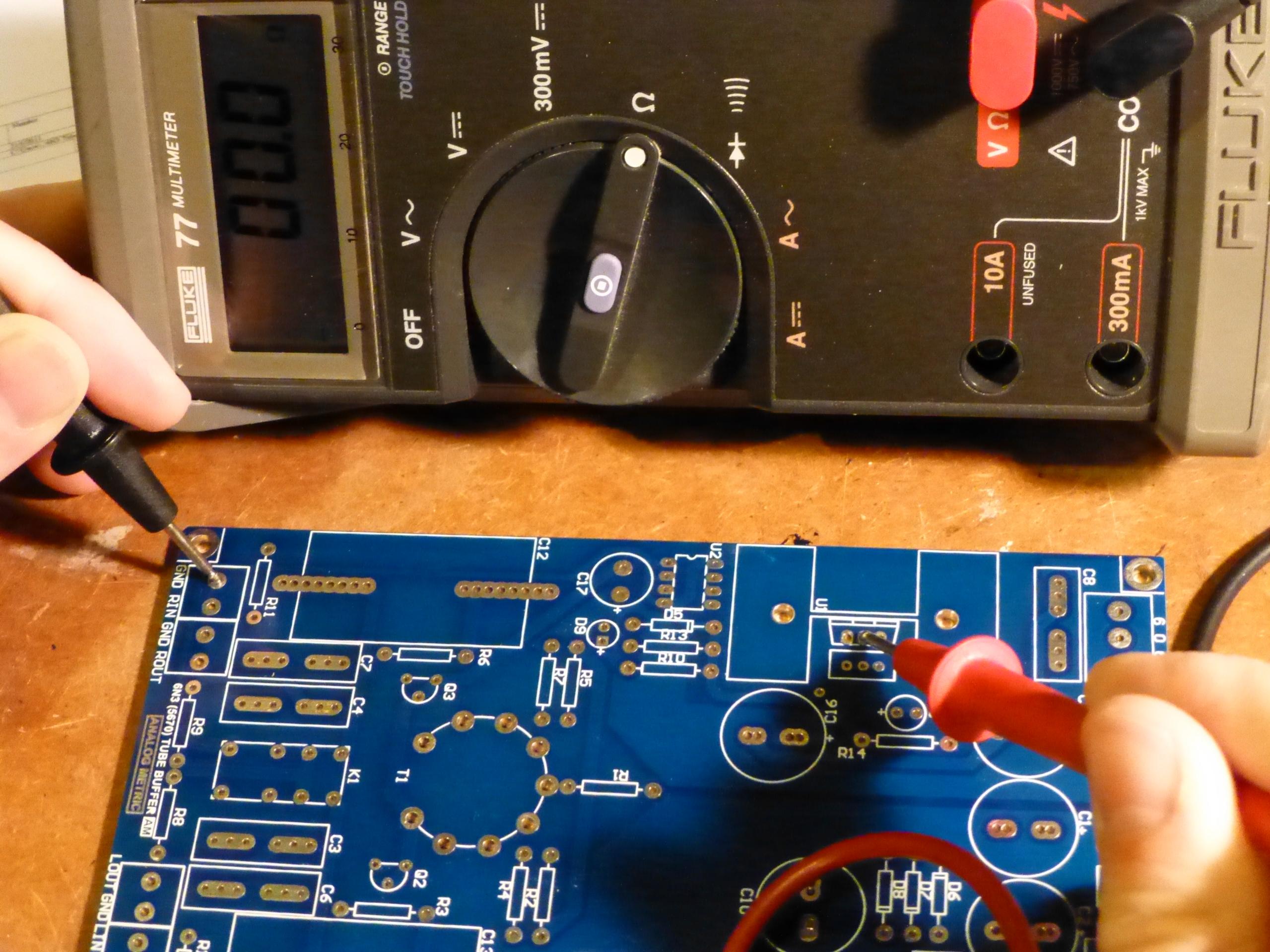

Detailed of the Issue
Thank you for the responses, but I believe that I need to be clearer about the issue.
In the attached photo I am probing from pin 2 on the regulator (the output) to the ground pin on the right input.
Note that the meter is reading zero ohms meaning, and I followed the traces to be sure, that, as shown in the schematic, the regulator output is shorted to ground.
Hence, I am not surprised that there was a response that the regulator runs very hot.
It's likely pumping out large amounts of current trying to drive ground to the filament voltage, although I am not sure what resistance it's working against
In fact, I am surprised that the circuit works at all if people are connecting ground to the signal input and output ports!
Are people not making those connections?
I have identified some judicious cutting and pasting that could be done to elevate the short and allow connection to the input/output grounds.
However, before posting that I would be interested in knowing if there is anyone out there that has an assembled board that might be willing to make some voltage measurements and see where the doubler and PCB ground potentials sit with respect to earth ground.
Anyone game?

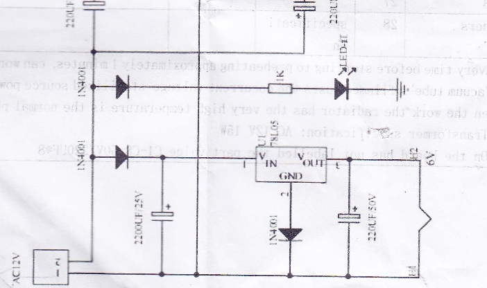

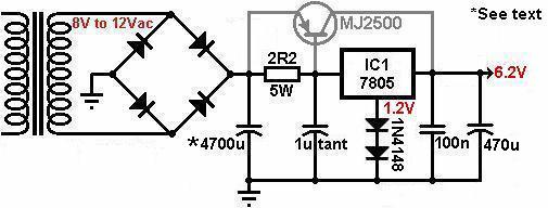

Regulator 2nd pin is grounded because its a fixed one regulator not a 317
But if you detected a short circuit may cause alarm because it is not going to deliver the normal voltages spected here if using a 7805 at least put a 7806 in there so the tube could last a bit more
Look at the pic the regulator ground was elevated so that could deliver a more common voltage to the heaters (but I would triple check the PCB for security)
A more acurate design but with 2 diodes instead of one, the upper pic also its miss calculated giving a lowish 5.6 -5.7 volts

There really is a problem!
Thank you maton00 for the regulator and diode idea.
That is clever and I will have to try it.
However, the seller got back to me and admitted that the PCB is laid out incorrectly.
He suggested a three cut and three jumper correction.
The pictures he sent are attached, but I am only able to see two cuts and three jumpers.
Anybody see the third cut?
