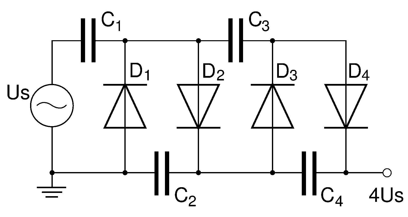

I'm still wondering if I could just bypass the step up circuit and give the tube 110v from a 12v inverter?

I'm going to tie the left out into the right in, bridging the amp for mono so that i can use it as a guitar preamp...
I still plan on bypassing the step up and just using 110v. for the plates from a cheap DC-AC inverter...

So, I just got done putting my 3rd one together and I used the bridge idea...doesn't work. I think that it's oscillating. Tonight I'll take it back down and undo the bridge and see if I can't get something better out of it..

I don't think so. If you examine the schematic, you'll notice that there is a gain of.....wait for it......ZERO. THis is a cathode follower and doesn't produce any gain what so ever. I found that you absolutely have to use a transformer, not a wall-wart. The heaters need to run on AC power, not DC...Plus it does go up after you rectify it...
