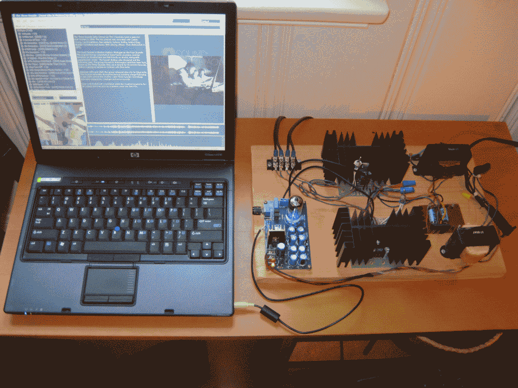

I bought two of these and like them. I use one as an input stage to a pair of monoblock LM3886 chip amps, the other is a spare. The combo sounds quite nice. The only available schematic – the one that was posted here earlier -- is from an earlier revision. So, if anyone has a current schematic that’d be nice. I made the following revisions:
1. Swapped out all the caps in the power supply, nine 220uf and one 2200uf, with better quality caps.
2. Removed the caps from the input.
3. Subbed the regulator for a 7806.
4. Added some resistance in series with the LED illuminating the tube. (I like the effect, but it was too bright.)
I sort of hate the power supplies and the chip amp uses a compatible bipolar supply, so I am going to replicate just the buffer amp part of the circuit. I’ll power it with the chip amp supply and a filament transformer and wrap the whole thing up into a nice package.
Attached is a pic of my breadboard:

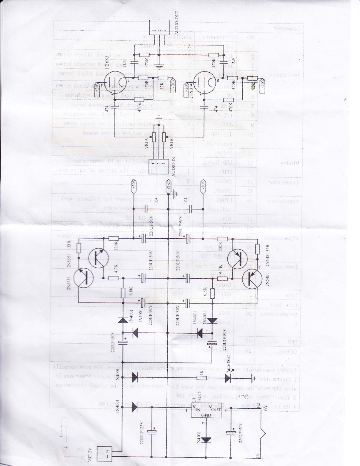

This little amp project is pretty strange. Being unity gain, it certainly shouldn't have any hum/noise problems from the filament, so running a 12 V tube right off the transformer (with a series resistor if it puts out a little too much) would seem to make more sense.
Some with access to thrift stores may find discarded 12V to cell-phone adaptors for the car for little or nothing. They contain a little step-down switching regulator that typically puts out about 3.6V. Change the feedback resistor and make the output 6 or whatever for a preamp tube. It'll take the rectifer 18 VDC or whatever is there and draw much LESS current than the tube filament does keeping things cool and minimizing the load on the little transformer.
I wouldn't expect a cathode follower to give much of a "tube" sound. Also, with low supply voltages and the fairly large 12K resistor in there, it won't be much good for higher current loads (like 600 Ohm headphones??). So as-is, I'm not sure I see the point of the circuit. I suppose a high-impedance input might be needed if one had one of the older tube-style tone-control network with really high resistances right ahead of it, but it would seem unlikely to have that outside of tube gear that already has a power supply.
If one wants a little stage with some gain or even distortion, it would probably work much better to move the 12K resistors to be in series with the plates, and take the outputs from the plate (through caps of course, + side to plate if polarized). And the spot where the 12K's are now would just be jumpered. there's already a bias resistor so the triodes should be happy.
Using a single supply with that multiplier makes more sense if only running these triodes (couldn't introduce noise between cathode and grid then), but the supply shown would be good for powering op-amps. Note that it isn't a regulator. The first transistor basically buffers the voltage on the filter cap at its base. If the beta is 50, it's like having a cap 50 times bigger as a filter. The ripple would be reduced by that factor. It would not provide teh ability to deliver surges of 50 times the current however.
The second transistor is a current limiter. When the current through the base-emitter resistor is enough to develop around .67 Volt, the transistor conducts robbing base drive from the other transistor, reducing output as needed to limit the current. I'm guessing someone copied that circuit from somewhere. There's really no need for a current limiter in the supply for a simple preamp, but it could be handy for other uses. If not needed, omit that transistor and just short the points where the 33 and 330 Ohm resistors are.
There is no need for a big capacitor at the output of the 5V regulator. Just a .1uF disc or so to prevent oscillation is fine. Some might like to simplify the circuit by using the LED instead of the 1N4007 on the ground pin of the regulator. That should boost the output of the regulator by about 1.6 V. A resistor from the output to ground pins of the regulator can increase the LED current. 510 Ohms would add about 10 mA to the tiny current that comes through the regulator ground pin.
A way to get totally "free power for the LED: the LED and series resistor could instead be added between the 3-terminal regulator input and output pins. Then the current drawn by the LED would reduce the current through the regulator by the same amount. (not that 10 or 20 mA would make it much cooler when running a 300 mA filament)

Does yours have this schematic?
This circuit does have poor quality problems, but hum isn't one of its problems.

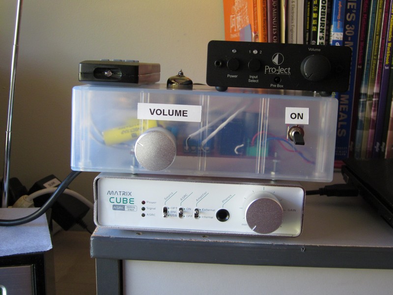

I also bought this pre-amplifier to experiment, I found it to be quite good, my take and mods are:
1. change the input caps, to film type Wima, 0.1uF
2. change the output caps to polypropylene, 1.0uF Kimber caps
both of which are left overs from my past projects.
Also I have a commercial preamp, Project retail price at $300 with 8.6dB gain, based on IC's. I think this preamp out performs the Project amp. This cheap preamp presents a wide and bigger sound stage. I don't think I can hear the distortion.
The limitations of this preamps are:
1. Anode voltage is too low, about 32Vdc in my case
2. Cathode current is too low about 1mA, for driving high impedance amps
is OK.
As it is I don't think it can be improved further. My plan for enhancements are:
1. The topology remains similar with these changes,
a. 6N3 tube change to 6DJ8 set cathode current to about 6mA
b. 6DJ8 Anode voltage set at about 85Vdc
c. the cathode resistor removed, replaced it with constant current fet
2. The tube powered from 12Vdc battery with DC to DC convertor to boost it to 85Vdc
I think the above can be done. This will be my next project.
See attachment, the 6N3 pre-amp is the one in the translucent box, with the Project commercial pre-amp on top.
