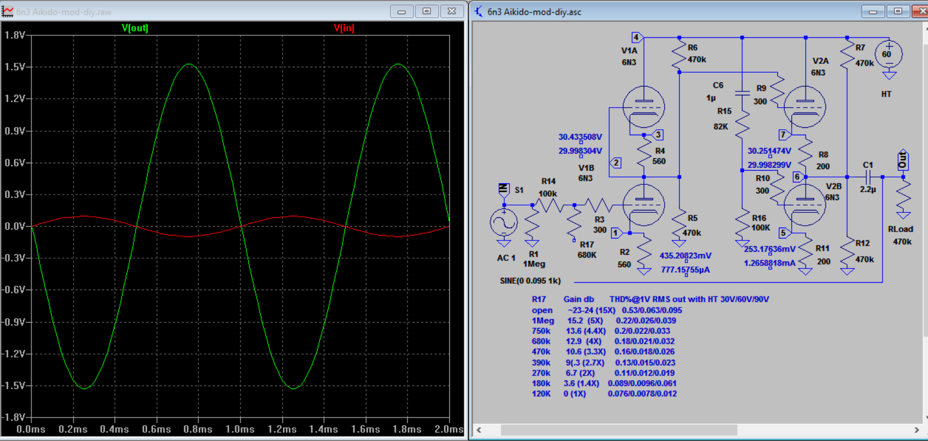

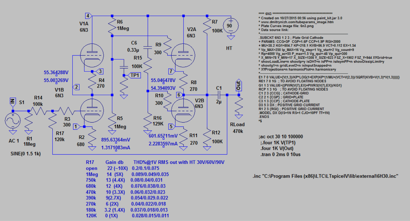

Hi, I would like to share the sim of mod with you all. The sim is done 3 times with HT 30/60/90V to gather THD% results. It appears that THD is reduced as HT goes up straight then tapper off. The input impedance is about 100K with R17 120K output impedance ~2K with larger output cap (25uf?) for 10K load and good bottom response. If you like more plots let me know.

The schematic is here:

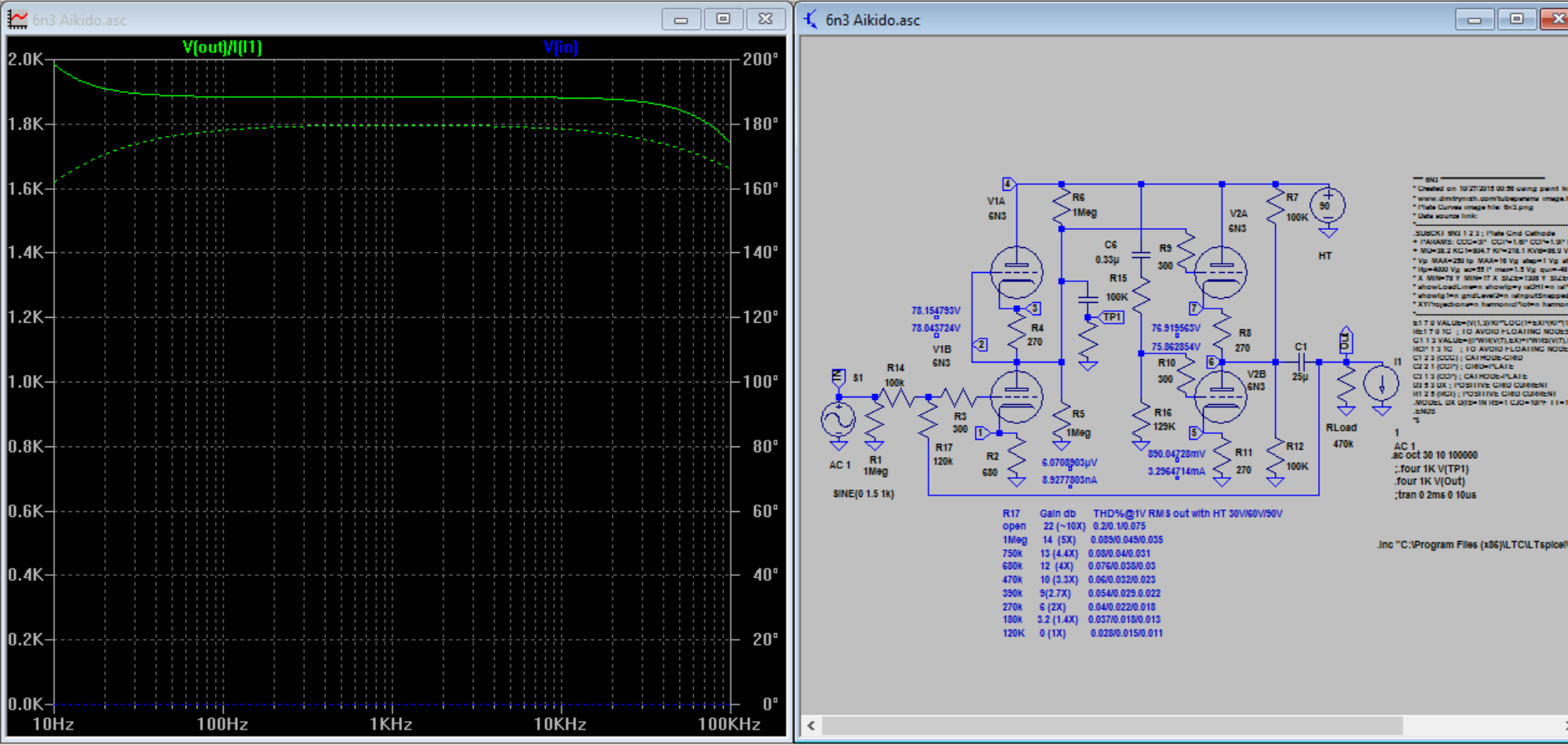

If you can help a bit with this SRPP, with distortion plots and variable gain for 6n3/GL-5670 it'll be awesome...
The original Aikido have R1-R2 with 560 Ohms and R3-R4 with 200 Ohms, from what I saw in the pictures. Gain is around 10X (20db).

Here are the results:
R17 Gain db THD%@1V RMS out with HT 30V/60V/90V
open ~23-24 (15X) 0.53/0.063/0.095
1Meg 15.2 (5X) 0.22/0.026/0.039
750k 13.6 (4.4X) 0.2/0.022/0.033
680k 12.9 (4X) 0.18/0.021/0.032
470k 10.6 (3.3X) 0.16/0.018/0.026
390k 9(.3 (2.7X) 0.13/0.015/0.023
270k 6.7 (2X) 0.11/0.012/0.019
180k 3.6 (1.4X) 0.089/0.0096/0.061
120K 0 (1X) 0.076/0.0078/0.012
Edit: 60V is way to go for lowest THD according to the sim

I'm so sorry about my confusion too.
You've already made a simulation with the standard Aikido values and I didn't notice it.
Thank you very much Koonw.

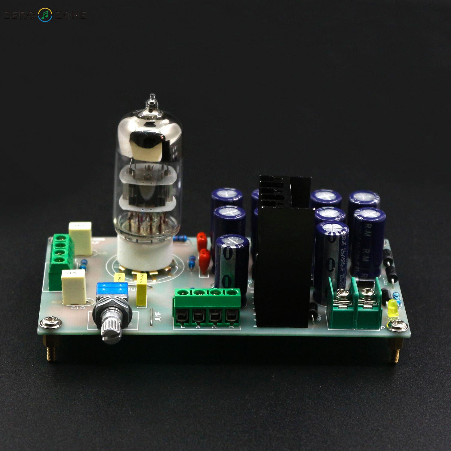

Has anyone tried the Zerozone version which claims to have fixed the voltage issues? I noticed that some of the caps are 63V suggesting they have boosted the voltages from the first design on this thread many years ago. PCB looks single sided - rubbish?

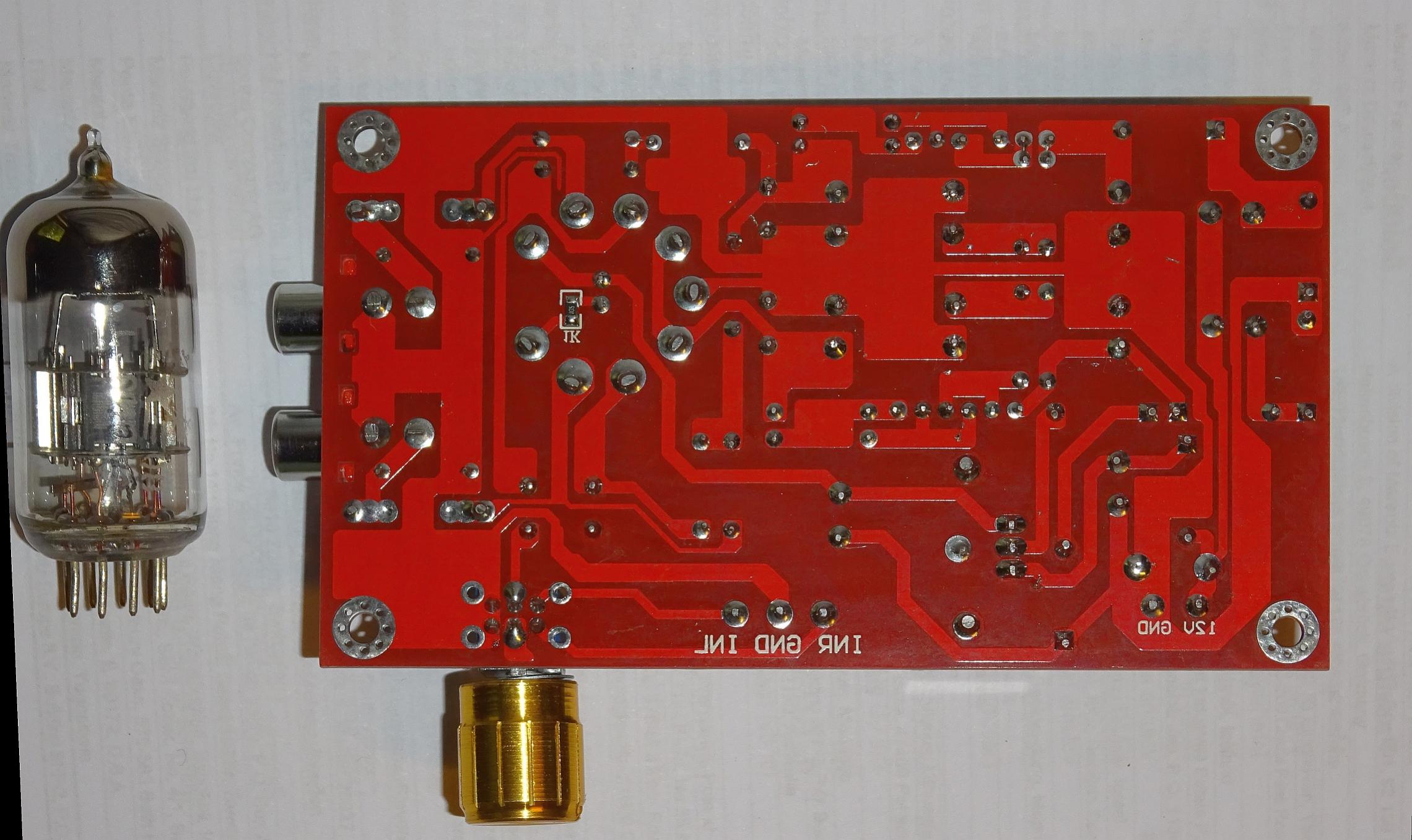

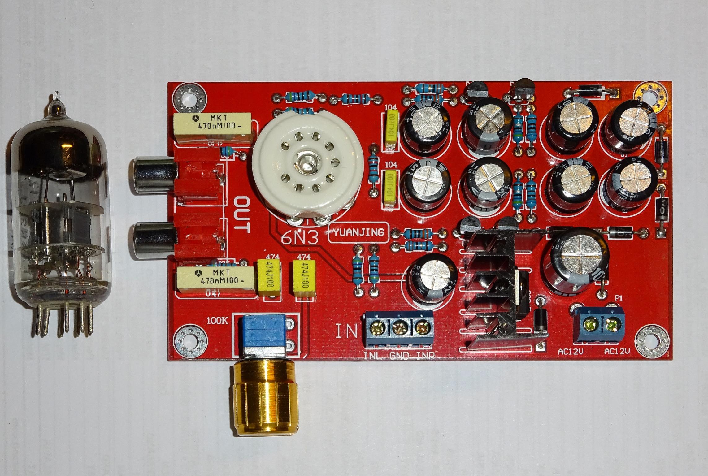

I also have a 6N3 board laying around (see photos), waiting for some time to be married to a 41Hz Amp6 and a USB DAC to make a nice PC amp.

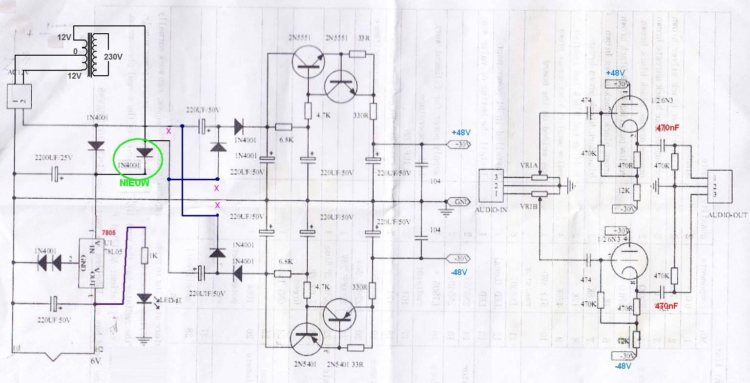

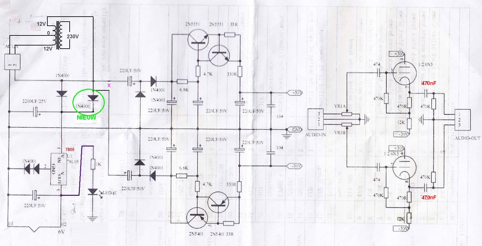

"Ah!buis", our local (dutch dyi audio forum) tube guru came with 2 simple modifications to improve the performance. The first is to use a 12-0-12 transformer, the second will increase the voltage on the tube to 48V (will require cap upgrade as well)
I have not tested it, but with my new reading glasses I should be able to see the print well enough to do the soldering 😀 I hope te find some more spare time at the end of the year to actually continue with this project

12VAC is about 17V peak. There are 2 voltage doublers (a + and a -) with the diode drops There should be about +33V and -33V, and there are 2 voltage regulators that give about +30V and -30V out. The triodes are wired as cathode followers, so the gain is less than Unity (less than 1). The voltage across the triodes are [60V - (the drop in the self bias resistor + the drop in the cathode load resistor)].

Thanks for posting the pics. I've ordered two of these out of curiosity (apparently channel separation is poor so each one will be mono). AFAICS the only difference on the ones I'm getting is that the 1n4007 diodes are now FR207 fast recovery types. The rest seems to be the same. I'll post pics when they arrive.
