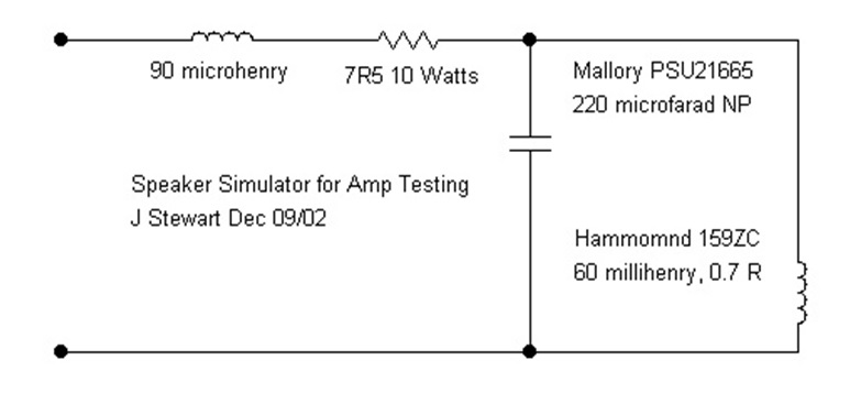

Here is mine in hardware. Used now almost 20 yrs.

Diabolical Artificer,
If you are referring to the 220uF in the schematic in Post # 62, then consider these approximations . . .
220uF is in parallel with 60uH, that is resonant at 43.8Hz, just like a woofer in a closed box.
And that is in series with 90uH (woofer voice coil inductance), and 7.5 Ohms (woofer voice coil DCR).
Did I get it right?

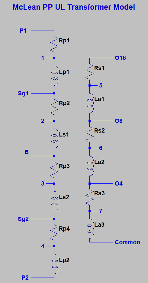

Looking at the .txt file, I'm wondering if you are missing an LP parameter for P1?
Not sure if I'm seeing this correctly, but heres' what I'm seeing. I think P1 may be missing?

No, it's there. Attached is the schematic of Robert's model with all of the implied nodes identified. The winding at P1 is modeled with Rp1 between nodes P1 and 1, and Lp1 between nodes 1 and Sg1

The biggest difference between the transformer models is the K-factor.
If you put the K-factor from Kofi Annan in 1650H.txt
i.e. KALL LP1 LS1 LS2 LP2 LA1 LA2 LA3 0.9996 (was 0.9984)
The circuit simulates correct.
I don't know which factor is the right one for the 1650H. You have to measure the transformer and match the model to your measurements.
A lower K and/or adding Cp/Cs makes the transformer worse, and thus more difficult to stabilize the complete amplifier.

OK for all using it in their Sims as I too have done. But mine is real in hdwr, on the bench & often used on real amplifiers. What's wrong with that?😀
There is nothing wrong with that, of course. But the model published in the Stereophile article is also a real construction using real resistors, capacitors, and inductors -- it's not just a SPICE model. This is probably where we are mis-communicating.
I have used a physical construction of this "speaker simulator" in amplifier bench tests. It's just a different model than the one you are using. So I think we are in general agreement that testing with a load resembling a speaker is a good thing, and that was in fact the basic premise of the Stereophile article -- real-world testing.

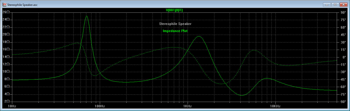

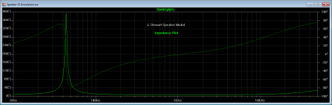

I've created a SPICE model for your circuit and have added it to my speaker library. I've also run a simulation of both models to plot their impedance over the audio band and have attached those plots here. They are quite different, so it's up to the user to decide which one they think is better for their own purposes. That's really what DIY is all about.
