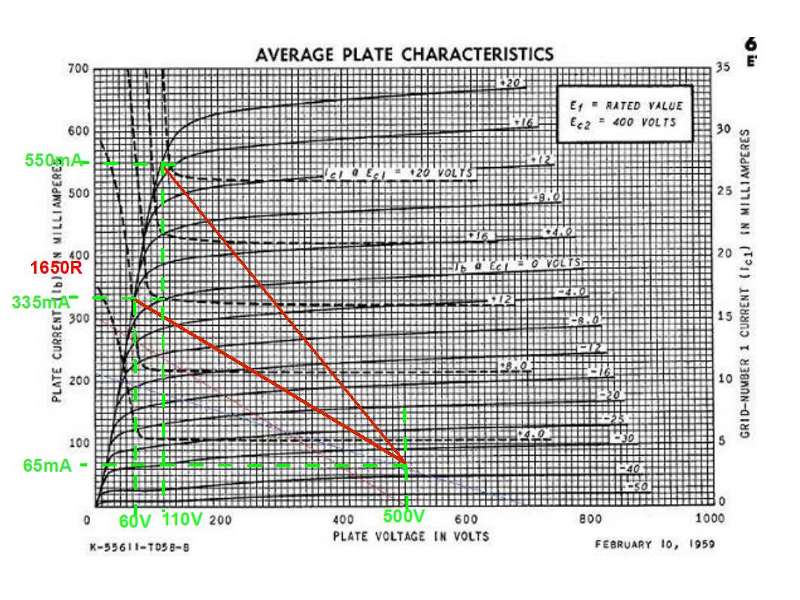

I've been playing with a pair of 807s and I thought the curves looked
familiar. Here is the chart posted earlier with 2 load lines, for 6600
plate-plate and 3300 plate-plate class B (or AB)
Solving for Po based on voltage, I get (311V RMS^2/1650 ohms) for
about 59 watts into 6600 ohms plate-plate, and (276V RMS^2/825)
ohms for about 92 watts into 3300 ohms plate-plate.
I'm calculating 160 mA average per tube at 6600 ohms and 236 mA
average per tube at 3300 ohms, based on
65mA idle + ((270 mA pk-idle)/2.83) for the 6600 ohm example
65mA idle + ((343 mA pk-idle)/2.83) for the 6600 ohm example
Does this make sense?
Michael
PS is 65mA per tube a bit high for class AB? It would extend the
class A region by quite a bit considering the 3300 ohm load line.
It looks like the 6600 ohm case doesn't get much into AB2 but
the 3300 ohm case could get 20-30 mA grid current peaks.

First, the shape of the load line is never a straight line anyway. My
avatar is a real-life load line of music playing on a SET with a loudspeaker load.
The load lines we draw on the plate curve chart are a highly
idealized thing that helps calculate the operating envelope of the
circuit. In the end it still results in a more or less linear transfer function
In this case, no matter how you get there, the end points of the
load line are as shown and the voltage, power delivered, etc. are
more or less the same as if we had taken the straight line path.
Maybe the power dissipated by the tubes is different, but the
transfer function is still more or less linear.
It's true in amp design that using a colder idle point sometimes
allows a load line with greater voltage excursion to be chosen for
more power out. It doesn't work the same the same to change
the idle current with an existing design. It does as wrenchone
says, increase the class A operating region.
Michael

The graph is a scope photo with about 50-100 mS exposure time.
The attached pdf shows how frequencies around the poles of the
loudspeaker load have elliptical load lines and how the impedance
changes for example from 60Hz to 200Hz.
The music waveforms are complex combinations of many frequencies
and trace complex paths through the operating region of the tube.
The scope display is X-Y with anode voltage on X and anode current
on Y.
For selecting the region of overlap in class AB, I think I am on the
same page. Ideally the decrease in gm of one tube will be mirrored
by an increased in gm of the other tube, and the total gm would be
more or less constant. The tube driven into increasing conduction
would be just getting into the linear region as the other tube is cut
off (or thereabouts). It's easier to visualize this on pentode curves,
where they "bunch up" at the bottom of the chart. Another technique
is to map out the composite transfer function and line up the
"hockey stick" curves so they add up to zero error (straight line)
as in RDH4 pp. 589 Fig 13.47 showing class AB biased to the point
of minimum distortion.
Michael

I am hoping that someone will indulge my lack of experience here and help me out with some advice for the power supply requirements for this amp.
I have reviewed the great advice provided in the post above by tubelab. Thanks George!
Trouble with the advice regarding a 110 x 2 isolation transformer is that that it is not easy to find one here in Australia, as we have 240 volt supply. I have managed to find a Chinese R core transformer 0-55V x 2 with two 115 volt primaries that I can wire in parallel to give a -150-0-150+ power supply. I have been looking at the Tubelab SE at the tubelab site. As I was thinking MOSFET source followers, I was looking at the "power drive" pages previously, not the TubelabSE. What I have noticed with the TubelabSE power supply is that George manages to get all of the power requirements off the one power transformer.
Tubelab SE
The tap for the positive supply for the MOSFET follower is straight from the B+. The negative supply is derived from the primaries of the power transformer. As I have plenty of spare capacity in the power transformer, could I not do the same? I have a Hammond 300BX transformer, 800 VCT 250mA (Tubelab SE uses a 550 VCT). Perhaps I could use one secondary and the centre tap if the voltage is too high. This would save expense/space/weight issues. I guess for this to work, I would have to use a MOSFET with a voltage capacity of greater that the B+ plus B- supply (400+150=55 volts). The 2SK2700 Tubelab uses would work, but difficult for me to source. I have been looking, some options I have been considering are 2SK1119 and STP2NK90Z. would these be suitable replacements?
BTW, I am planning on sticking very closely to the tubelab suggested design as in his universal board here LTP Driver PDF post
A further question... The universal driver uses a -10 volt supply for the CCS in the tail of the LTP splitter. The power transformer I have has two spare 5VCT 1.2A taps. I was planning on joining these for 10V, rectified should give 13-14 volts. Could use this raw or use a doubler cct to give more voltage and then regulate to the -10 to -20 volts required. Am I on the right track here?
Once I get the power supply issued straight in my head I will draw up a schematic of the whole amp for comments/criticism.
