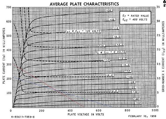

By my calculations you would get about 48 watts if you swung the plate to 0V from 500V at 60mA with zero transformer loss.
The Plate in an inductive loaded amp can approach twice the supply voltage.

Right. It should hit about 700 volts with both tubes working together (each tube seeing 3.3k) before it cuts off and the other tube takes over completely. I'm just looking at the downward (for plate voltage) travel to calculate plate current swing. See the attached load line. With 60mA bias current, total current swing (with plate hitting 0V) can be 303mA - 60mA or 243mA. P = (I^2)R or (.243/1.414)^2 * 1650 which is 48.73W. With a square wave this could be as much as .243^2 *1650 which would be 97.4W. Still, it seems like you were a lot closer to a sine wave than a square wave. This is discounting transformer losses as well
Looks like you posted while I was drawing my picture. I'll post it anyway just so others can see why I was scratching my head. 3.3k seems like a lot better load for getting max power. Positive grid voltage wouldn't even get you more power with 6.6k.

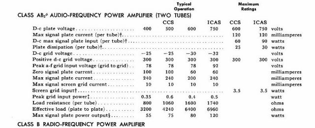

The 6L6GC is an improved version of the 6L6GB or GA and can be substituted for one. Most of us will now admit that the 807 is a repackaged 6L6GA or 6L6GB depending on when it was made, and all 807 specs apply to the 6L6GB EXCEPT for max plate voltage due to the octal versions propensity for arcing inside the base between pin 3 ans 2. So if we stay within the maximum plate voltage rating the 6L6GC can be used in 807 audio applications. Now lets look at the GE 807 data sheet under AB2 operating conditions. It is included below.
Under the column for 500 volts on the plate (only 300 on G2) you will find that they specify 75 watts of continuous (CCS) output with a 4240 ohm load. This is roughy half way between the 57 watts that I was getting with a 6600 ohm load and the 91 watts that I was getting with a 3300 ohm load. I was running 400 volts on G2 which requires a bit more bias, and allows more drive, but I believe that this may not increase the power much since going to 450 volts didn't help.
GE intended for the 807 to be capable of 75 watts with 500 volts on the plate, so there is no reason that the 6L6GC can't do the same with a similar load. Reducing the load to 6600 ohms and living with 57 watts makes life easier on the tubes. Conversely applying a 3300 ohm load and extracting 91 watts is harder on the tube, but the 6L6GC has a considerably higher plate dissipation rating than the 807.
I can not say where the load line example is wrong since the text is not readable here, except that it is a SE load line for a single tube. I went through a similar thought process a couple of years ago when I didn't believe my own numbers. I found an excel P-P load line drawing program on the web somewhere, but I can't find it now. I have also measured the peak plate voltage excursions (on sweep tubes) and found them in the 900 to 1KV range with my old 550 volt supply maxed out.

Really? I always thought that putting a load line under the knee of the curves was bad for the screen as screen current rapidly rises there.
It is really not hard for me to believe large output powers for loads less than 4.5k. I draw the load lines and all comes out okay.
No. That is my attempt at a PP load line from one tube's point of view. For a readable version of the chart see GE 6L6GC data sheet.
