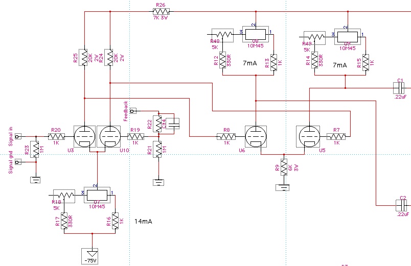

I have done that, but am a little unsure as to how to calculate the bias resistor in the tail of the diff amp (R9).
There are two variables that control the value needed for R9. They interact, so I just played "musical resistors" until I got what I wanted. The input tube has a variable CCS in its tail. It sets the tube current. The input tube current and the plate load resistor value sets the plate voltage. I would build just the first stage and get it to work first. You are looking for low distortion with a reasonably low plate voltage. The two variables are the CCS current and the plate load resistor value. I shoot for a plate voltage near 100 volts, but 6SN7's tend to want more voltage.
The plate voltage sets the grid voltage for the second stage. You will chose the desired tube current for the second stage and set the CCS's up for that much current. I have my 6GC7 set at about 7 mA each side, and I would guess that a 6SN7 would want something similar. It can be measured by connecting a current meter from the plate pin to ground without the tube in the socket. You now know the tube current. The current through the cathode resistor is 2X the individual section current, and the voltage across the resistor is close to the negative supply value plus the plate voltage from the first stage. You can calculate an approximate resistor value from these numbers. The actual resistor value will set the plate voltage on the tube since the current is forced by the CCS. Tweak the cathode resistor to get good output signal swing.
The advantage to direct coupling the two stages is the elimination of capacitors from the signal path. The disadvantages are the loss of some drive voltage potential (not important here) and the possibilities of imbalance between the two sides due to tubes with unmatched sections. I have experimented with adding trimmer pots to allow for adjustments with varying success. Any offset adjustment added to the first stage to adjust a DC offset causes an AC gain imbalance. It might be a good idea to make the second stage CCS's adjustable (like the tail CCS in the first stage) to allow for adjusting the second stage.
R11 and R10 are not needed since the grids are directly coupled to the preceeding plates.

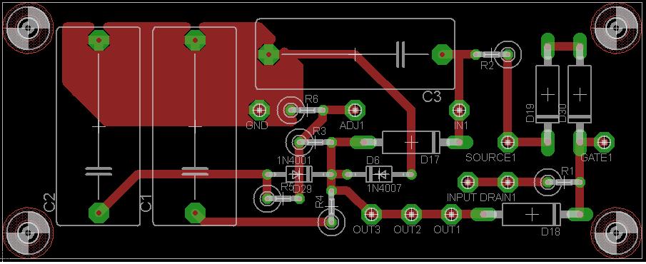

This is not required in most amplifier designs. It is a welcome addition in an amplifier design (like the Tubelab SE) where there are positive and negative supplies with resistive paths connecting them together. I ALWAYS design the negative supply to come up first (good for the tubes) but this can cause the positive supply to recieve a negative voltage before its rectifier tube is warm. This will be the case in the amplifier design discussed here.
I would be a fool not to add extra features to a board while I have the chance, especially when it doesn't make the board any bigger.
Here is the revised version:
Thanks for taking the time to post your work here SpreadSpectrum. I know that I appreciate the effort and help.
As far as having boards made is concerned, what little investigation I have done has indicated that to make just two boards is quite expensive. I was going to use your board as a template to make one with wired connections on perf board. I don't know if you are interested, but have you thought of a group buy, or even if you are getting some done, would you be interested in spreading the cost a little by letting me in on your buy? I won't be offended if is to much hassle...

I was just about to suggest a group buy too...
It may be possible to get a inexpensive run of boards from Advanced Circuits ? They have a bare bones option that produces a minimal PCB.
I've used Advanced circuits several times, I try to stay away from them for boards that have more than two layers, since I've seen them come back with opens/shorts even with electrical test.
The nice part of using them is that you can submit your gerbers to freedfm.com and they will analyze your design and send you a report along with a quote. It's all automated so you can fix-resubmit-fix until you have a design that meets all their rules.
Also, their pricing (like most PCB vendors) is based on FR4 square inches so if you look carefully at the quote, you can maximize the number of boards you get for the same cost - until you roll over to a new panel.
An example would be a small board that I designed (CMOS sensor) that was a little more than 1" square. Buying 5 of them cost say $500, but buying 25 was only $600.
If you go this route, post the link you get for the quote, and I'll be happy to take a look.
Bare bones PCB from Advanced Circuits was going to be my first choice. Who needs a solder mask?
I wouldn't be opposed to adding some others onto my order to spread the cost around. Here's the catch: I am not going to have this board made. I am going to have a version made with two Maida regs on it. My amp needs five regulated voltages so I want to consolidate a bit. All boards in my amp are going to be 3"x 4" so that holes line up and boards can be stacked.
I am also making a digital volume control board based on DS1882 with BJT cascode current sinks for LTPs also on the board. Another one on deck is a microntroller power sequencer that also monitors cathode currents and shuts the amp down if output tubes draw excessive current. This board also includes a bias servo for maintaining output tube balance. USB DAC PCM2707 board in the works as well with optional TDA1543 output. Any of the other ones sound interesting? I'll be looking for a few partners with those as well to reduce costs. First I need to get the power supply smoothed out.
I would be willing to purchase 10 and sell off a couple to others. After 10 prices don't come down much. I've got 4 pre-school age kids so I don't have time for a huge group buy. Others are welcome to arrange a group buy with the single Maida board. I am not interested in using it myself.
Quantity of 10 at barebonespcb.com shows unit price of $9.60 for 3x4. Quantity of 1 is $47.40
Single Maida would be $44.88 for one and $7.08 apiece for 10. Not much of a savings.

Time for stupid questions again...
I am trying to teach myself the concepts as I progress with this, however, this is a slightly more advanced amp than most I have seen and tried to understand! I do like to try and research and learn concepts rather than just ask for answers, however I am stuck again. I am trying to get my head around what is going on with the LTP and diff amp input stage of this amp. I think I understand the basic concepts, but the CCS and direct coupling are complicating things to the point where I am having difficulty.
The driver designed by tubelab is a universal driver, designed to have the capability to drive many different loads. My task is to try to work out the components, operating points and values. It is this I am having the difficulty with.
Problem 1. The LTP first input stage has a CCS on the tail. I understand that this makes the load line horizontal at the current set by the CCS over all plate voltages. I will be using 6SN7 for the LTP and diff amp second stage. From what I can gather 7mA is a good load for this tube. We now have to work out an operating point. The variables are plate voltage and bias. Plate voltage can be set by varying the value of the anode resistors knowing load (7mA+7mA) and using Ohm's law. This much I have worked out. Problem is, how do we know what the bias is for this first stage? There is -75V on the CCS and about +300V prior to the anode resistors. The cathode will need to be positive with respect to the grid, but how do I work out what this is? The only component is the 10M45 and it's adjustment resistor and stopper resistor. How many volts are dropped across this?
Problem 2. Working out points for the direct coupling. Tubelab said that “the voltage across the resistor [tail of the diff amp] is close to the negative supply value plus the plate voltage of the from the first stage.” Just to confirm, the negative supply value from the first stage plus the plate voltage from the first stage will be close to the voltage to drop across the diff amp cathode resistor. So for our example, if we have -75V supply to the first stage, and if the plate voltage was 150V, then the grid of the second stage would be +75V? We would then have to calculate for a cathode resistor that gave a voltage drop of 75V plus whatever bias was determined as required with the voltages available. So, using the numbers above (not yet assuming they are the best voltages to use), we would enter the 6SN7 plate curves along the 7mA load line and see that we have available voltage of 75V to supply voltage (less voltage dropped in CCS). So about 75V to 375V? The mid-voltage is 225V, so 225V on the 7mA line gives a bias of about -8V. So we would have to find a resistor that dropped 75V+8V (83V) at 14mA = 5928R, or 6K. Am I on the right track here?
Problem 3. Picking the best voltages for the two stages. My understanding is that this will be a compromise. Higher voltages on the first stage will allow better voltage swing here, but the higher the voltage here, the less voltage available at the second stage. As the input will be a standard CD player or pre-amp with 2V peak-to-peak, we only really need an anode voltage that will accommodate this? My thoughts are a plate voltage around 150V on the first stage, giving the figures above for the second.
Problem 4. Question is, how much voltage gain is required for each stage. I assume that will be determined by the drive requirements of the output tubes and how much negative feedback is appropriate. 7591 U/L requires about 41V peak to peak. I would like to be able to drive 6L6 in triode too. That will require somewhat more voltage, probably around 70V peak to peak I am guessing. I am also guessing that up to about 12dB of feedback would be appropriate. This is about 4 times voltage? So for 70V peak-to-peak out from 2V peak-to-peak input (0.707V RMS) I would need an amplification factor of 35. 12dB of feedback turns this in to 4 x 35 = 140. With a Mu of 20, the 6SN7 would give 10 in the LTP and 20 in the diff amp? Giving 200? Therefore the gain stages are adequate?
A gentle prod in the right direction if I have gone off the rails above would be great (and an explanation of how the bias works with CCS in the tail of LTP in this cct also).
Attached is pic of input stage with some best-guess values based on above.
