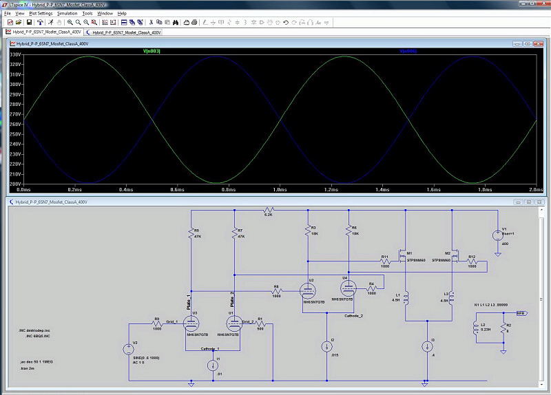

I was sitting in a boring meeting at work yesterday so I grabbed someones laptop and decided to design a driver board. Until tonight it only exixted in the mind of the simulator. Tonight I built the driver part of it and it looks like a winner.
It is set up for 400 volts of B+, -105 volts of negative voltage, and 25 volts for the drains of the mosfets.
This design is fully differential and DC coupled all the way through, Just ignore that mosfet output stage, thats for another project.
Looks great! I am in Singapore right now and managed to pick up four 230:110 volt 12VA transformers for about $6 USD each. Should do nicely for the +/- supplies.
Interested to see how it works in real life!

The driver section is alive and running. I hacked up my dual 6SN7 driver board to match the above schematic. I put in the component values from the simulation. I used 10M45's for the CCS's which need a negative supply so they are wired to -105 volts. I turned on the power and applied a signal and it was alive without any adjustment. This simulation stuff actually works sometimes. I was getting about 150 volts peak to peak out of the board with a 400 volt supply and the output cleanly rose as I cranked up the supply voltage and drive. This design is far more stable than the one with the CCS's in the plate circuit. In fact no instability was noted despite turning the knobs on all the power supplies and the audio oscillator.
If I have time I will hook up some output tubes this weekend.
The complete circuit shown is another one of my wild ideas. It is a completely DC coupled class A, fully differential amplifier. I have another simulation that uses vacuum tubes in the output stage. I plan to test these sometime soon.
The simulator will not predict the success of a novel idea. I have seen several circuits that simulate very well but just smoke when built in real life. It does however do a fair job at predicting failure. If the simulator shows that something won't work, it usually won't. It saves me the time it would take to build some of my less than brilliant designs.
