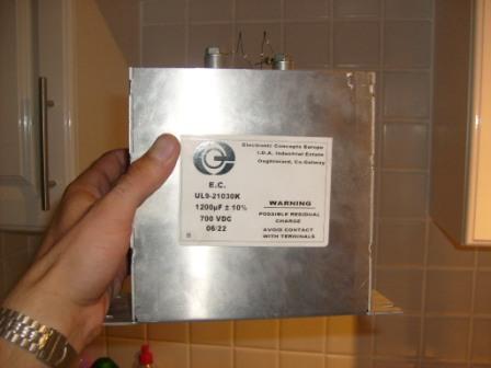

Just bought 4, should replace c10,c12,c20,c22 nicely. Now what to do with the extra 2 that I have acquired.tubelab.com said:
Cheap too. I got 6 caps delivered for about $40. search Ebay for ASC 600
I got 6 of them too. Ordered them Friday night at 10PM after reading about them on this forum somewhere. They arrived Monday morning. I am still trying to figure out how that happened. The USPS just isn't that good!
You can use one for C2 also. Just add a fuse..... Understand that these things are big. You will need to fill the entire chassis with them. They also have a rather ugly mounting stud sticking out of the top of the can (the other end from the terminals).
I can share this warning. These caps can store a LOT of energy! Their extremely low ESR will lead to destructive discharge currents. Don't discharge them with a screwdriver or a clip lead. How do I know this? I blew a Radio Shack clip lead in half! It made a very large bang that got my attention and scared Sherri sensless. I would advise adding a fuse to protect the transformers, wiring and circuit boards from damage in the event of a tube arc or short.
Wire a bleeder resistor across the terminals and leave it there. My usual 150K resistor takes a couple of minutes to discharge this cap.
Those GLY513's are a crazy good deal. Get 'em before the seller realizes what he's doing.
I had the data sheet on them (and lost it?), and aside from being HUGE, the specs are good. I used a pair in both the power supply and the output decoupling in a headphone amp. They're nearly as good on paper as 100uF caps I've got that cost 4 times as much.

Just be sure to keep those terminals shorted while not in use!

That's exactly what I had in mind. They are about the same size as the 2400uF 450 volt electrolytics that I was going to use in the power supply. The electrolytics just got voted off the island!
