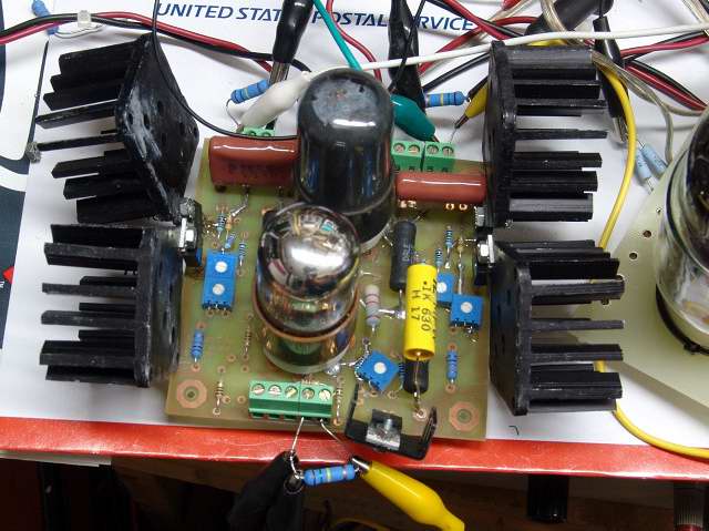

It has rained all weekend, so I decided to make some circuit boards including one of these.
I got a board made this morning. Of course I found a mistake right after making it, but it isn't a show stopper. I have been populating the board today but I don't have all the right parts, so I put in what I have. Maybe it will work, maybe it will blow up, but I may get to power it up tonight.
It follows your schematic fairly closely with a few exceptions:
I didn't put in R26. (I forgot) It may or may not be needed. A capacitor to ground from the junction of R24, R25, and R26 may help avoid a low frequency oscillation. I will find out as I go along.
I did find one mistake in your schematic. You need to add resistors in series with the "bias" connections between the amp and the power supply. Otherwise the driver is looking into a very low impedance bias pot (zero ohms if the bias is adjusted to zero volts). I used 470K ohms (because that is what I had handy).
I have been thinking that since 6SN7's like voltage it might be a good idea to allow for the possibility of connecting the CCS chips that feed to plates of the second stage up to your raw unregulated B+ supply. The CCS's will block the hum and the tubes may like the headroom. Of course I didn't think about this until after I finished the board, but I am not above hacking up a PC board in the name of science. I will know more after I make some smoke.
EDIT:
I plan to try some 10M90 900 volt CCS chips in my board. I plan to explore the upper limit of 6SN7's, 6BL7's and 6BX7's. I got some of those chips about a year ago and haven't tried them yet.

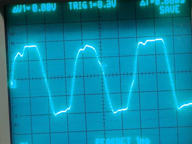

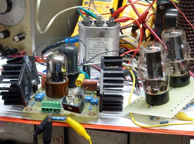

I got the board powered up. I set the negative voltage to -75 and the B+ to 400 volts to match your set up. The positive supply for the mosfets is set at +25 volts since that is all that I have handy right now.
I installed the first 6SN7 and adjusted it for best results. I lowered the 330 ohm resistor in the CCS to 220 to allow more range. The pot was all the way to one end. I had to change my plate resistors to 43K in order for me to be able to adjust the plate voltage from 100 to 250 volts. Remember my resistors go directly to 400 volts. I settled on 150 volts by setting the CCS current. I could get 50 V P-P out of the first stage at low distortion.
Installing the second 6SN7 brought a strong tendency toward oscillation. It seems to be related to the mosfets or the CCS's or both. The thing wipes out the TV in the next room and it is connected to cable!
It is late here so I must shut down for the evening. I may have some time to experiment tomorrow. This weekend is a 3 day weekend in the US and it is unlikely that I would get called into work.
I plan to disconnect the mosfets and switch back to normal (10M45) CCS chips next.

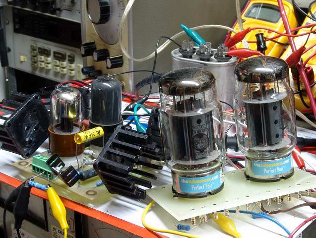

I warmed up these 6L6GC's on the bench to see what they would do in triode. They will make 30 watts at clip, and the distortion at 20 watts was in the 2% range.
Lines on a scope and flashing red numbers can only say so much, so it was time for the speakers and the CD player. This guy ROCKS! It plays Enya and Diana Krall very sweetly, but feed it some Mark Knopfler and it rocks.
