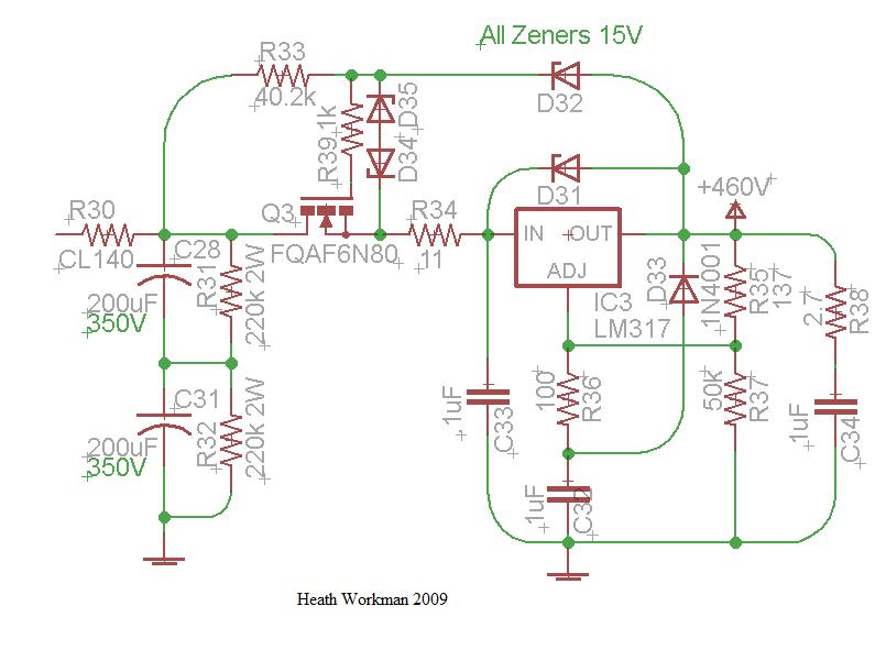

As for the regulator, I share it with a caveat. I have not tested it with lab equipment yet. (just got parts to build a dummy load) I have done listening tests and it sounds a lot better than the unregulated supply, more powerful.
Hopefully some folks will stop by and review my design. I'd hate to pass on something that doesn't work perfectly .

I have used a regulator circuit very similar to the one shown by Spread Spectrum. It is a derivative of the Maida design shown in an old application note available on the National Semiconductor web site. My version uses a big ST Micro mosfet, and the other component values were tweaked for minimum ripple (both audio and 120Hz) at full load. I use it for testing and it is NOT short circuit proof as some claim, but this is not a requirement in an amplifier.

I don't know if I would use the Mosfet B+ reducer. If you are going to dissipate some power to knock down the voltage, you might as well attenuate the ripple at the same time (regulator). A heatsink is your friend.
Source followers would have some added benefits, but would add some complexity (a negative supply). You would also have to set up a fixed bias scheme and adjust bias on the power tubes individually. You would be immune to blocking distortion. You may want to try building without and leave some space to experiment later. It just depends on how ambitious you are.

Complexity is not necessarily a bad thing.
Then I'd do the source followers. Bias stability will not be an issue and you will be able to present a very easy load to the driver stage for low distortion. Good things.
Maybe your bias tap would give you enough voltage for a negative rail, maybe you will need a separate transformer.

I think that a regulated supply will be needed. From what I have gathered from the Tubelab site and reading Morgan Jones, a long tail pair is not suitable for driving an output tube past A1, therefore I will need a source follower of some description to drive the outputs into AB1?

Regarding regulated supplies, does anyone know of someone who has a good regulated supply/bias supply PC board? Might help with a neat/tight layout.

Johan has given you a good clue. If SS diodes are used for rectification, regulation of the B+ rail will stay decent if you don't go above the AC RMS value. Under 1 μF. in the "fudge factor" position gets the job done.
Pseudo-choke I/P filtration combined with the Hammond power trafo you propose to use, requires you to go with 100% of 7591 bias voltage coming from a C- supply. That, in turn, requires you hold the total grid leak resistance to 270 KOhms or (preferably) less. Keeping 12AT7 LTP gain up, working into that setup is problematic. The comparatively simple solution of IRFBC20 source followers DC coupled to the LTP and cap. coupled to the splitter resolves those concerns.
