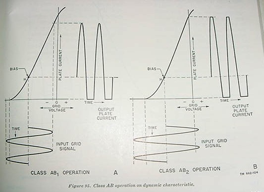

Am I mistaken in thinking that given a perfect driver, clipping shouldn't occur until Vg = Vp, which is when the grid would swallow up all electrons from the cathode? Is that what the diagram is depicting?
Edit:
Sorry, just looked at the figure again and it seems that it is clipping at Vg = 0. Maybe this guy needs a source follower.

SpreadSpectrum said:Am I mistaken in thinking that given a perfect driver, clipping shouldn't occur until Vg = Vp, which is when the grid would swallow up all electrons from the cathode? Is that what the diagram is depicting?
Look at 12K5: Characterized G1 and Plate both at Positive 12.6V!
G2 at Negative 2 Volts! Plenty of electrons still reaching the plate...
My point is that G1 here didn't suddenly become a solid plate and
arbitrarily swallow up all the electrons. Its still mostly an empty grid.
I suppose if a tube were severely emission limited, there could be
an issue. Perhaps exceeding what the cathode coating can emit.
SY said:Curious about where the diagram is from. It appears to be incorrect.
It's from a U.S. Army techicnal manual. After some thought and study on this, I too am beginning to question it's accuracy. I believe that when driving a tube into gird current it is basically being overdriven to some extent. Although viable, it's range must be limited by the tube itself or it's working environment. But this text was from 1952. It may be illustrative of the state of the art back then (no fets 😀), who knows.

My point is that G1 here didn't suddenly become a solid plate and arbitrarily swallow up all the electrons. Its still mostly an empty grid.
I guess now that I think about it, I got the idea that plate voltage wouldn't dip below grid voltage from the 211 data sheet.
If the tube is capable of it, why did RCA stop the curves at Vg = Vp? Is it just that it is harmful to the tube maybe?
