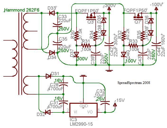

chrish said:What about for the B-? I am guessing separate transformer for this under the chassis?
I just derive mine from the main power xfmr. In one design, this was a solid state +/- supply. Since the current draw from B- is so much smaller, an RC filter works out very well, and the filter resistor can also be used to drop unwanted volts.
In another design, the positive rail was based on the 5U4GB hollow state power diode, and the negative rail derived with silicon diodes. This worked out well since the power xfmr would over volt with SS rectification, but the forward drop of the 5U4GB and voltage averaging at the first resevoir capacitor got the Vpp right where I wanted it. A SS negative rail also works out just great in that the bias is already there before the heaters warm up, so nothing takes a high voltage hit.
That's what I did for my KT88 amp. I did simple regulators so that I don't have to re-work the power supply if I make changes and current draws change. You're welcome to adapt the relevant parts if you wish.
My bias regulation is absolute since so is my B+. One could easily substitute a resistor for the 100v zener to make bias voltage changes counteract B+ voltage changes.
