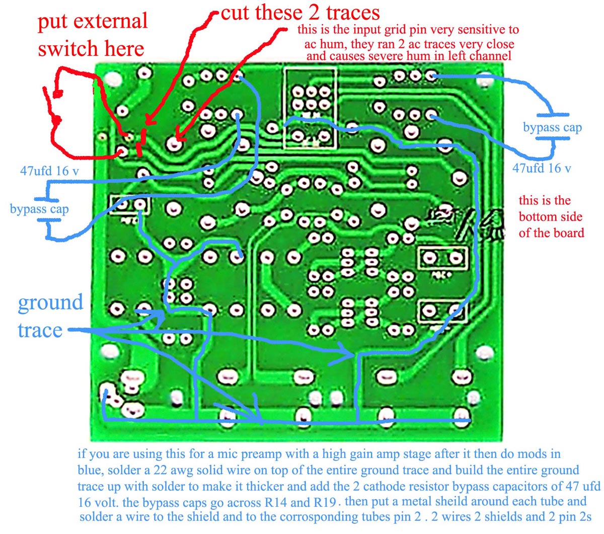

you are welcome Whelkie but there is still a problem with hum. as long as i have a fairly low impedance connected to the input i have no hum. with a high impedance like a guitar or nothing connected and the volume turned up the left channel hums quite a bit but i have found the problem. they ran ac voltage traces to the switch all aroung pin 1 of the left tube which is the grid or the input. really stupid. i am going to cut traces and mount an external switch. when i get it done i will post a picThanks for that - really helpful.

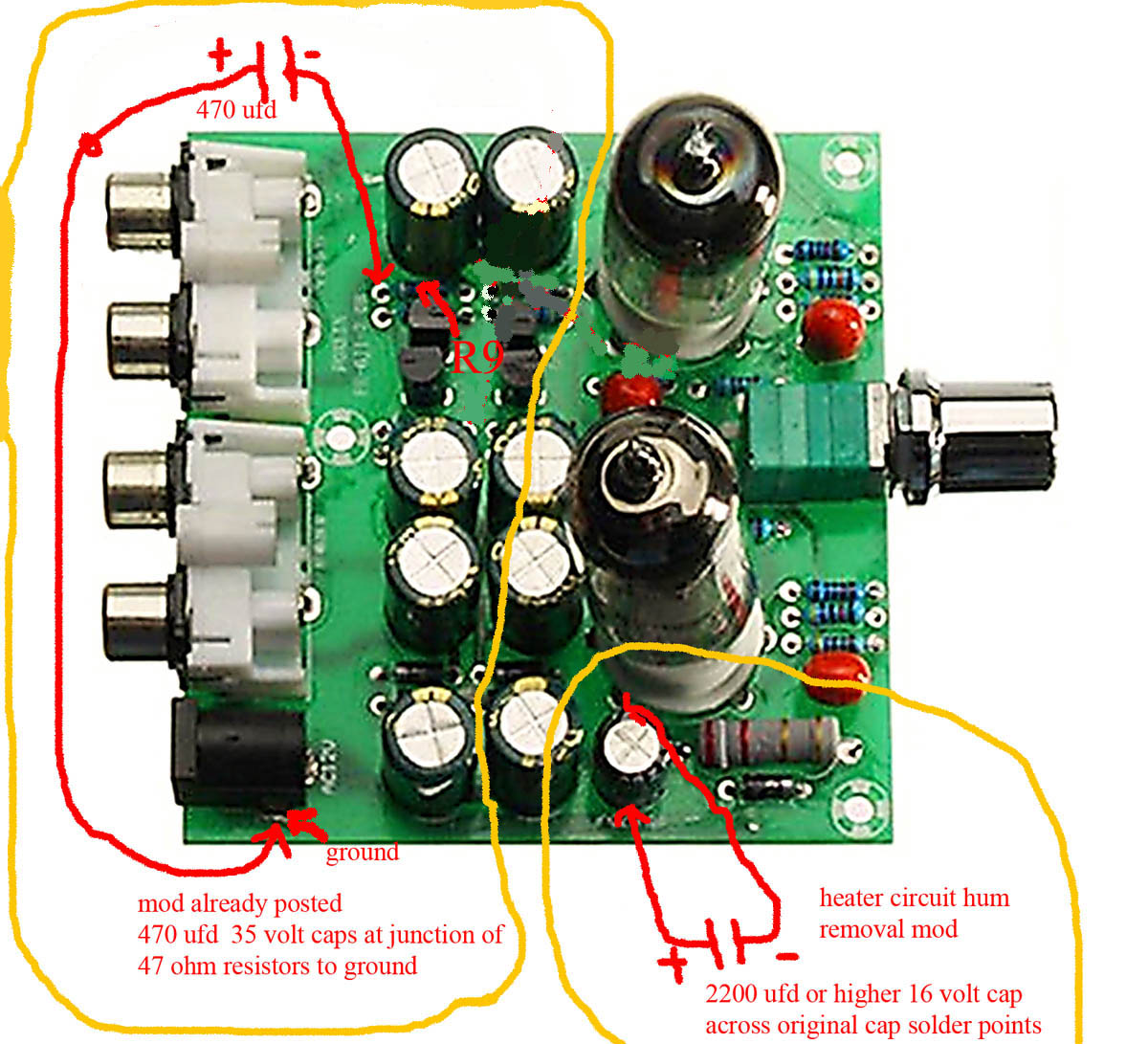

i see you did the mod but the mod at the 47 ohm resistors originally posted by someone else is not entirely correct. i rechecked it to be for sure and i change it on my board. one of the caps has negative to ground and one has pos to ground.
here is the picture of the 6j1 hum removal modification

these mods will remove 100% of the hum in the fever 6j1 tube preamp. it took a little more than i originally thought. the first post had a pic but i am reposting it because you only have to add one cap to the 47 ohm resistor junctions and it is for the neg side of the supply because the neg supply bias's the grids and noise here becomes part of the signal and gets amplified. still need the extra heater supply cap. the second pic posted has the mod to fix the ac traces running too close to the grid pin 2 on the left channel tube which causes a lot of hum on the left channel.
the mods in red are required to remove the hum for normal use and is going to be good enough for most all situations. the mods in blue is for use in a situation where a very high gain amp is used after the preamp. also the bypass caps not only remove a little noise but it increases the gain from about 8.5 to 10.5 and gives a flat frequency response from 45 hz to 50 khz. the shields tied to pin 2 only works well if you use bypass caps. i had to do the full mod because i am running a compressor which uses a variable gain op amp with a max gain of x56 and now no noise at all.

made a mistake in the write up but not in the images, pin 1 is the grid not pin 2. pin 2 is the cathode

@gmcdonld - Hi and thanks i just now saw your post.. ok so one of the caps has positive going to ground and the other has negative going to ground? i will change mine. its been making some weird noises now and then on 1 channel.. thank you for clarifying this . ill do it by the picture you posted .. thanks

@gmcdonld - ? on the bypass caps, do they need to be non polarized and/or a specific kind aka ceramic/electro etc.. if i use polarized which way do they connect ? please forgive my newbieness 😀😀😀 is that even a word?
