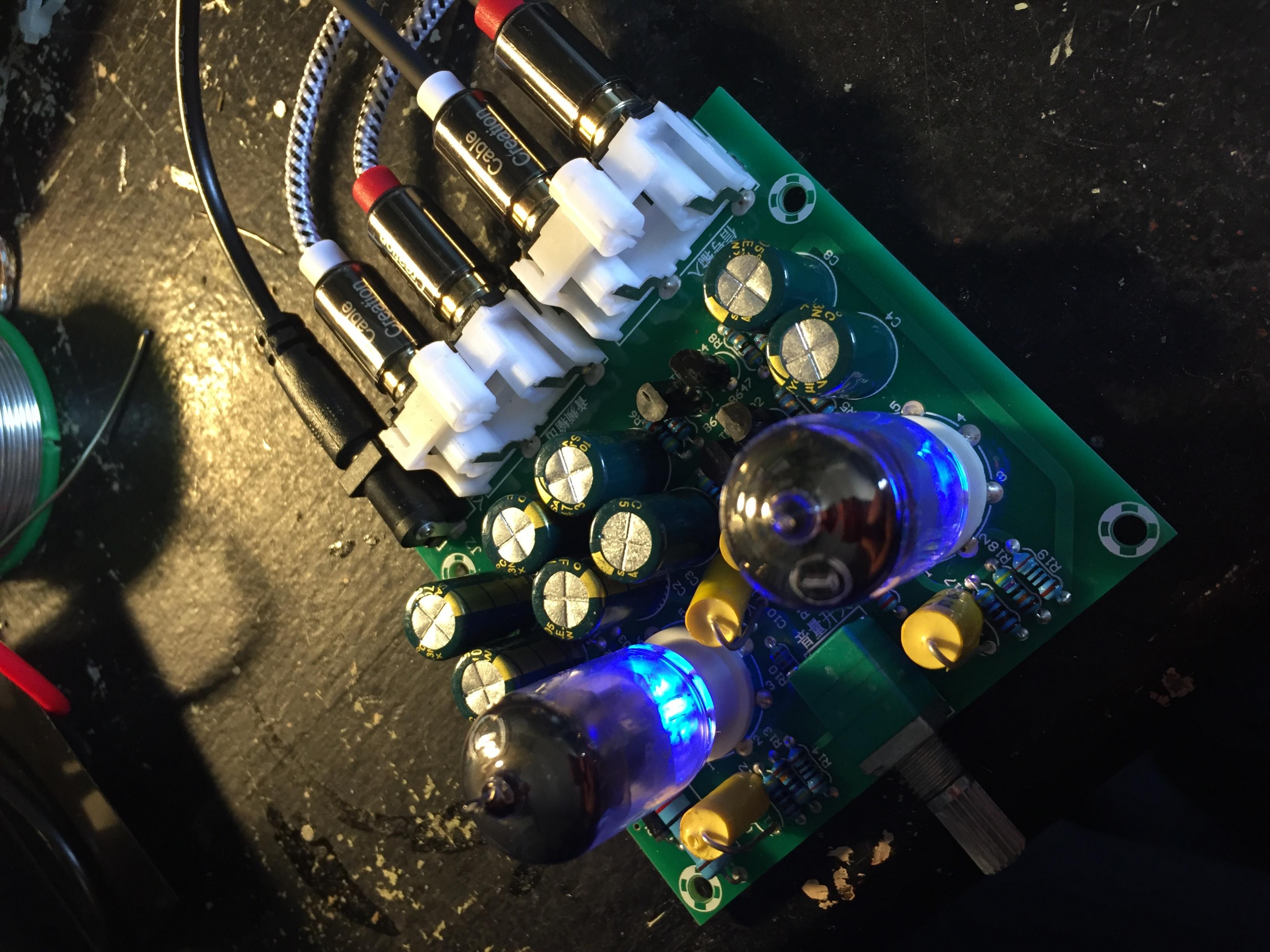

And there you go! Grid referenced to gnd and not -ve, as is the output node, plate load is gone, and the cathode load is now 4K7.
Works fine, and I really should have a play with some of the others. 🙂
Hi , very nice work. Some of us are not good reading schematics. Can you make some more photos to help us do this modifications ? The caps are 1uf i guess , what values are the resistors ? For the caps, have you drilled the board or are the caps soldered directly on the components around ?
Hi there, I've no particular desire to write a how-to, but i can answer the questions. No drilling, values are in the schematic, the parts all came with the kit (although I'm not saying that they're ideal values as I've not done the work).

Interesting! How different is the sound with a cathode follower? Can you try to describe it?
I'm interested too!!!
Waiting for description....
Thank you
To be honest, not a huge difference, but my setup currently isn't really tip top.
Tell you what - I should be able to do some measurements on them easily enough and compare the two objectively. I'd intended to anyway, I just haven't done it yet. 🙂

Tried this on mine just now, it made a 10db INCREASE in hum. That said, mine is somewhat modified in that regard, with a bigger cap for the heaters among other things, so YMMV.

I've ordered another board specifically for modding so I'd be interested in upping the voltage as well and getting the most out of the 5654w tubes I've got waiting.
Experimental board arrived!
What sort of voltage would you suggest aiming for? The data sheet seems to suggest up to ~180v
twice the voltage for starters, this will need modding the boards for the new voltage...a new psu..

Looking at the circuit, we have a voltage multiplier which is fed rectified 12vac which gets us the ~28v (looking at just the upper half).
The 2SD667 is good for 80Vceo so is it just a case of supplying say 18-24vac rectified and upping the voltage ratings of the capacitors to safe levels to get a higher supply voltage, or is there more too if than that?

on the same board I use a 14vc and have 35vdc on capacitors (on max limit voltage).
Infact I want change capacitors.
Your ideas to increase voltage its the same mine....But how much is possible increase?
