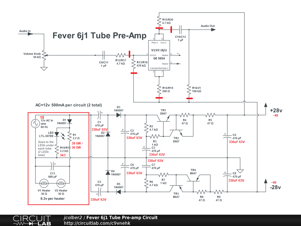

I upgraded the caps to 63v and ran the power supply part of the circuit with no other changes. I got the following DC voltages at the +/- 28V pins:
IN__OUT
12__73
14__77
16__88
18__99
20__110
22__122
So to keep away from the 63v cap limit, I'll probably choose an 18v power supply for this project. 100v for the tubes should be better then 56v..??
This brings me to the next hurdle: 6.3v heater supply.
The original circuit deals with this by putting the 12VAC through a nasty half wave rectifier then heaters in series.
Any suggestions how to make this better - I'm thinking either a dummy load in series with the other 2 heaters or a regulator such as the LM7812 to drop the ~18v down?
I would keep the half wave filament rectifier to keep things simple. 6J1 filament draw about 170mA, if you put a 35 ohms resistor in series (18V AC) that should drop 35 * 0.17 = 6V and get to the 12V that you need. You will need a 3W resistor for that (3X of 6V * 170mA).
I tried to add the resistance into the heater circuit by changing out the R1 (2.2 ohm) with first a 39 then 33 ohm, 5 watt but it seems the current isn't dividing as nicely as I'd hoped.
With the 39 ohm, I did not get the V2 heater to operate.
With 33 ohm, I got V1 looking normal and a faint glow out of V2.
So I think I'm going to need to drop in a regulator (got some buck converters on the way).
Do I still need to have a higher value at R1 then R1->regulator->V2;
or revert to the 2.2 ohm;
or remove R1 altogether?
That resistor is dropping around 1.8W in my build so I changed it out to a 3W resistor to increase the longevity and decrease the temperature load.
It was running a little too close to limit for my liking.
If you are uncomfortable with how hot it gets, try increasing the power rating of the resistor to 3 or 5W.
