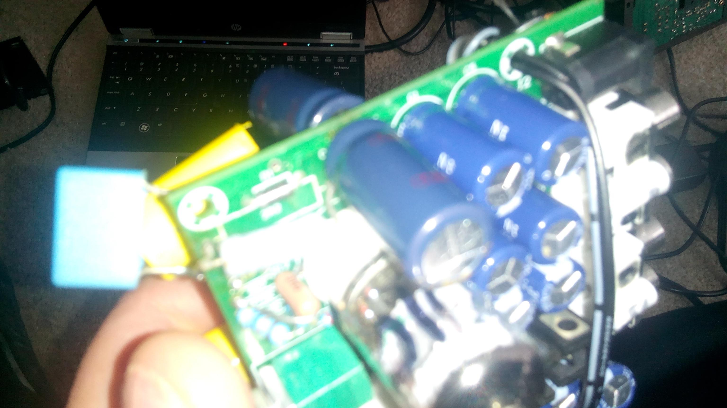

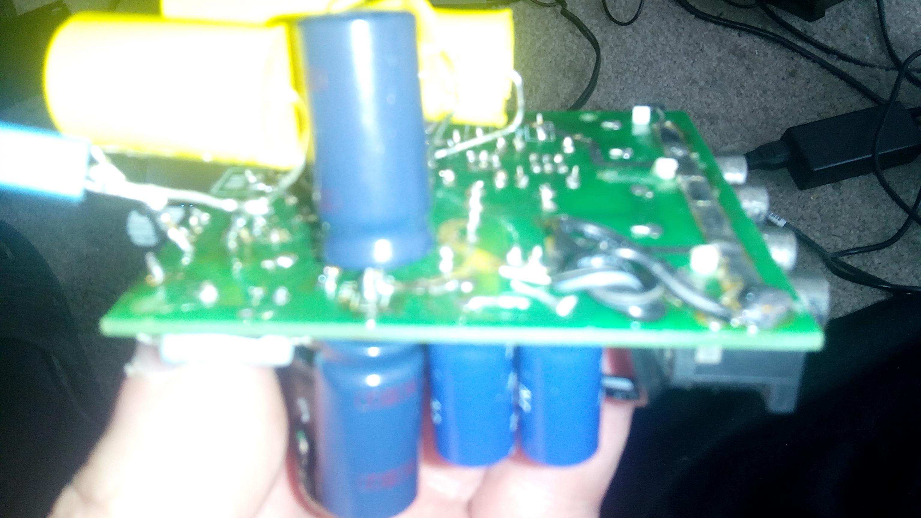

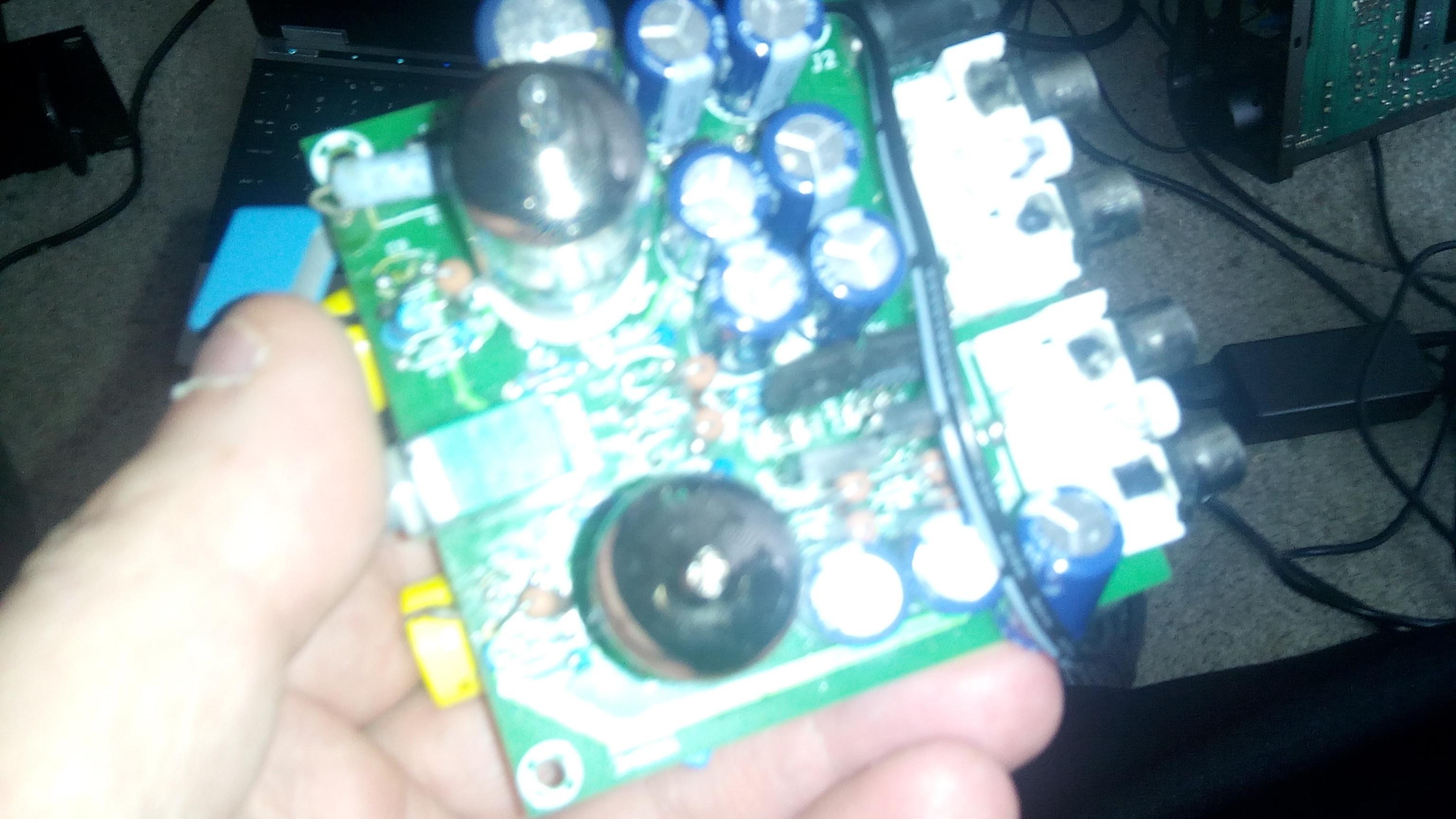

these mods will remove 100% of the hum in the fever 6j1 tube preamp. it took a little more than i originally thought. the first post had a pic but i am reposting it because you only have to add one cap to the 47 ohm resistor junctions and it is for the neg side of the supply because the neg supply bias's the grids and noise here becomes part of the signal and gets amplified. still need the extra heater supply cap. the second pic posted has the mod to fix the ac traces running too close to the grid pin 2 on the left channel tube which causes a lot of hum on the left channel.
the mods in red are required to remove the hum for normal use and is going to be good enough for most all situations. the mods in blue is for use in a situation where a very high gain amp is used after the preamp. also the bypass caps not only remove a little noise but it increases the gain from about 8.5 to 10.5 and gives a flat frequency response from 45 hz to 50 khz. the shields tied to pin 2 only works well if you use bypass caps. i had to do the full mod because i am running a compressor which uses a variable gain op amp with a max gain of x56 and now no noise at all.

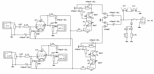

And there you go! Grid referenced to gnd and not -ve, as is the output node, plate load is gone, and the cathode load is now 4K7.
Works fine, and I really should have a play with some of the others. 🙂
Hello, i did the mod as per your schematic on my second board, since i have bought 2 preamp boards.
the good part is there is no hiss or hum it is dead quiet, but the bad part is i don´t like the sound. I ear also some distortion on bass also in percussion etc.
is everything ok in your schematic?
