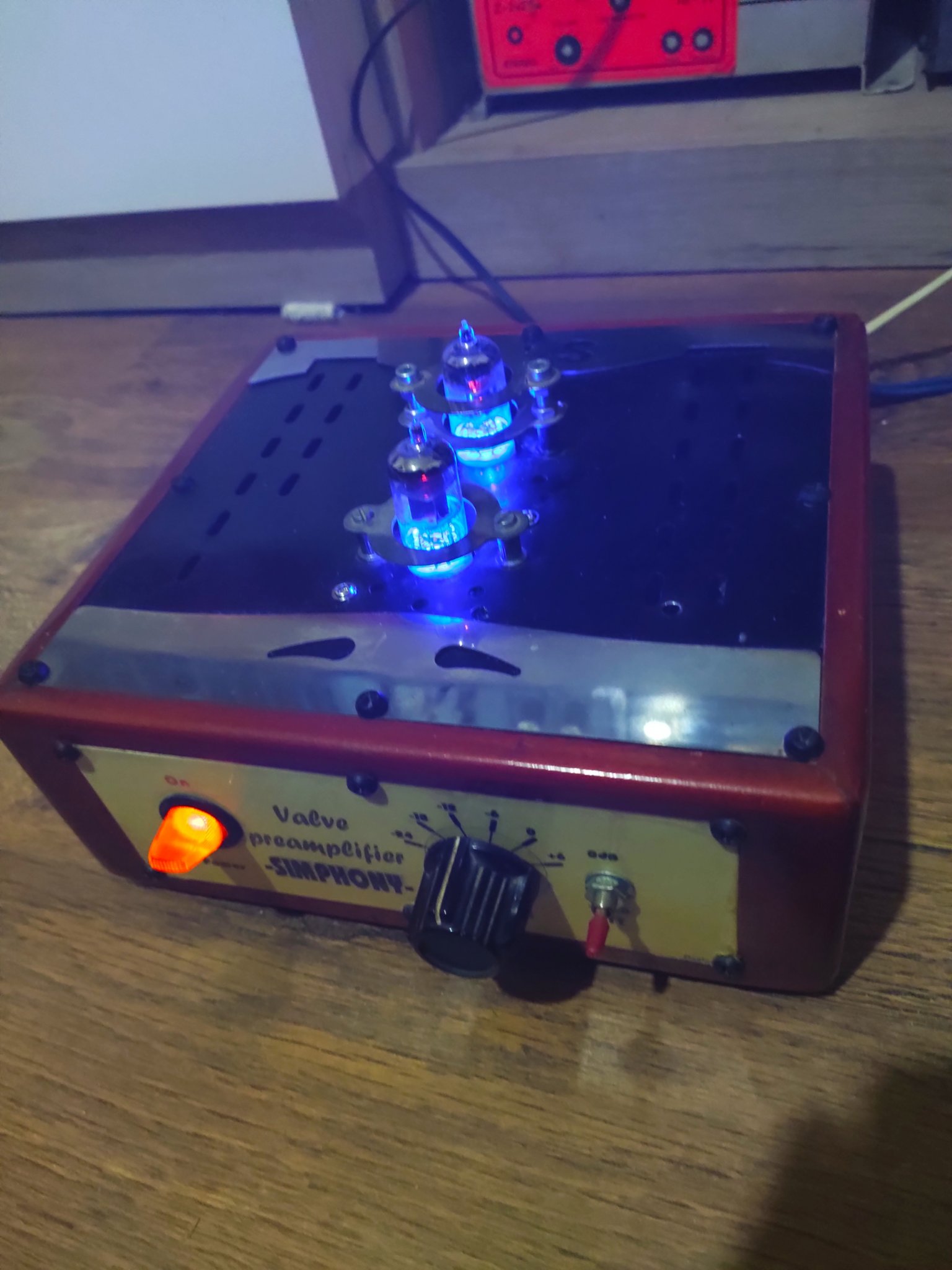

In completely different thread, i worked on this little circuit. I addressed the hum by splitting the power supply, separate for heater, separate for HV. I beefed up filtration for heater. I kept the same 12 volt trafo. Once i split voltage multiplier from heater part, i fed this with 24 volt ac, upgraded some capacitors and got rid of the smoothing transistors in power supply. They were dropping some volts. It increased voltage from ~47 to over 100. This helped linearity a lot. Idealy it should be over 150. It was almost listenable at the end.
had to post: substituted the two 1uf poly caps next to the tubes with 2.7uf ;as it sounded dull....the sound has opened up substantially. clear...as if the treble was on mid and now full throttle; with no hiss,hiss. just open-clear sound. impressive.
Do you mean the two poly caps situated in between the tubes? I have a couple of 2.2uF poly caps. Do you think they would improve the sound? Thanks.
warm up the pre for several hours and it sounds amazing! clear. detailed.
I turn it on at 10am and play it at 5pm. listened to the pre last night for 5 hours straight. if using an amp with a volume control, crank up the pre all the way and use the amp volume. increase bass gently. the pre doesn't sound as mellow as my 60's tube-console amp(which I have listened to, into the wee hours of the morning), but it's darn good. AC adapter is putting out about 13.30vac and using a variac at 120-121vac. using onkyo a9555, yamaha ns 1000's with pots set below -3db on mids and tweets at normal, cd and USB/mp3 music from a marantz cd player. using yamaha mx 1000 makes the sound felt, intensely- beware of horn damage!
a dc transformer can be converted to ac by splitting it open and removing or bypassing the bridge rectifier. upping the poly caps in between the tubes to 2.7uf made the most dramatic difference in sound quality to me(besides the hum mod).
