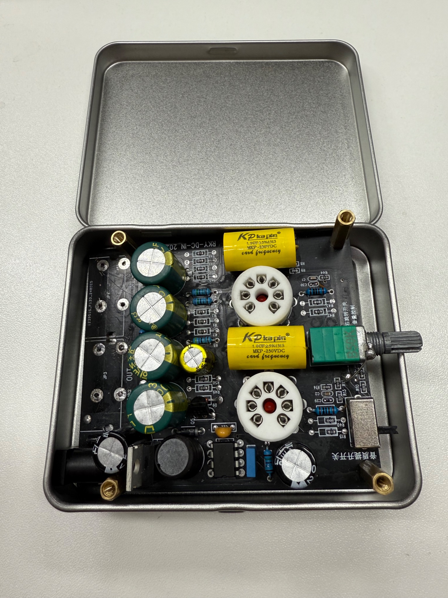

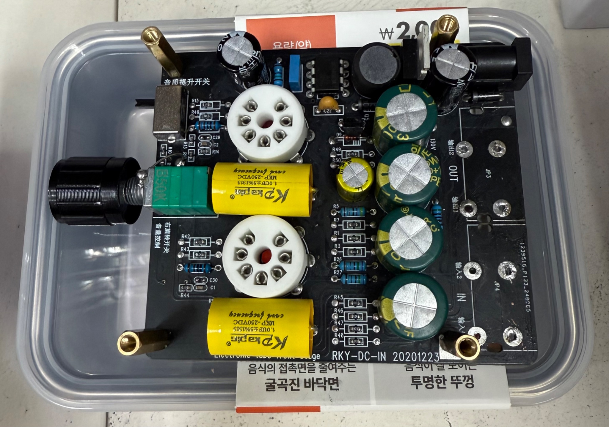

I use a kit, its not hum or noise. But after 2 month, 2 of 8 filter cap is swell, i use VOM to check at +-28V pinout, vontage is 32-33V. so I replaced 8 470uF 50V and a 25V 2200uF for filament filter (12.6V pinout have 16V vontage when no tube ) - the board design for 10mm capacitor so I have no choice for larger cap. Beside i change 4 input output cap to Ero MKP cap 1uf.
Im working on a hardwired version of this in a cigar box. Used 50v 470uf nichicon in psu and a 25v 2200uf Panasonic for heater cap. Used some huge 1uf axial polypropylene caps from dayton for my input capacitors. 1.7uf Wimas for output coupling. Ended up keeping the negative feedback loop values at 0.22uf and 200k. I put a shield made from paulownia wood covered in guitar conductive paint between the psu section and the amplifier channels. I also painted the entire inside of the box and grounded the RCA outputs to it. I used a standard stereo a50k vol pot, and put the switch on AC 12v line between the pre and the transformer.
Dead silent with every knob in my system dimed, not a peep. As quiet as my mixing interface and monitor setup. phenomenal performance too. Honestly im blown away. It's instantaneously better imaging no matter what system i hook it up to, even the living room system built around a Yamaha s801 and (old) Klipsch, instant improvement. And i can get a very surprising amount of gain out of it before any perceived clipping, which i can only just barely perceive in the last few % of the volume sweep. Its good enough that im afraid to alter the circuit anymore until i have a deeper grasp on what it is im actually doing. What the negative feedback loop is, how it works, and how you can tune the response and gain of an amplifier only just clicked last night for me, and i felt pretty dumb once it did 🙄
Gonna try and get a testing setup put together this week sometime. I really wasn't expecting it to turn out this fantastic. Nor did i expect to be this interested in improving it.

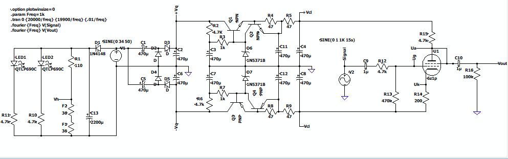

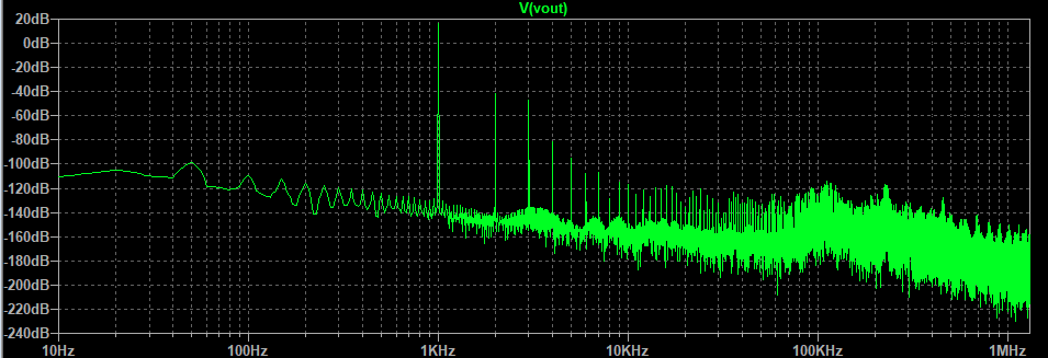

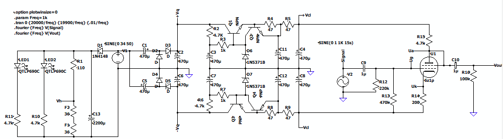

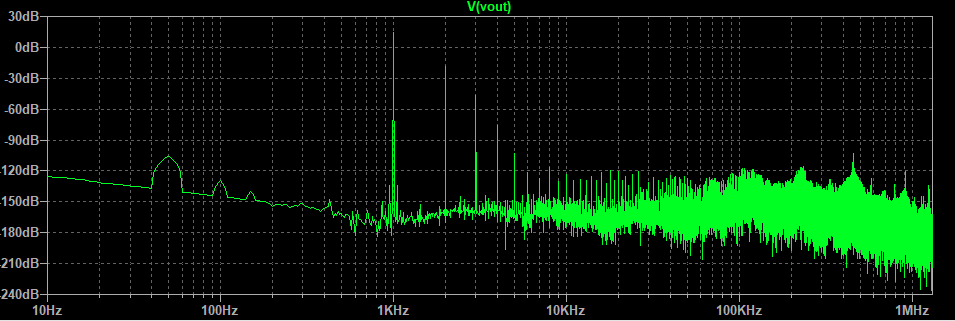

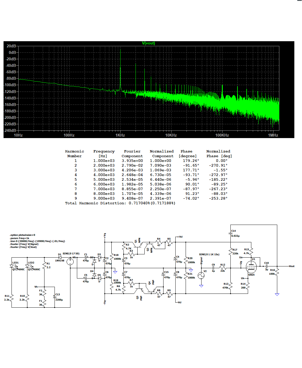

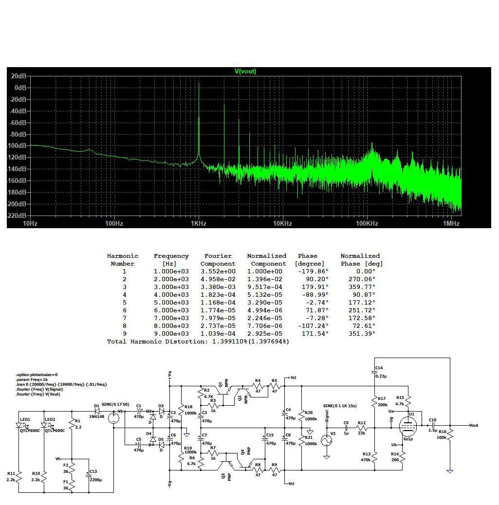

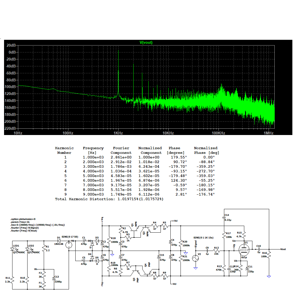

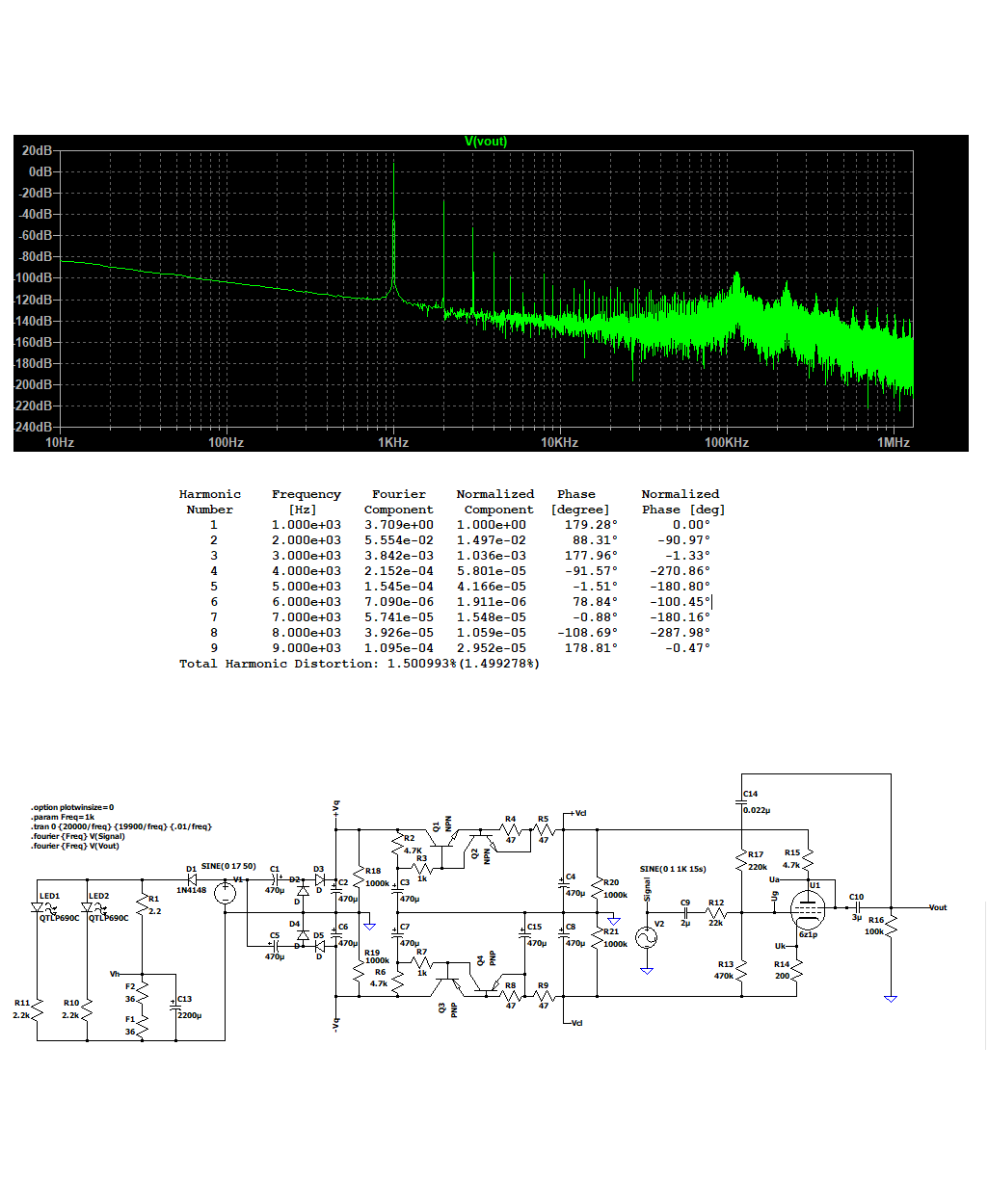

For the comparison reasons I have ran the simulations with Tha(t)oneGuy designs:
#256 => TheStuffMade_1
#258 => TheStuffMade_2
#263 => TheStuffMade_3 (6J1)
#263 => TheStuffMade_3 (6AG5), the spice model used
I could not make the simulation running with 100k in the power supply, they were dropping the voltage efficiently, thus I have changed them to 1Meg.

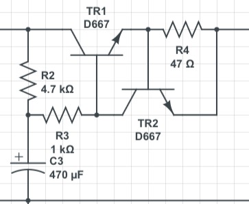

The bulk of this “cheap tube preamp” is power supply, and the transistor circuit below has me baffled. What does it do? A pointer to a lecture, article, or online textbook would be much appreciated.
As for the tube part of the circuit, isn’t there supposed to be a bypass capacitor across the 200 ohm R14/R19 cathode resistor?
Yes TR2 is a current limiter for approx 14ma, but why ?
as of right now im actually running it directly from a 26v out on a transformer with a bridge rectifier and voltage doubler and some extra filtering. I actually just ditched that transistor section yesterday.
And at least according to a multimeter, 100k in the power supply is very stable voltage output. never drifted by more then 0.1v while reading. Any more and the thing will still arc like 20 mins later, at least in my personal experience with that circuit.
I decided i did not like the design of this power supply as i learned more and more. And the preamp is currently in a pile on my bench again lol. A working pile, but a pile nonetheless. Im gonna need a bigger box. Im actually quickly approaching having nothing left of the original design at this point really.
Funny story, while it was on my bench, i somehow, truly dont know how, i soldered the new -26v to the heater supply pin. God only knows how i did that. The resulting failed transistors and resistors made some real pretty colors and real unfriendly smells.
P.S.
Ditch the 22 ohm resistor feeding the heater circuit if you have this. No idea why they include a 22ohm resistor for that. Even 5654's run at like 5.9v. It's also only a 3 watt resistor and gets hot enough to sizzle water running 300ma. if you put 300 ma heater tubes in pulling 600 total, that resistor will def fry.
a 1.8ohm 5w power resistor has all my 5654 sitting between 6.2-6.5v
a 1.45ohm resistor has my 6ag5 6.1-6.4 and 6AU6 roughly the same. Both offer significant soundstage improvements over 5654 to my ears on my equipment.
As sold, the heater circuit is basically designed to deliver cathode poisoning as fast as possible. My 6AU6 measured at about 5v flat on the circuit stock with the recommended 1a transformer. Which isnt actually enough to run two 150ma heaters and both channels to begin with. Should really stick with 2a minimum transformer regardless of what you do with this circuit
(its far more likely people with curiosity who dont have any idea what they are actually doing, much like myself, (im learning though) will be landing in this thread to find info. Im posting in this fashion for them not you guys lol)

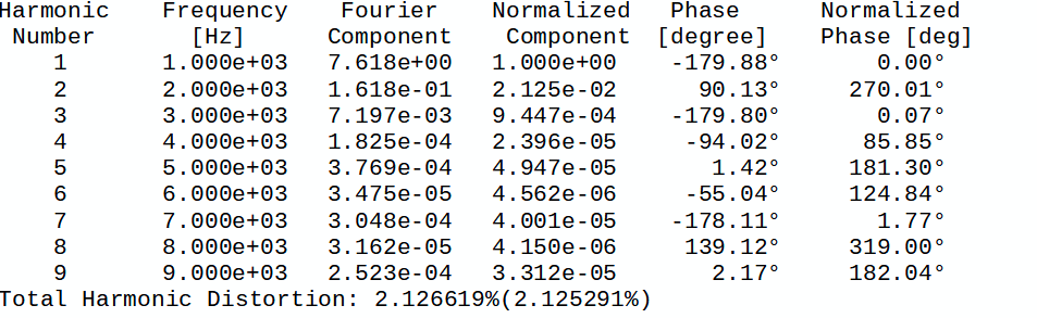

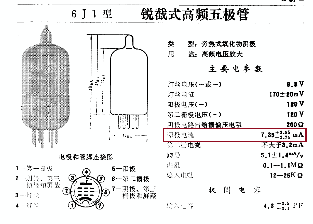

Very good question jcalvarez, it has got me thinking. The only reason the current limiter shall be there, is to limit the plate dissipation. Now the question is what would be the conditions it would make sense. There is one condition to be met in my line of thinking.
Assumption: The power source voltage was originally 24Vac
Calculating with these assumptions we will have +-60V at the rails, which would make it to typical operational voltage for the tube. The maximal plate power dissipation is 1.7W at 200V, at 120V it would make 1.2W corresponding to 10mA limit. Since we want to have some safety margin lets say 25% that would make it to 7.5mA. And that would make sense to me. Running at 120V rail to rail affects capacitor selection for higher voltages (470u/100V), which leads to the elevated production cost and additionally 24Vac might be not that common to find. I believe that was the main reason the circuit was de-tuned for +-30V at rails, but the rest was not recalculated anymore.

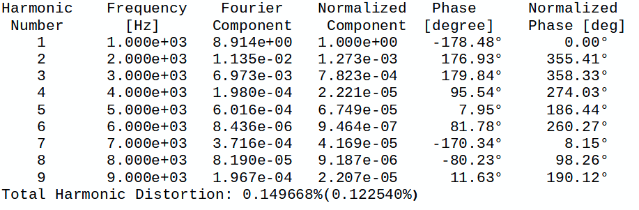

If we agree my assumption is sound, the circuit would look like:
The THD is ~2%, approximately half of produced version, which would also make more sense.
Adding similar offset trick as in my first post we can get down to THD ~0.15%.

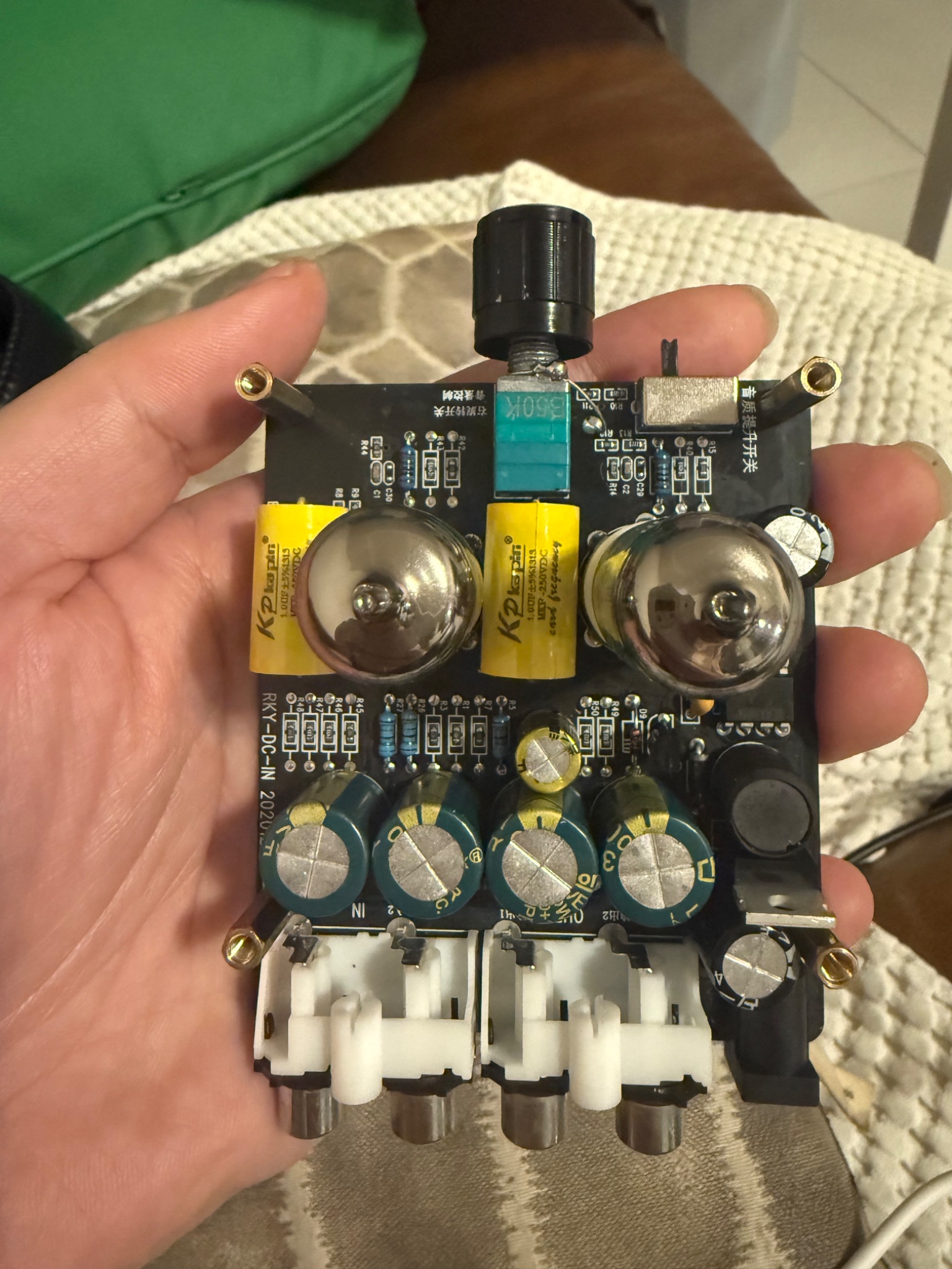

Hello friends ...
I saw TheStuffMade video on youtube, i have read so many threads about this little tube amplifier and have been so confused about what upgrades should i do .
Should i change all the electrolytic capacitors with better ones ? 35v or 50v?
Would be any difference in sound if i replace them all?
I know that definitely have to change the signal capacitors with better film capacitor but how many uf ? 1-2 or 3 uf?
Finally i saw acamus post with the lowest harmonic distortion and download his pdf. Very helpful the photos and drawings but i think the black cables in drawing doesn't match the cable i see in the photos.
I have bought jan 5654w tubes and i have a spare 12V 3A power supply.
Can some one guide me to upgrade this amplifier?

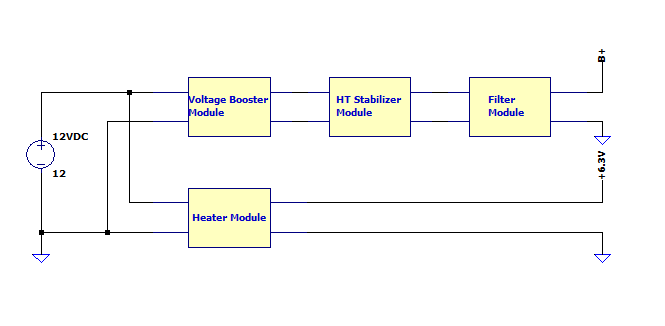

I have forgotten to post power supply for trying out Adason and FlaCharlie designs. The PSU is modular.
One can buy ready solutions for Single Voltage Booster, or combo with Heater Module, both lack regulator and filter part.
Stabilizer/Regulator module is based on Fesz design, I have considered also Maida, Iraka and Salo designs,
for simplicity and completeness Fesz won.
Printed circuit boards for
Voltage Booster Module
Heater Module
Regulator Module
Filter Module
Here is typical overview diagram
