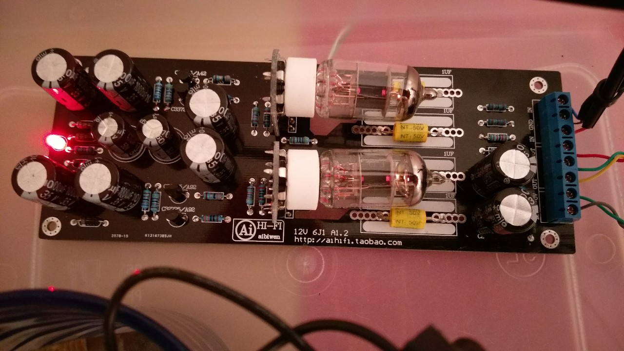

I found that the hum fix posted earlier reduced the hum a little but it still hummed annoyingly. Difficult to interpret the instructions as all the photos have disappeared. I will try to beef up the capacitance multiplier but I don't hold out much hope. The FX Audio unit that I have is so much better than these eBay kits.
I have tried a different looking one, but the schematics is the same. I noticed some hum and it seems like it provides some gain, so not a buffer, as I had initially expected.

I did have the same cheap twin tube version that you have, but I could never get it fully quiet, plus I needed a buffer, not a pre-amp.
I too have bought the FX Audio valve pre-amp and use this one on my hobby room system. It sounds fine and exhibits minimal hum. The circuit for the amplifier part is pretty much identical to the 6J1 kit (with the voltage doubler type of supply). I do not have the circuit for the DC-DC converter. Would like to find a similar module to drive my 6J1 kit and replace the voltage doubler. I run mine with a pair of GE5654W's.
I put some GE565Ws in my FX Audio valve pre-amp and this happened - that lovely fizzle sound with additional smoke! Unfortunately I hadn't tried the 6J1s first so now I don't know where to begin to try to find the cause.

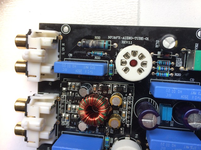

Hello fellow nerds!
I bought my first Tube amplifier a few weeks ago! It is a 6J1 preamp. I bought it on Aliexpress and when it arrived it didn't take long to assemble it! Was so exited to finally own one but i gotta say.. It hums alot
So i began investigating, adding 4700µF capacitor all around the PCB to see if it helped, but didn't!
After almost giving up i got 1 last thought.. It could be the layout. So after looking at the layout i noticed the 12VAC was making a run over to the switch in the Potentiometer and it was running directly beside the audio signal for left channel. So what i did was adding a 270K resistor between the tube Pin 1(GRID IN) which took care of it without a problem so tried listening to it but there was a difference in the sound so added one to the other tube and that did it
I also did add a jumper wire to make sure it has a good ground connection as the Ground also passed though alot of components that was close to the AC signal!
Here you can see the diagram with the resistor added! Notice i also redrawn the 100K as it was wrong on the orginal diagram mentioned in the black box in the picture
Here is my backside in full view
AND a closeup to show you where the problem is
Only thing you can notice now is harmonic sound and a low level humming but the harmonic is stronger!
Hopefully this will help someone!
