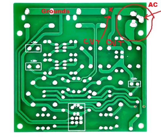

Hi Decee1,I bought my first Tube amplifier a few weeks ago! It is a 6J1 preamp. <snip>
I have same big hum problem. I noticed the AC 12V input is connected to the sound ground in-out! That could be the problem. Never seen that. Why not isolate AC in and those sound ground? Adding a resistor changes the tube bias and could lower gain + hum.
Did you make other changes to values?
Thank you for your pictures!
Gilles
I am looking for a way to create a commun ground far from in-out signals: star ground. Since the case is in plastic it is not usable. Ideas?...

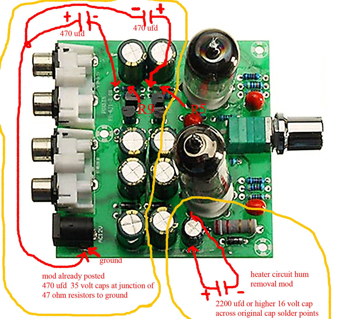

complete hum removal from china 6j1 tube preamp
they can talk trash about this preamp all they want but the kit with board and parts can be purchased on ebay for less than 10$. i use mine as a mic preamp and it adds a nice warm smooth tone. yes it has hum but is easy fix. most of the hum is in the heater (filament) circuit. it uses only 1 diode and a 470 or 680 mfd capacitor. add a 2200 mfd 16 v cap across the original cap. if there is still a little hum left do the other mod posted, which is add a 470 mfd cap from the junction of the 2 47 ohm resistors to ground. the positive leads go to ground and neg to the resistor junction, use your voltmeter and you will see why. you have to add 2 470 mfd caps because there are 2 sets of 47 ohm resistors. so 1 2200 mfd and 2 470 mfd caps and absolutely no hum at all. the preamp has a gain of about x10 max as it it is. works great with this really simple fix. i used an oscope to find the 60 hz ripple

Thanks gmc .. i used your cap mod but i didnt have a 2200 so i removed the 680 and put in a 3300uf and then i dd the other mod, 2 -470uf at the resistor junctions and there is zero hum so thank you !!

Would it be possible to post some pictures of this mod? Would be really grateful if you could show exactly where it fits on the board. Thanks.they can talk trash about this preamp all they want but the kit with board and parts can be purchased on ebay for less than 10$. <snip>

i see you did the mod but the mod at the 47 ohm resistors originally posted by someone else is not entirely correct. i rechecked it to be for sure and i change it on my board. one of the caps has negative to ground and one has pos to ground.
here is the picture of the 6j1 hum removal modification
