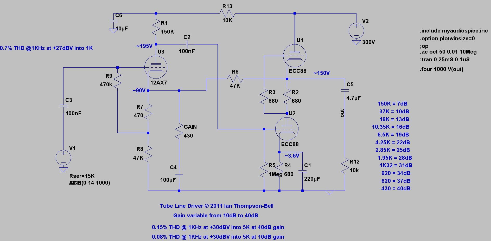

Could you draw a schematic with how apply NFB to reach a gain 25-30

It is a mu follower. What I think is being suggested is that you build a mu follower with a different tube, one with much higher gain so that you can then use NFB to set the gain to 25 to 30dB.
Your question I think was how to add NFB to an SRPP and achieve the same gain?
To do this you need to add another stage of gain because the SRPP on its own does not have enough gain to use NFB AND achieve 25 to 30dB. Here is the circuit of a design of mine that uses an ECC88 (6922) as an SRPP output stage with half of an ECC83 (12AX7) for the extra gain. You can set the gain to any value between 6 and 40dB by altering the GAIN resistor.

Wow Ian, possible is just but I looking for an adaptative gain in a preamp. Do you know the input/output impedance & how much V RMS swing when used with a gain of 25-31?
The input impedance is in excess of 470K. The output impedance is in the region of 150 ohms.
