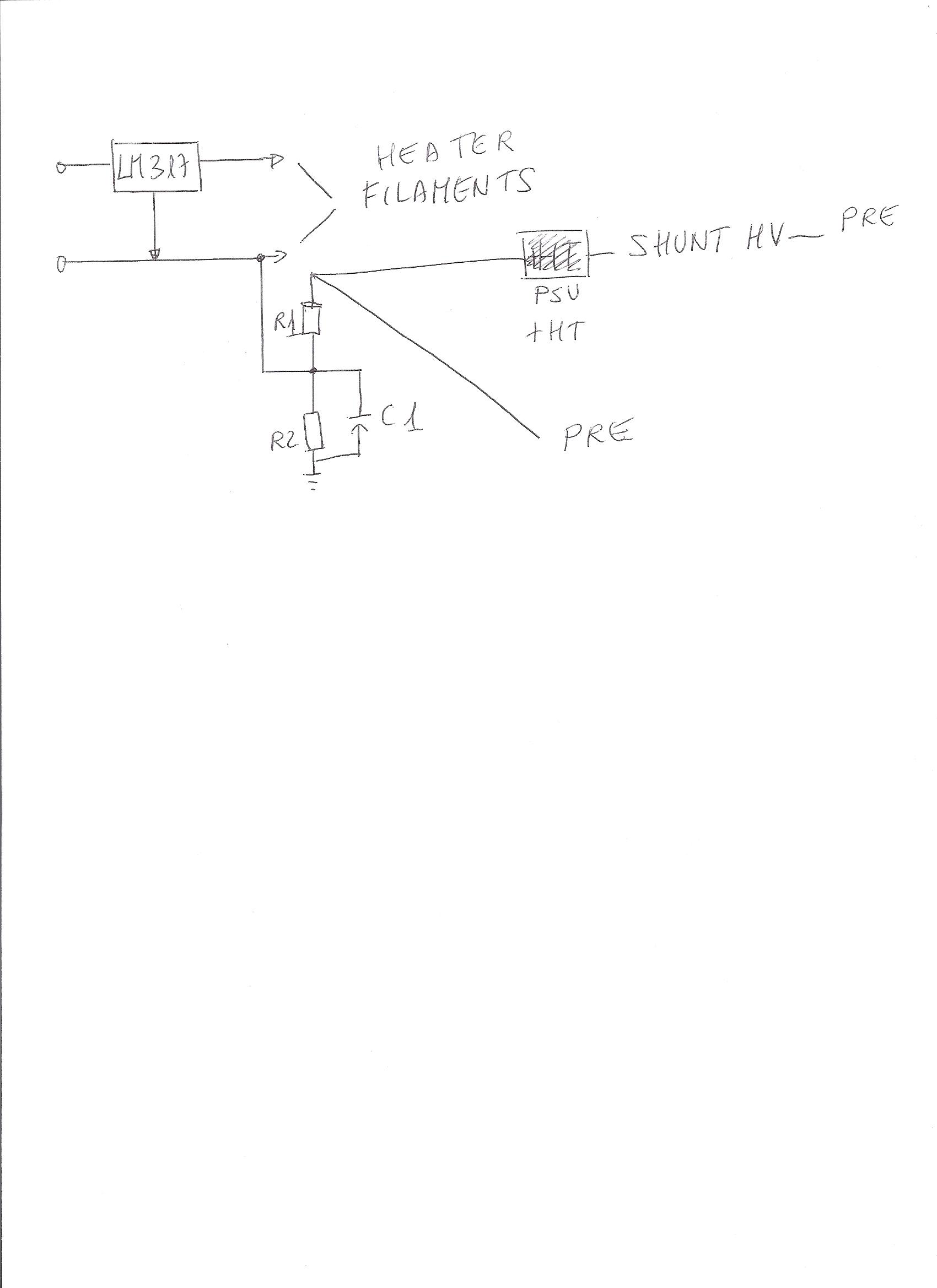

ECC81 exactly as the pic:

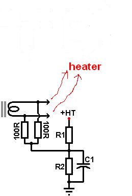

Could you draw the heater elevated schematic.
Thanks in advance for kind help.
Felipe
Will be better if someone can explain my how calculate the heater elevated.
I mind that I know is to calculate a voltage divider to get the needed V from HT
Ian example B+ 250V R1 75K R2 33K = 76.389V
Yes, this is exactly what I meant. You can use an artificial centre tap if you wish but it is not necessary for low gains. For higher gains I would suggest using a dc heater supply.

To HT+ or to HT gnd?

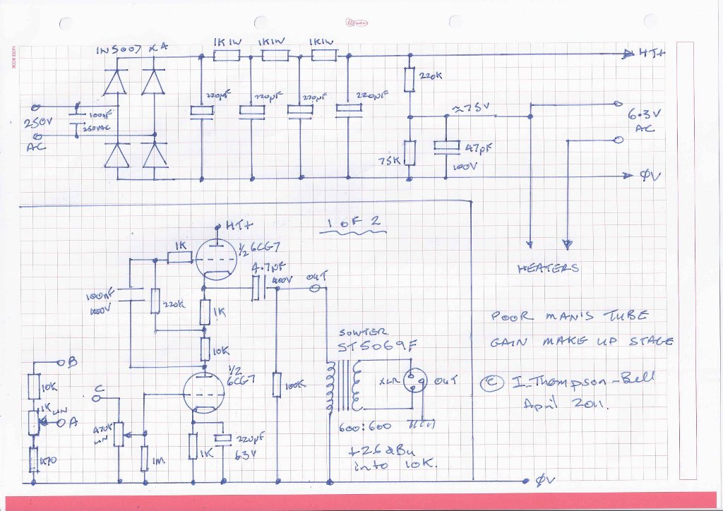

The HT+ is connected to the same HT supply that feeds the top tube anode. All connections should be after regulators. Attached is a schematic of another project that uses a mu follower with an elevated supply.
Thanks for help Ian, so if I use B+ 280V
R1 75K
R2 27K
C1 47uF
I elevate heaters 75V, right?
OK I connect always after regs.🙂
I suppose always connected in the positive rail, right?
Resistors 1/4, 1/2, 1W or more?
Capacitor voltage rated?

The top of the pot divider (R1) goes to the HT+ and the bottom of the pot divider (R2) goes to 0V.
Total dissipation in those two resistors is about 0.77 watts so you should use 1W types.
Since there is about 75V across the capacitor it should be rated at 100V or more.
Cheers
Ian
Thank you Ian, sorry I misread the last schematic about cap voltage value, looking the last schematic is very easy to see how can be wired the elevated heaters (one pic best than 1000 words).
