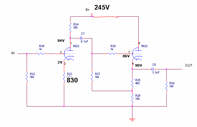

Where is he substituting the LED? for a cathode resistor?
I think yes.
oh oh, Ive seen this schematic before,
and he's driving the 6922 too hard: taking it over its wattage rating.
But others have pointed out that there is nothing really to gain from that, except shortened tube life.
Wich B+ do you recommend?
Do you change something in the schematic (resistors or capacitors values)?

I am in agreement with SY the SRPP is very sensitive to load impedance. Where you take the output of the series arrangement shown will make the circuit no longer SRPP. Move the output to pin number 6. The gain will be ½ the mu of the triode at the operational point of B+/2 for each triode with a cathode resistor of 150R. A gain of ~15 is still way high in my view. Roll in a 12AU7 and see how you like that.
edit: remove the cathode bypass capacitor. This appliciation of series triodes has been around from the early 1940's or late 1930's.

Either don't use an SRPP or optimize the loading- in a very nice article a few years ago, Merlin Blencowe showed that unlike common-cathode voltage amps, an SRPP will show a distortion null at some (relatively low) value of load. As well, the gain is extremely high for a line amp- he'll probably clip his power amp with the volume control barely advanced.
The schematic has a couple of glaring errors (the input impedance and the bias voltage). You could use a larger cap at the expense of overload recovery time. Or you could substitute a cheap red LED to get near-instantaneous overload recovery, some pretty light, and slightly reduced cost.

If there is a way to upgrade the schematic your advice will welcome.
Wich value of pot for volume, I have 100K it's ok?
Try an ECC82 instead of ECC88, change 150 ohm resistors by 1.5Kohm resistors, 0.1uF cap by 1uF cap, 150uF bypass cap may be increased to 470uF without problems, +B=350V (well filtered), 100Kohm pot is OK.

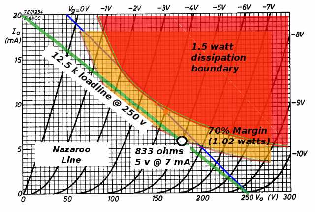

OK this schematic came from here:
DIY 6922 / E88CC Tube preamp
On that page you'll see his loadline for the 6922:
If you plot the Watt Dissipation line over this, you'll see the problem.
The solution is to alter the loadline (by putting a db-pad or volume pot on the output) and also the quiescent-point (idle-current) by adjusting the bias via the cathode resistor, and possibly the voltage.
The 6922 is a great tube, but it is a low-noise fragile signal tube, not meant for this kind of manhandling.
The Dot which represents the idle-spot should be well below the max-dissipation curve.
The voltage swing, which will meander over the line anyway, should never spend more than half its time outside the boundaries.
Although Philips allows 2 watts dissipation / triode,
The Telefunken sets 1.5 watts as the real limit. Obviously we go with the lower rating.
Also, it is generally recommended that your design stay at 70% of max wattage rating for safety and to allow for variation between tubes and brands.

Here's a better loadline and bias0-point for the 6922.
It sits at 70% of the conservative max dissipation (1 watt).
With this bias-point you stay in 70% zone, and tube stays out of trouble most of its life.
The load resistor becomes about 12k5, the cathode resistor is 830 ohms, the bias voltage is -5.
The cathode floats about 150 volts above ground.
The tube coasts in its comfy spot, with very little loss of headroom and great gains in tube longevity.

That's your proposed schematic?
