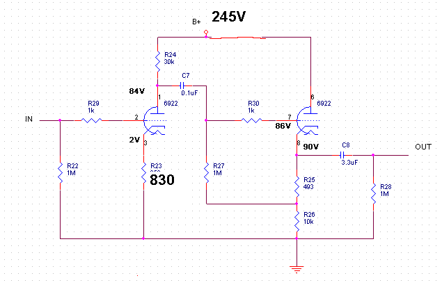

That's your proposed schematic?
No, not mine.
I was just offering to fix it for you.
To me all this stuff is crap.
Pick a Mu-follower.
No, not mine.
Pick a Mu-follower.
I see this Mu-follower link: The Valve Wizard -Mu Follower
Gain 60
Output impedance 267R
That is not a mu-follower, but an active load. For a mu-follower you would need to feed the phase splitter from the upper cathode, not the lower anode.

I disagree. As I said, whether it is an active load stage or a mu-follower depends on where you take the output. Take it from the lower anode and there is no follower action, so it is not a mu-follower.nazaroo said:You're both right.
Joined 2009
I have just checked Morgan Jones. He is ambiguous on this. When he first introduces the circuit he says that output can be taken from either place, but later he says that the output impedance is low (which is only true for the cathode output). I may be the only one marching in step, but I think my definition is correct.
Here The Valve Wizard -Mu Follower says yes.
I used that circuit for my 6CA7 PP amp. Taking the output from the lower triode to drive a cathodyne inverter. Sounds excellent.

That circuit, or the cascode? A mu-follower might not work too well in a wideband amplifier as it maximises the effects of both anode stray capacitance and Miller capacitance.DualTriode said:That circuit (mu-Follower) was used in low noise radio receivers and wide band pulse amplifiers in the Manhattan Project long before it was coined the mu-Follower.
