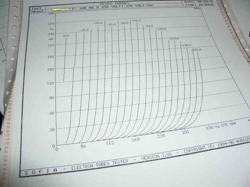

You are absolutely right! Here some of the documentation that Aloia shipped to me, include the small offset infos you are talking about (in yellow color evidence). Please note the data curve of the tubes. They are the data of my tubes, manually selected by himself. I have obscured my name in data curves.
Aloia is not a china reseller, but a serious and professional Master. No mystere or secrets in his works....
P.S. my 6C33 have sounded more then 2.000 hours and they are still in good condition. Kit bought in 1996
