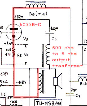

6C33C-B. PP or SE ?
Romy.

rdf said:
Yuck. Most OPT secondary windings have in the range of 0.2 ohms DC resistance. If I read that schematic correctly the design puts roughly 30mV of DC across the speaker best case.
The anode current of the 6C33 is 160mA. There is no DC across the speaker.
45
Your loop is not the correct one.
There is no DC current through the secondary, its two ends are at the same voltage.
The output transformer has no gap for such unbalance and the choice for para-feed operation would questionable. This is not the case, Aloia is an excellent and well established professional designer and not a diy'er....
45
45
As shown in the excerpt the 6C33 anode current appears to return to PS ground through the secondary winding, wired as cathode feedback. Simply saying 'no it doesn't' isn't a rebuttal.
